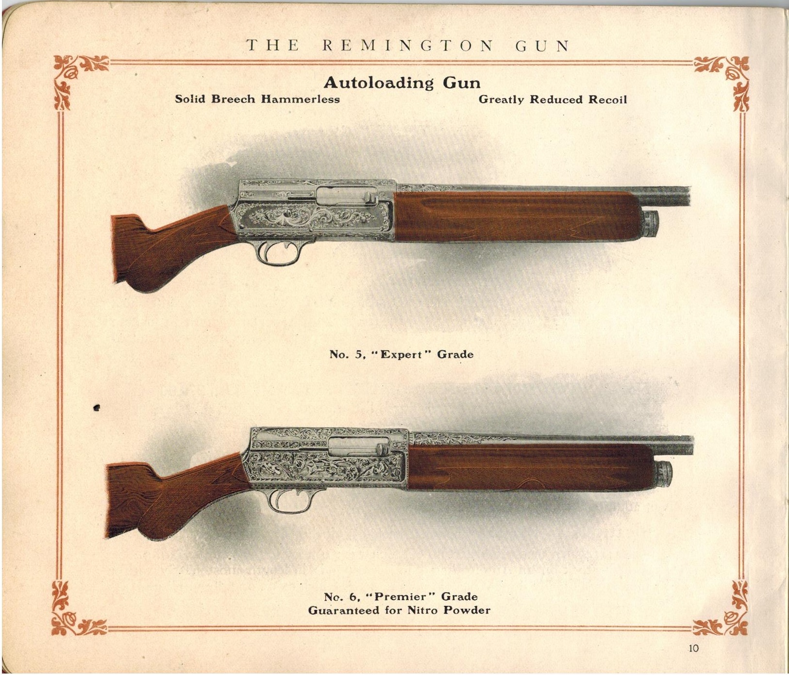

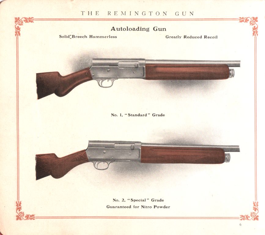

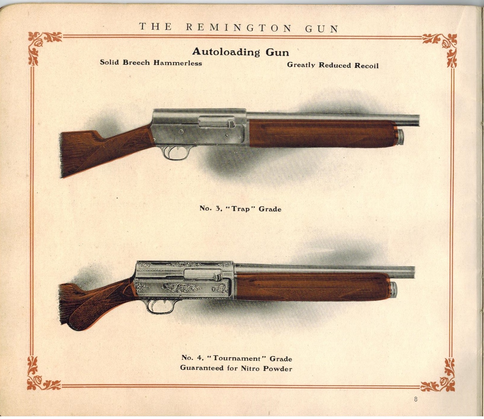

Re: Newly Aquired Model 11
50863 wouldn't be a Model 11. It would be a 1908 vintage Remington Autoloading Shotgun. The company name on the barrel should be Remington Arms Co.
1906 page 6.jpg (68.69 KiB) Viewed 3620 times
1906 page 7.jpg (120.97 KiB) Viewed 3620 times
1906 page 8.jpeg (670.73 KiB) Viewed 3620 times
1906 page 9.jpeg (720.8 KiB) Viewed 3620 times
1906 page 10.jpeg (720.24 KiB) Viewed 3620 times
1906 page 11.jpeg (771.84 KiB) Viewed 3620 times
In 1911, Marcellus Hartley Dodge combined his arms and ammunition companies as Remington Arms - Union Metallic Cartridge Co. an in their 1911-12 catalog they began referring to these John M. Browning designed autoloading shotguns and the Model No. 11.
