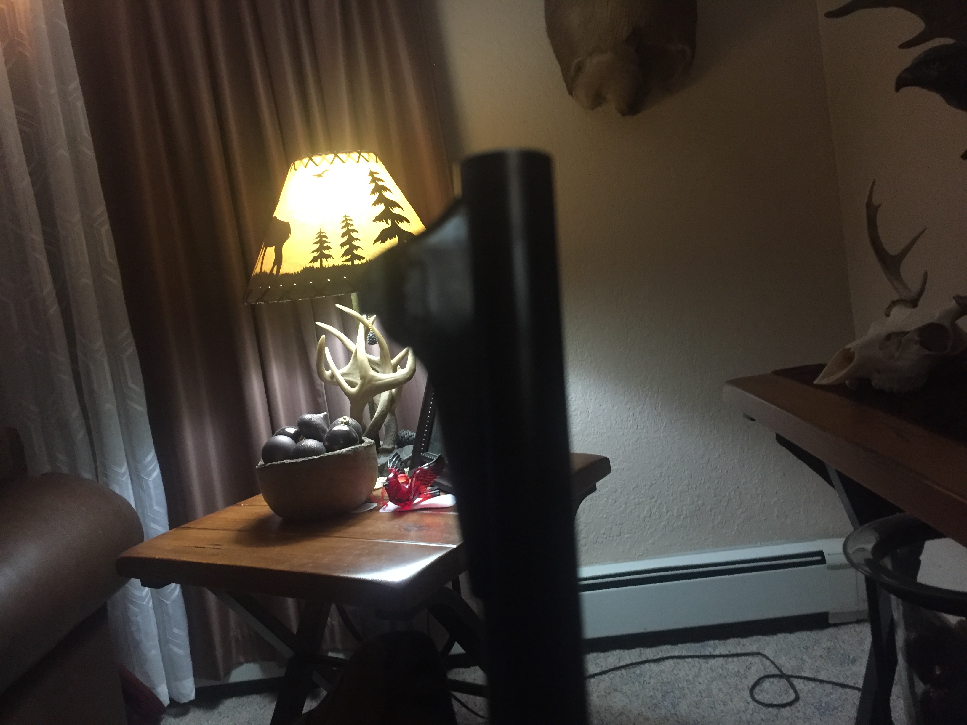

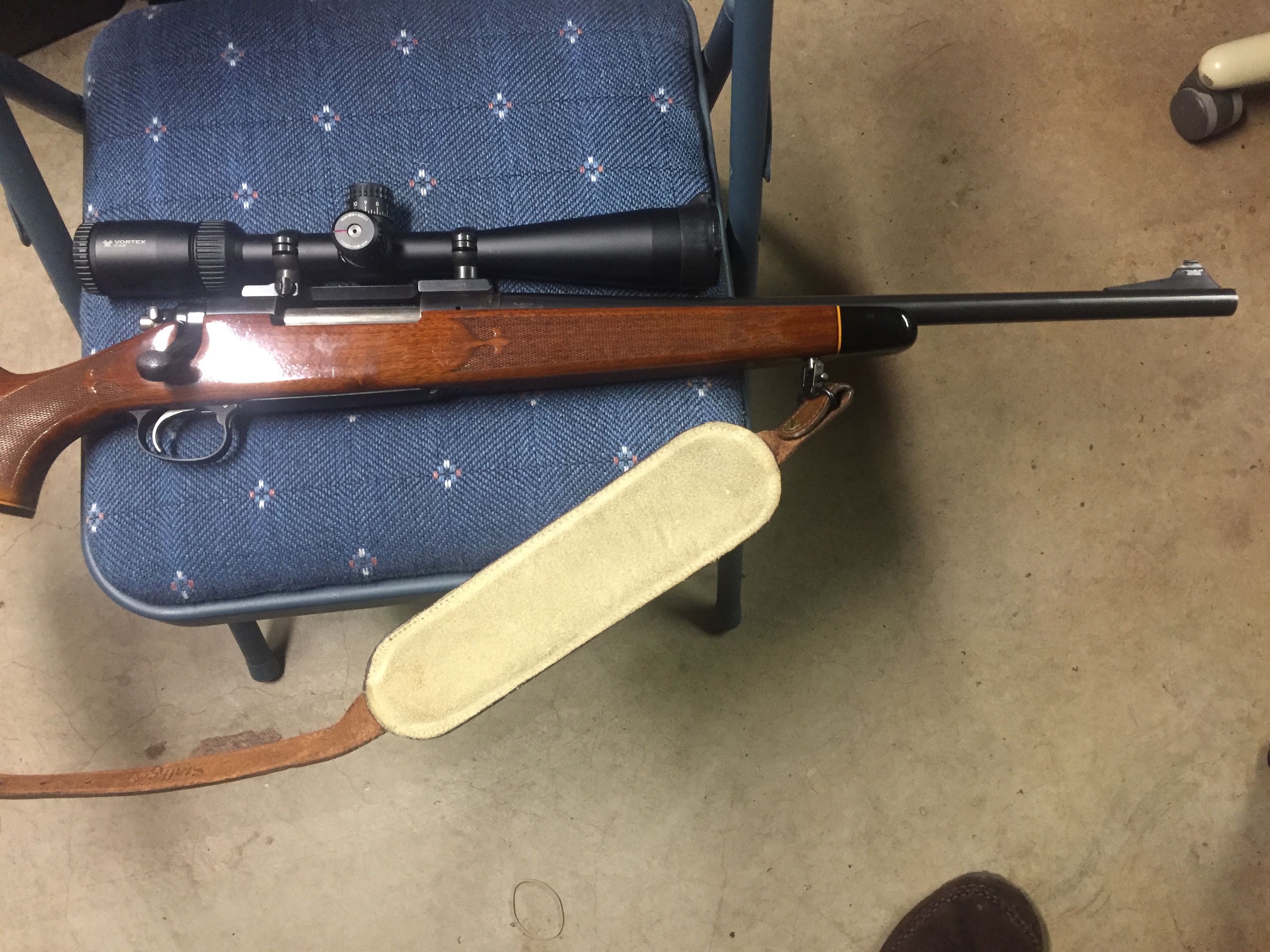

Pics? Would help. Especially the barrel makings and the area around the calibre
Re: Old 700 Carbine?
Not sure if pics will turn out. Under the 7MM Mag it says “stainless steel” No other markings near there except the standard Remington designation and I believe they are patent numbers. Near receiver on left side is 9WP and then right next to receiver is B. On bolt side near receiver is R in a sideways triangle followed by R.E.P. in a rectangle followed by a star.

One more of the muzzle! That may tell a story
Had hard time getting it to focus. Best I could do.
- 32C589FF-AC87-4565-A2EB-559D8F67AA51.jpeg (1.23 MiB) Viewed 7996 times
- A31E72C5-526A-4144-8B2D-2CF871AD1E2B.jpeg (1.13 MiB) Viewed 7996 times
- 6286FAE7-508B-44D0-9F3C-C6F91B76AE29.jpeg (1.09 MiB) Viewed 7996 times
Well, it is an oddity. Sure looks factory. The bluing would be next to impossible to match at the muzzle if cut due to the process used. Comparing the serial number to the date of assembly may lead me to believe that someone in the factory had this "custom" assembled for themselves. They are about 2 months out of sequence, which, on its own is not out of character, but in thus case I believe my thought could be correct. Not sure I'd want a 7mag with that short of barrel but someone mite.
