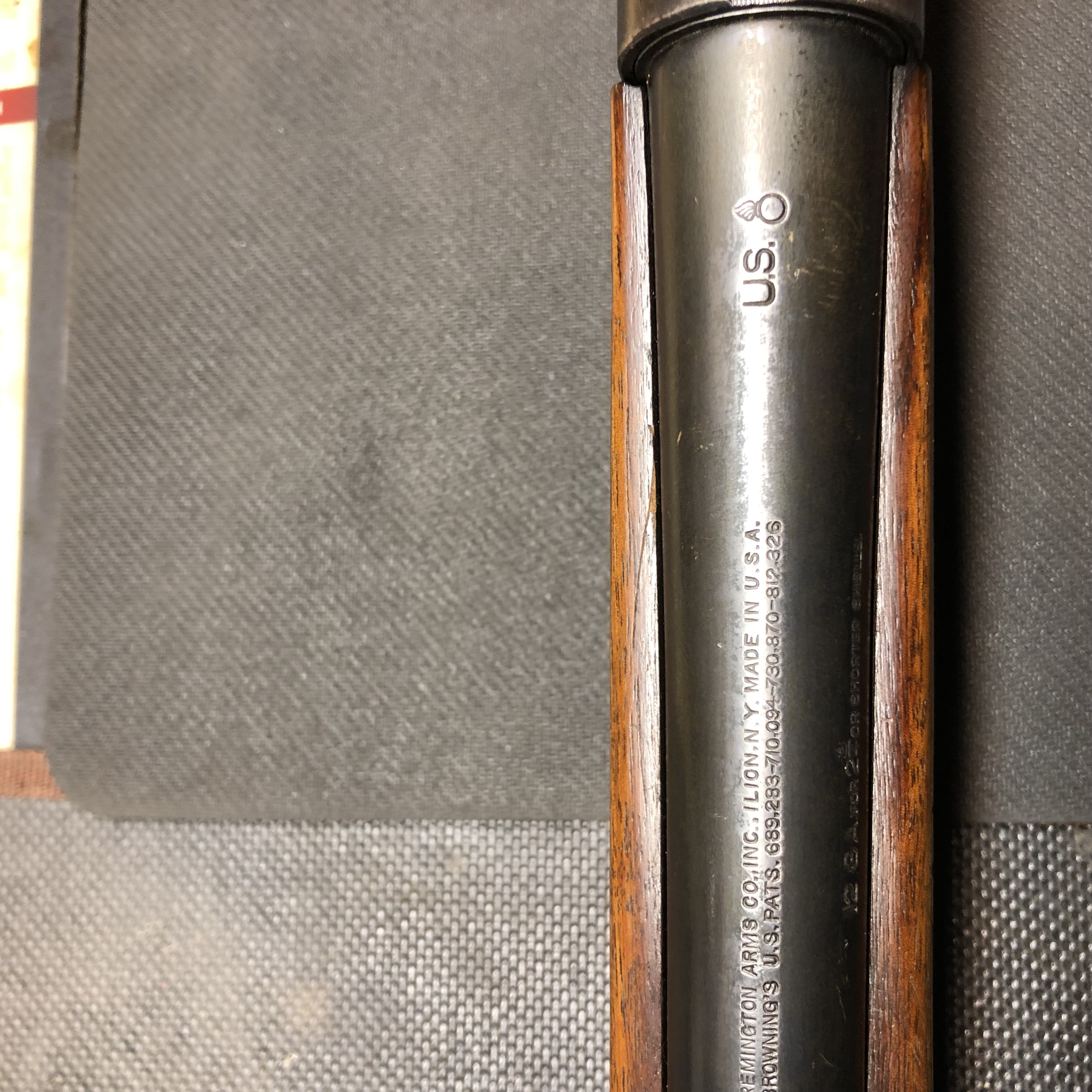

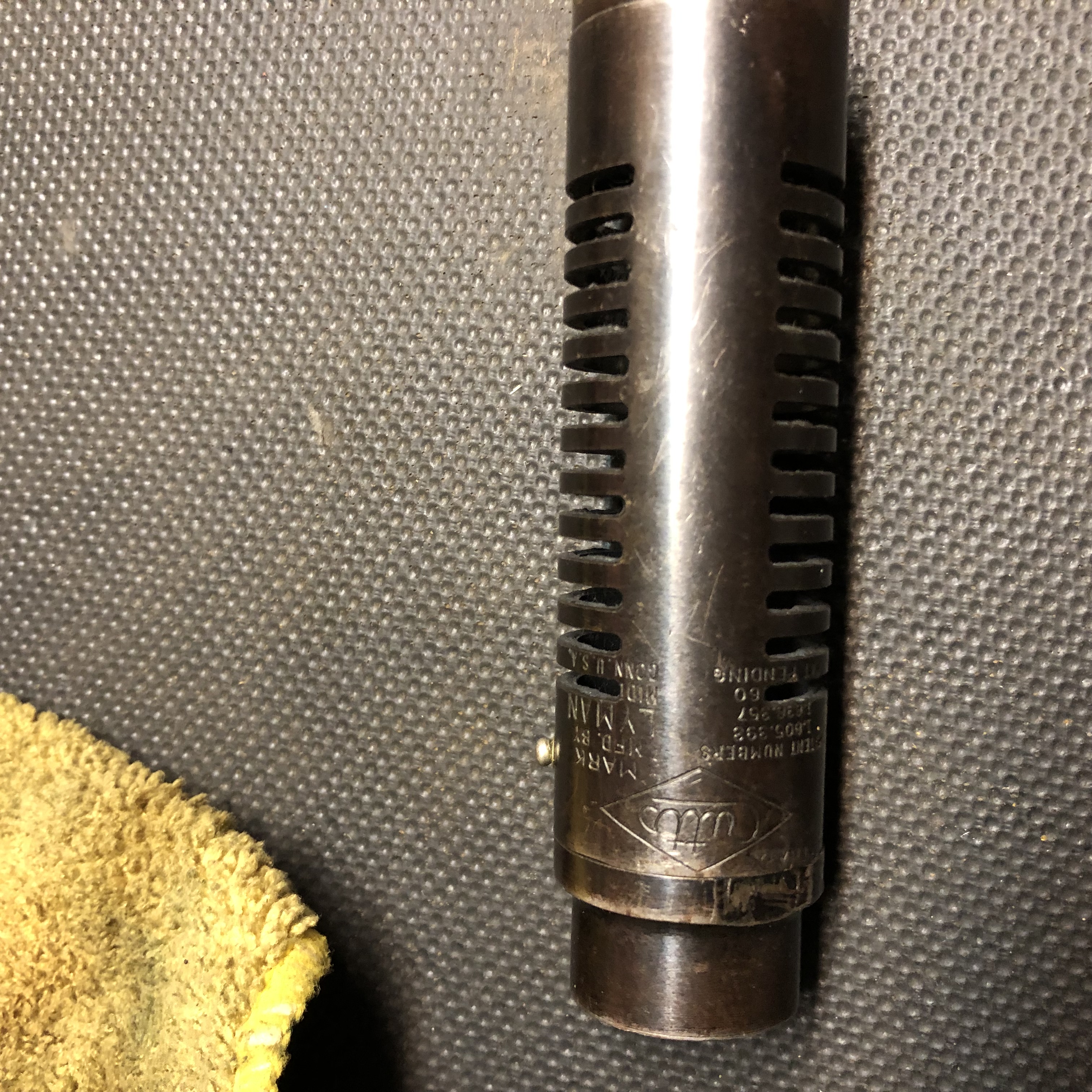

Hello, I am new to the group and I recently acquired a Model 11, 12 GA semi automatic. The shotgun was well taken care of. It has a "US" and a bomb insignia then "Military Finish" on the top left side. It also has a Cutts flash suppressor. The story behind this shotgun is that it was used in the Vietnam War. Serial Number is on the left bottom side 479247. Can anyone give me some information based on the serial number? When was it manufactured and if in fact it could of been used in the Vietnam War. The previous owner was a career 30 year Marine who did seven tours in Vietnam. Yes, seven tours!
Re: Remington Mod.11 question
The Model 11 receiver with serial number 479247 was put in work between June 30, 1942, (469363) and Aug 1, 1943, when the reached 499999. They then jumped serial numbers to 700000 and continued. With the Cutts Compensator with a spreader tube it was much more likely used as a skeet gun during WW-II as part of the training of aerial gunners. Is there a choke marking on the left side of the barrel?

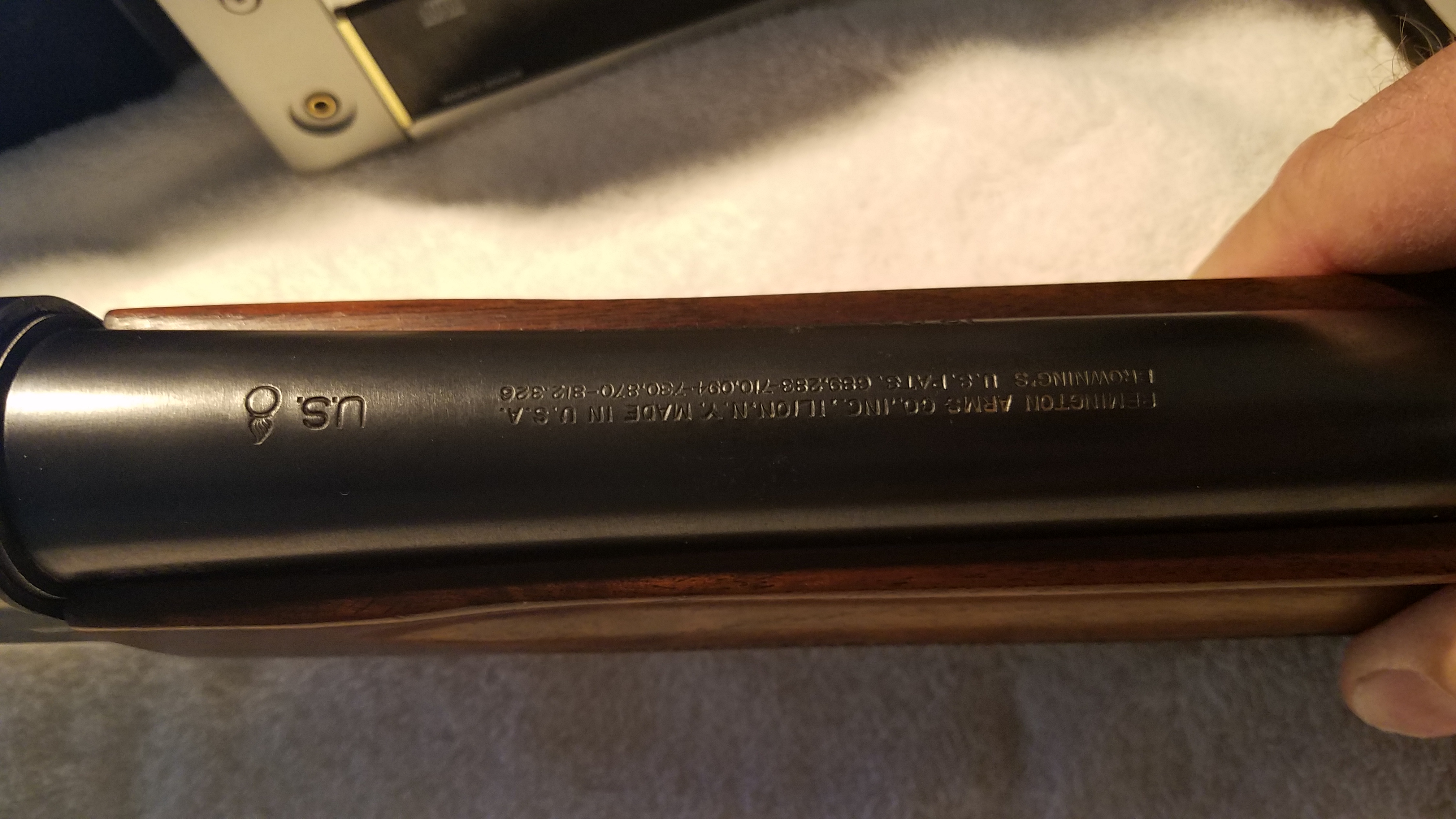

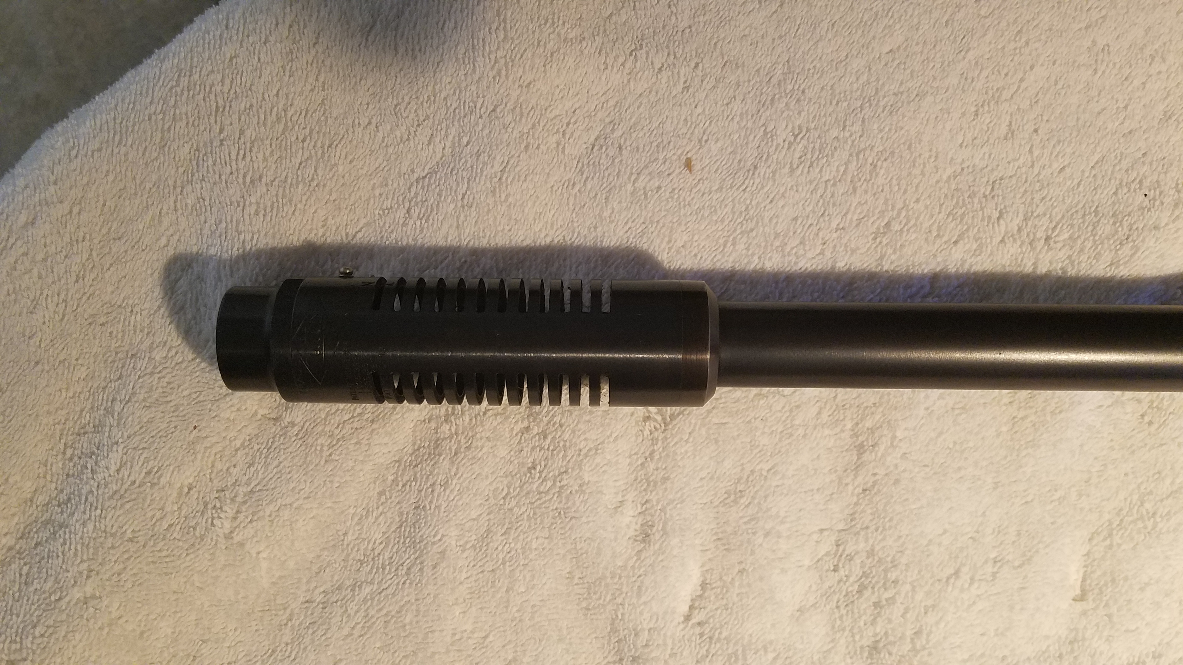

Here are some pictures of my 1943 sportsman configured and marked in the same way serial number #710622

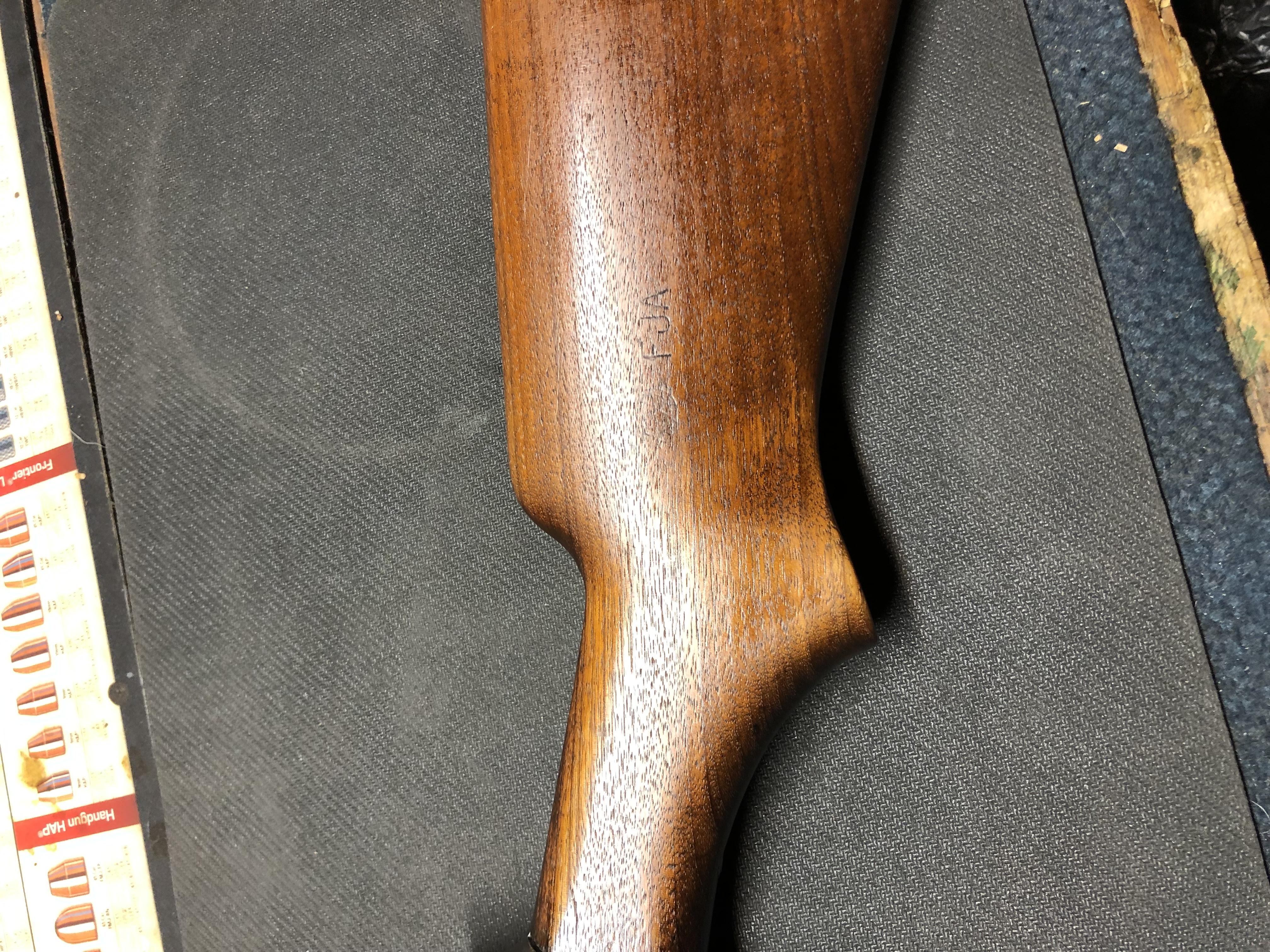

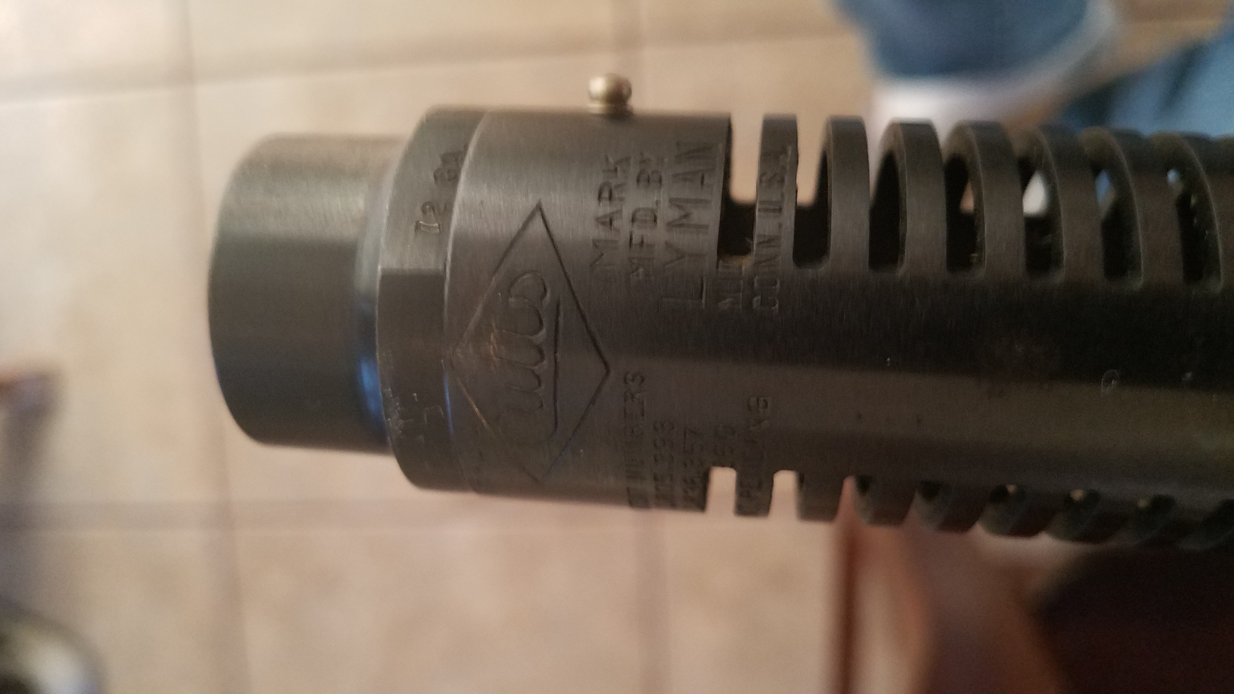

Here are a few more. Note the cartouches on the stock.

Sorry not sure why I came out upside down. The FJA stamp is present.
