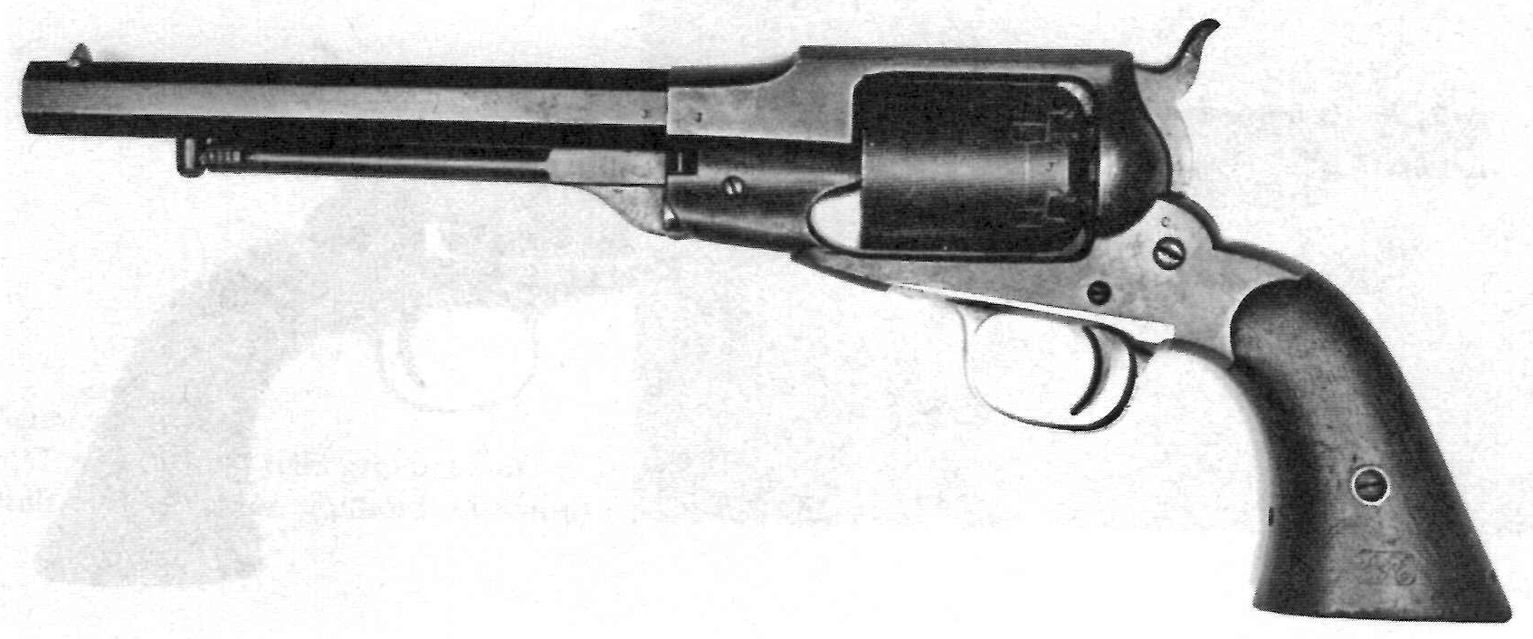

Hi Orent,
If you post a picture or two, we can better identify the gun you have. The serial number will determine the made date.
There are basically just two models of the Beals revolver. The first model has only one finger grip on the cylinder pin. Only 200 were made. Because of the single finger grip, collectors call them “single wing” revolvers.
[img][attachment=0]Beals Navy.jpg[/attachment] [/img]
The pic is of a Navy Beals copied from p.40 of Don Ware’s book.
Several design changes were made, and production continued with the second version. The easiest way to tell a Beals by look, is that part of the loading lever has flat sides, and a shape unique to the Beals.
The best book on the large frame Remington percussion revolvers is “Remington Army and Navy Revolvers 1861-1888,” by Don Ware.
For a mainspring, you can check Dixie Gun Works, they should have a spring.
