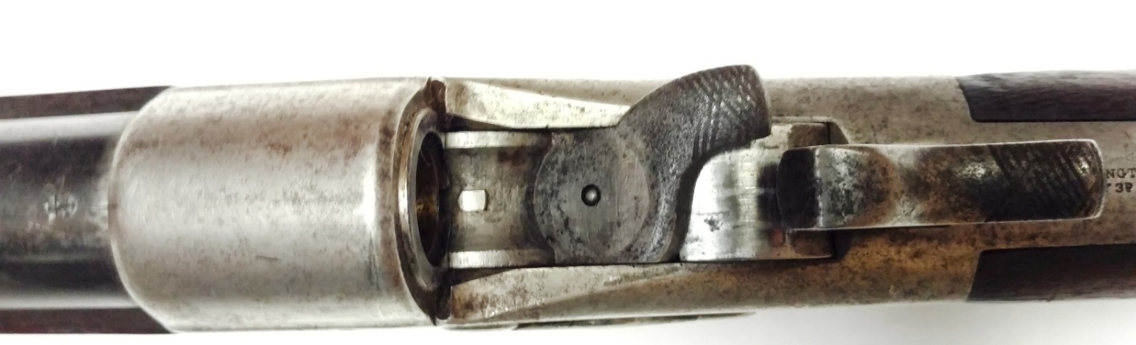

Here is a photo showing the stud extractor on the breech block on a 1867 Navy carbine.
photo 5 - Copy.jpg (184.75 KiB) Viewed 9606 times
Have a Good Day,
Matt

Good pic . thanks.
I wonder if its because those cases are a big diameter, hence the concave BB.
Milling a slot in the barrel for a sliding extractor might weaken it by getting to close to the wall.
The case head is close to the concave so makes the stud extractor easy to fit.
As cases got smaller , the heads were further from the BB so making the stud inefficient as an extractor.
Cases were smaller so more meat in the barrel to cut the slot for the extractor.
No need for a concave any more so BB,s became flat as easier to machine.
I have not seen any flat breech blocks with a stud extractor.
