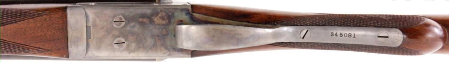

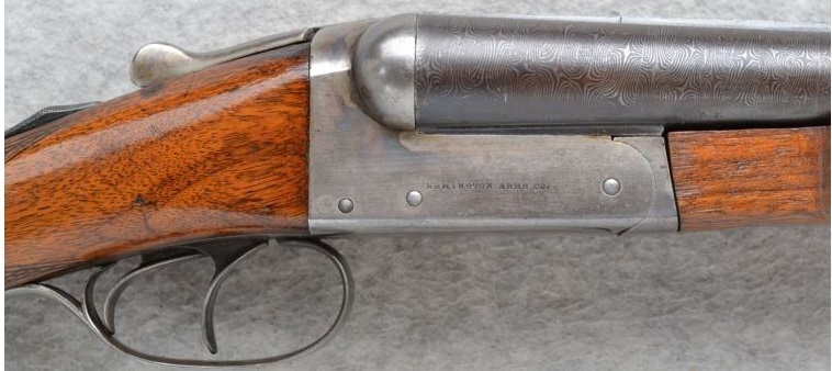

345081 is pure early style --
345081 01 12-gauge 30-inch.jpg (77.34 KiB) Viewed 3147 times
345081 02.jpg (149.56 KiB) Viewed 3147 times

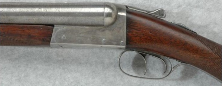

348604 is all early style, except it ha gotten the one-screw trigger guard --
348604 03 Early KED-Grade bottom.jpg (32.77 KiB) Viewed 3147 times
348604 01 Early KED-Grade left side.jpg (55.92 KiB) Viewed 3147 times

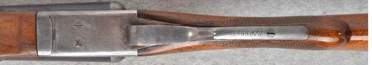

Q355073 is similar to the gun in the article, with the plugged sear pin hole --
Q355073 01 12-gauge 30-inch.jpg (35.97 KiB) Viewed 3147 times
