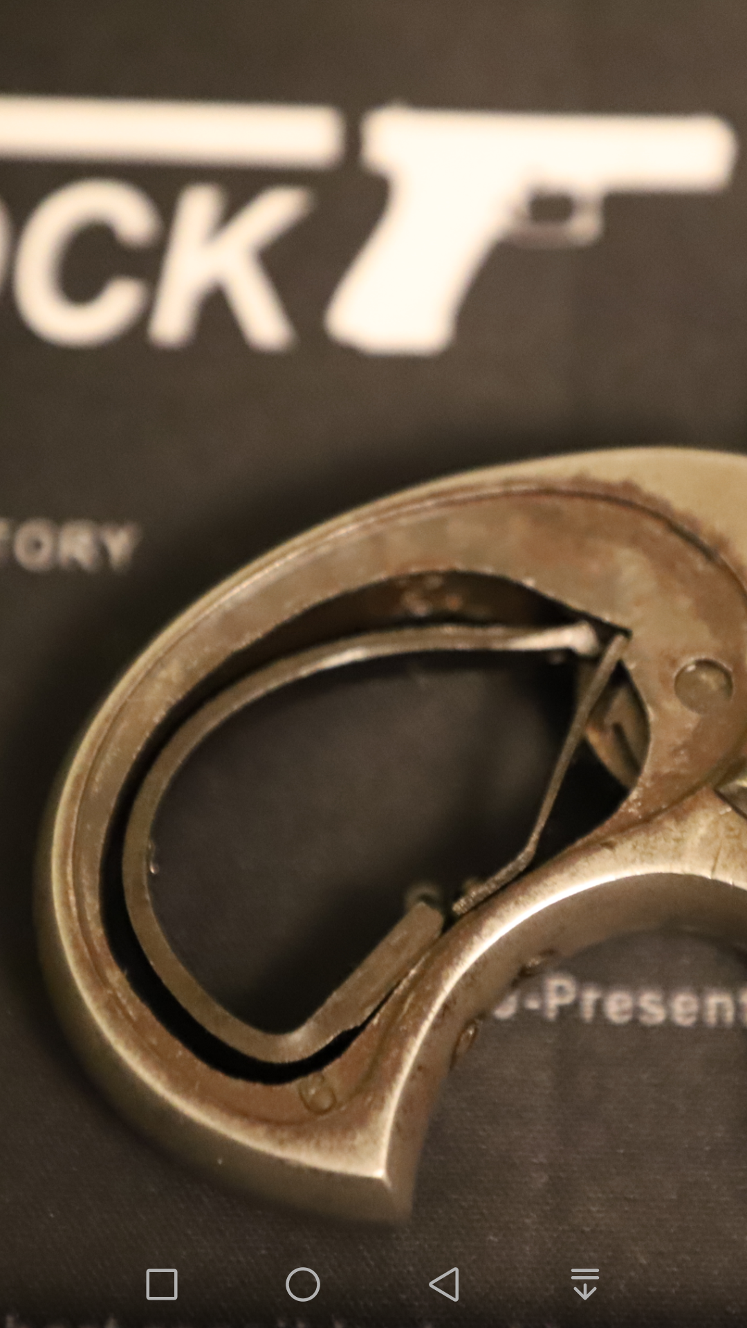

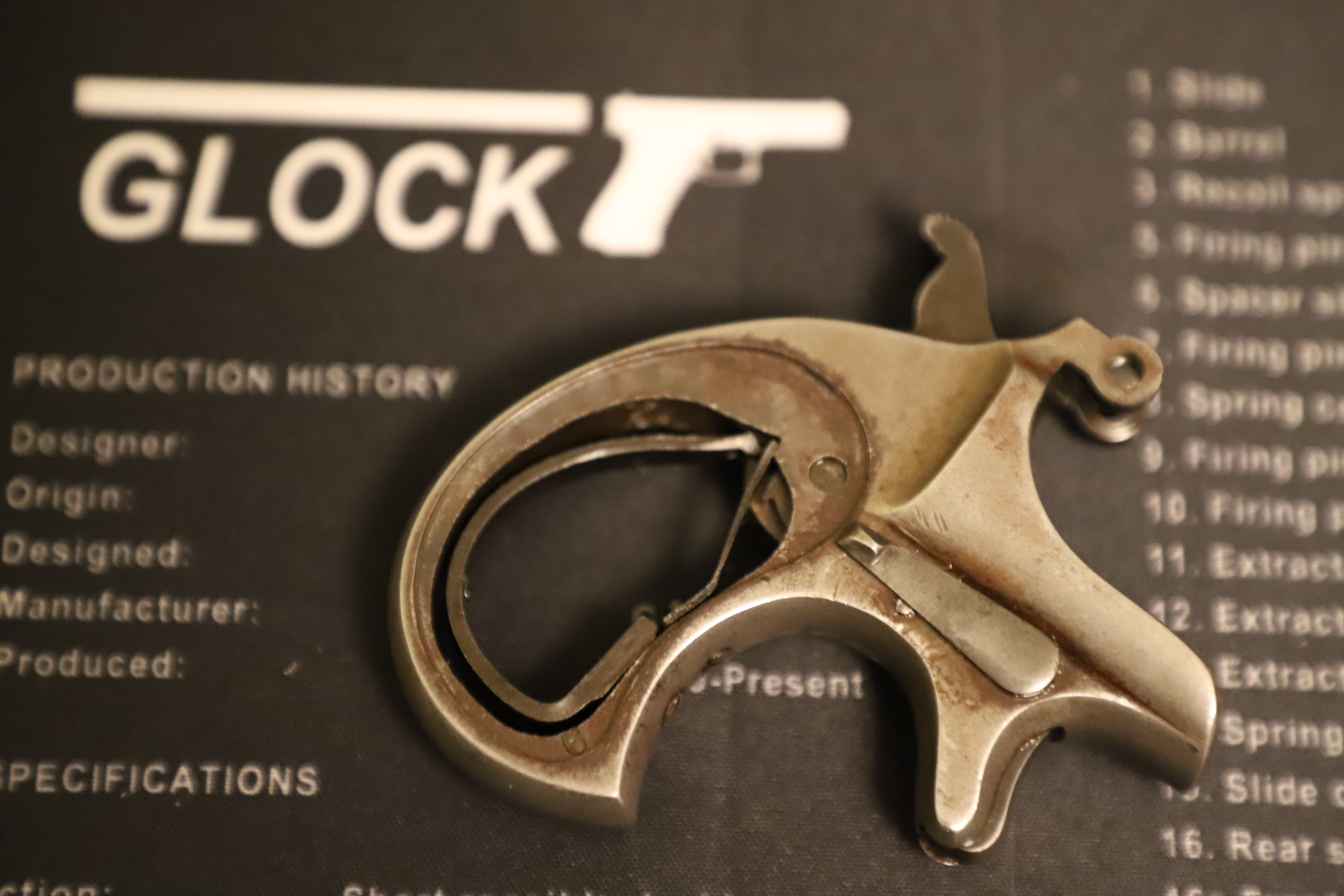

The reason i've been tempted to take it apart is that I think the firing pin/striker strikes too low on the upper barrel. Of course it might just be wear on the part due to high age of the mechanism. I think I understand how it alternates the point of striker impact and it would be fun to see that cross looking part.
Photo of lower a upper cycle below.

Looking at your pic, and at one of my DDs, I'd say that the vertical pin position is correct. There isn't a lot of difference from the top and bottom positions. But from your pic, the pin looks like it doesn't protrude far enough for a good primer strike. Checked 2 guns and both pin protrude .055" or .14mm.

That photo angle makes it look so but infact it protrudes on both cycles about 1.55mm or 1/16".ImageImage
