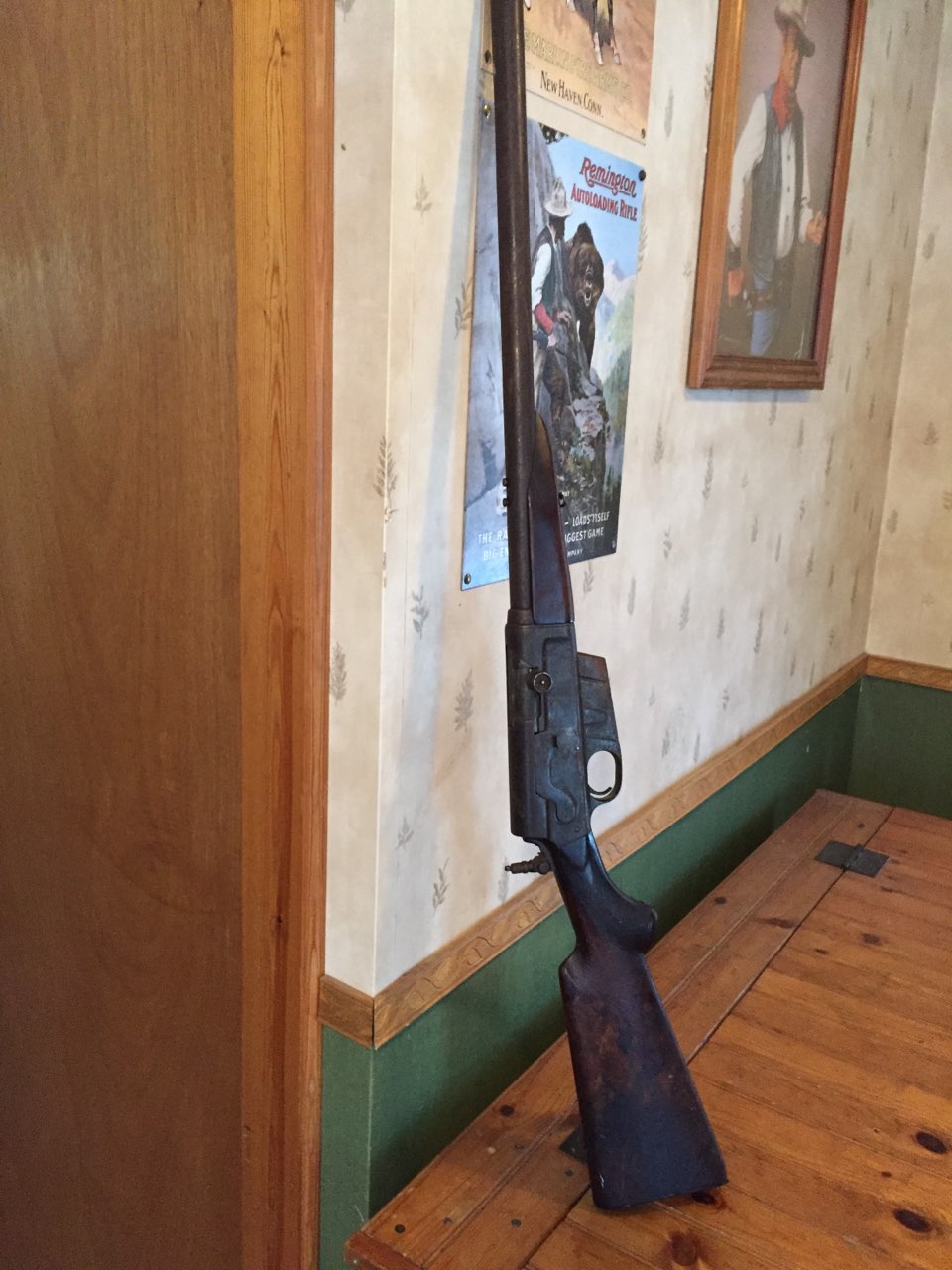

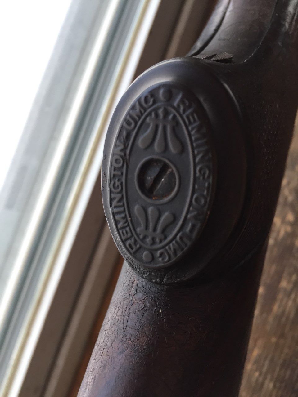

I researched through the ( Great Model 8's ) and found the answers. Its an 8 with a pistol grip stock,checkered and a pistol grip cap. I'm in the process of restoring it. can show the before.
there is no designation on the receiver. no barrel codes..just a serial number on the under side dating it next to last rifle produced in 1920. Under the barrel crust there is a model 8 and the usual roll mark. also remington roll mark on the top tang.

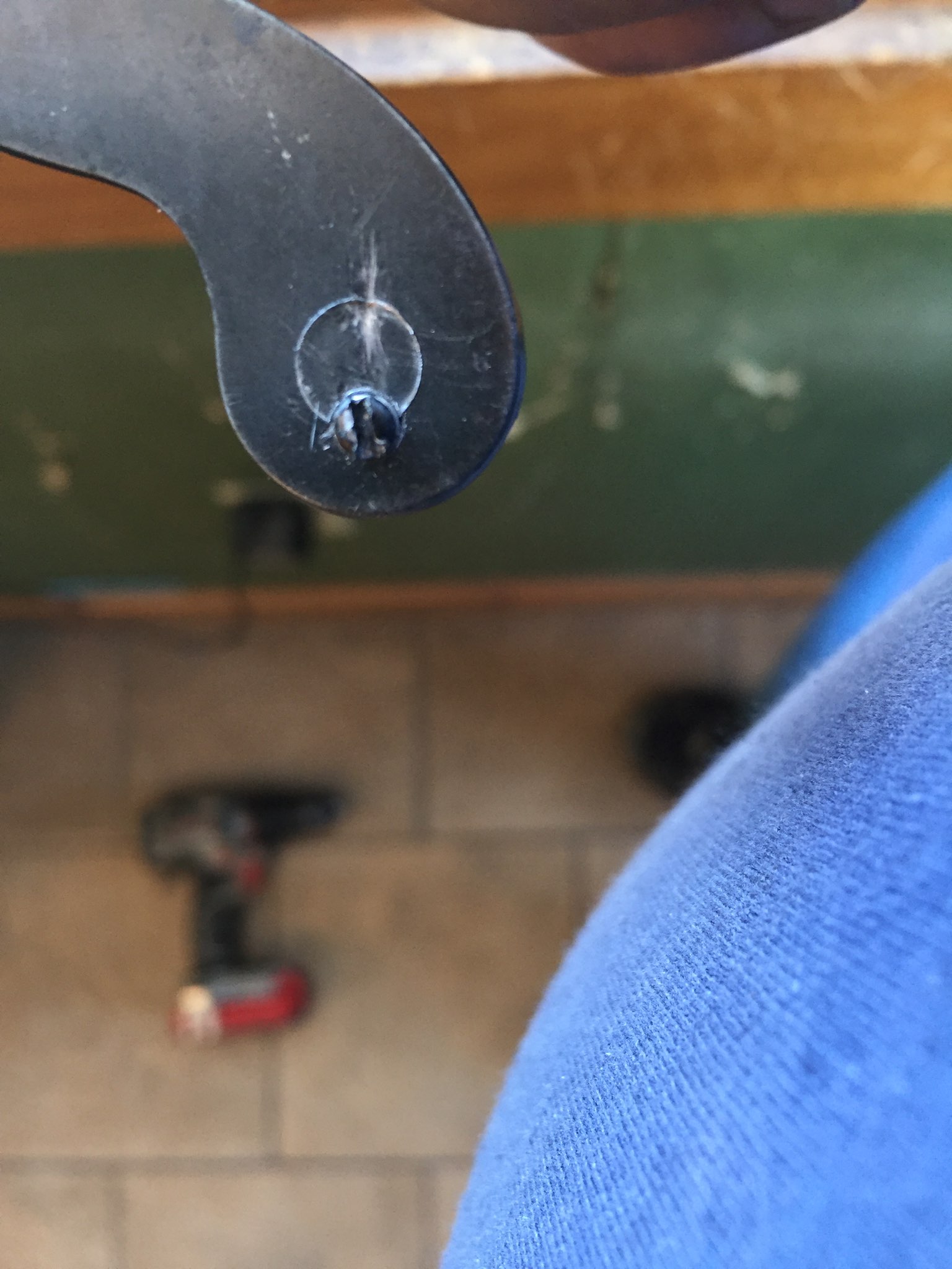

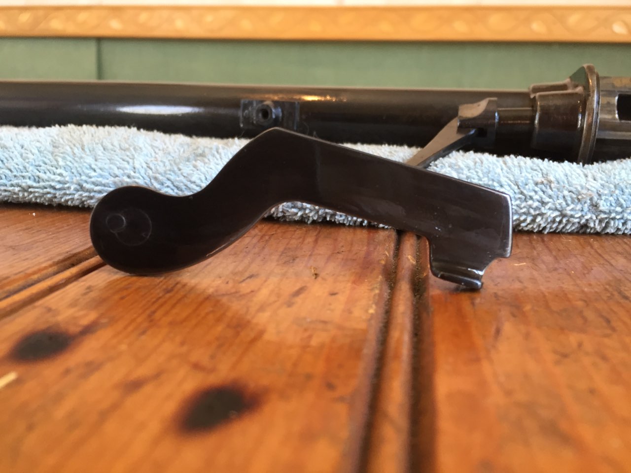

Solid fix to the safety, drilled and tapped with a steel filler plug. Filed and re blued.

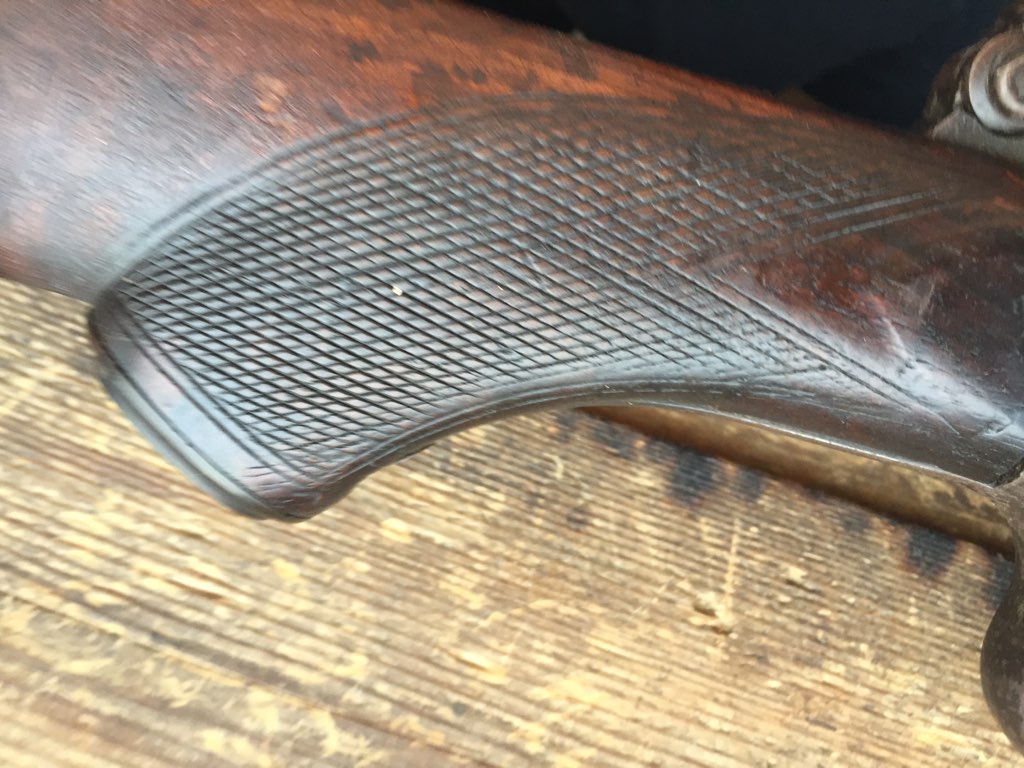

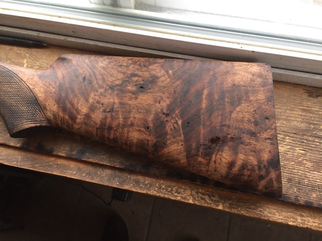

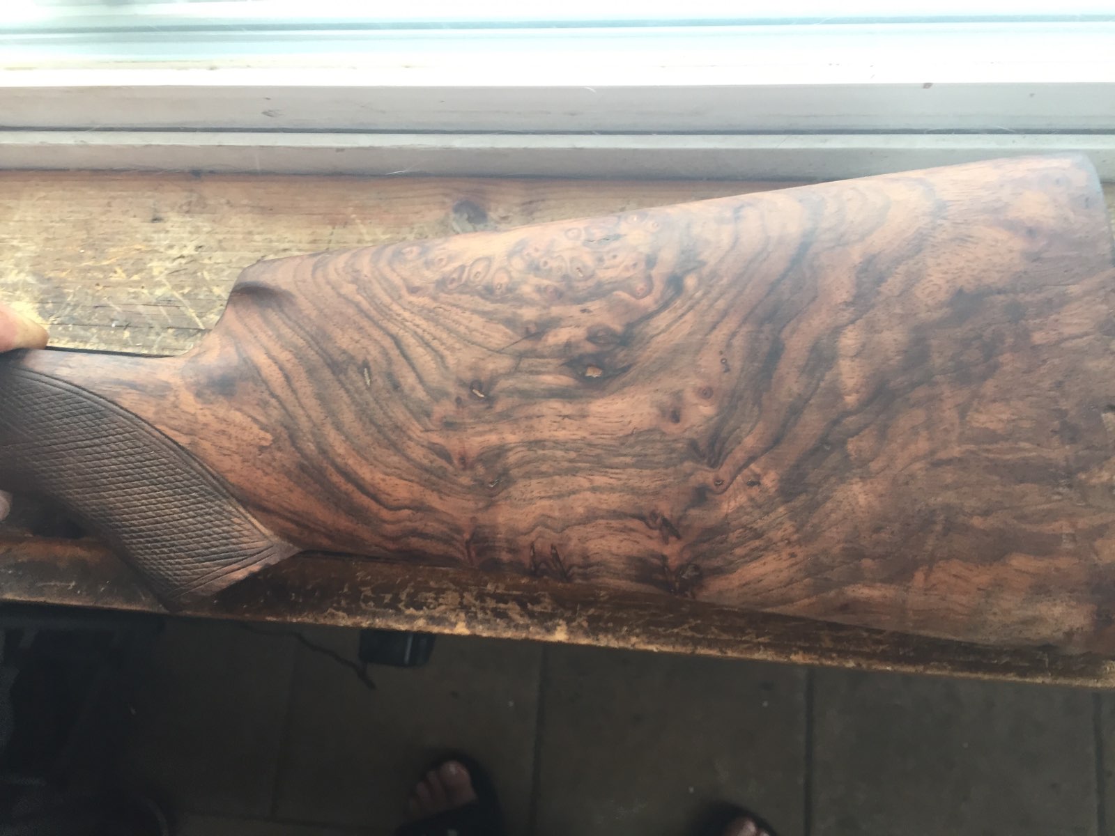

The stripped stock displays exceptional figuring, with checkering and pistol grip cap. I cant help but think its an above standard grade. Today you never get walnut like this on an off the rack rifle.

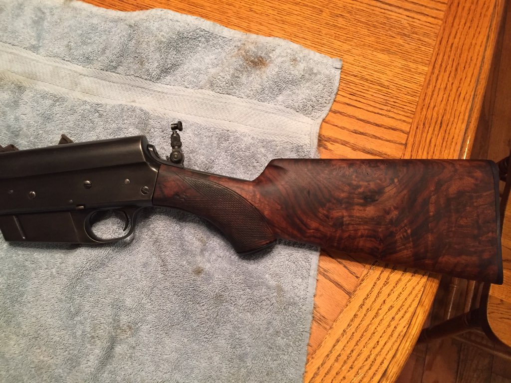

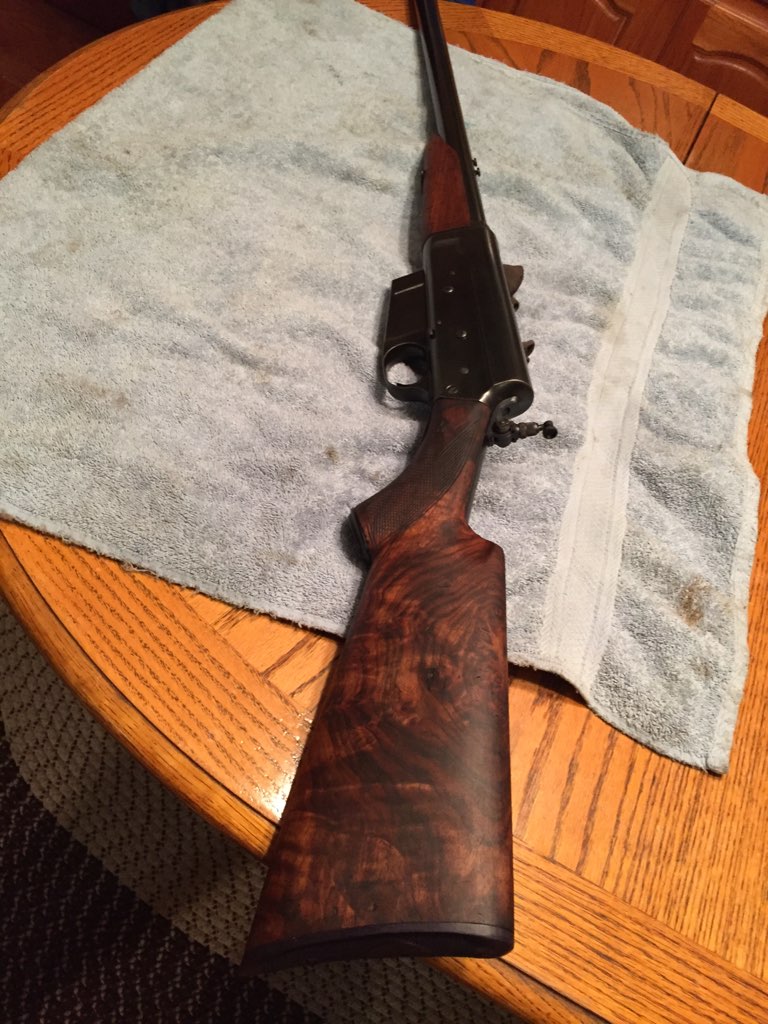

finished rifle, restoration less than $20. Time 20 hrs of enjoyment! Thanks for following!
