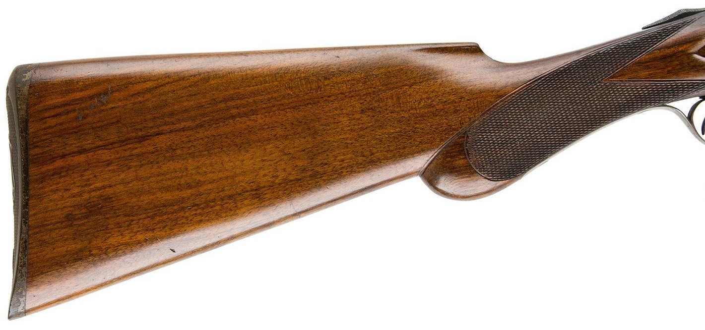

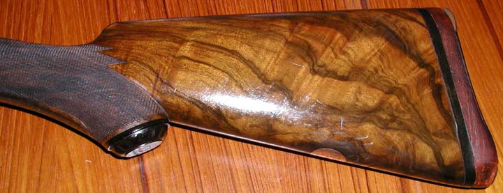

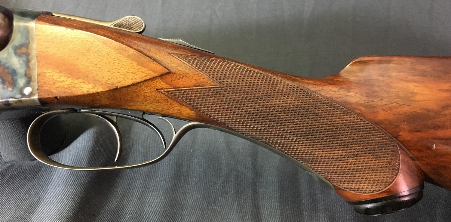

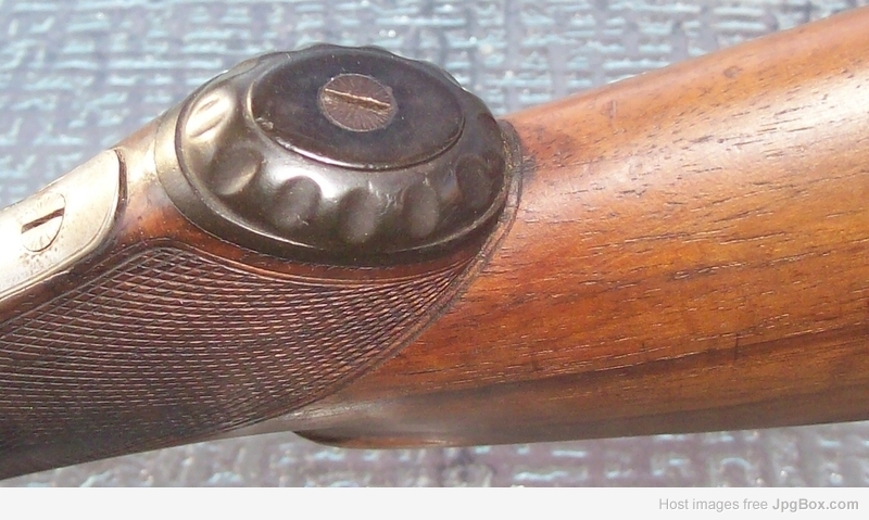

Re: 1894 SXS Questions
The difference between a half-pistol and full-pistol grip on a Remington Hammerless Double is essentially the presence of a grip cap.
125000 09.jpg (273.52 KiB) Viewed 8973 times
P132280 08 16-ga DEO-Grade stock left 8x10.jpg (58 KiB) Viewed 8973 times
Though sometimes it looks like a grip cap put on a half-pistol grip.
107252 05.jpg (443.55 KiB) Viewed 8973 times

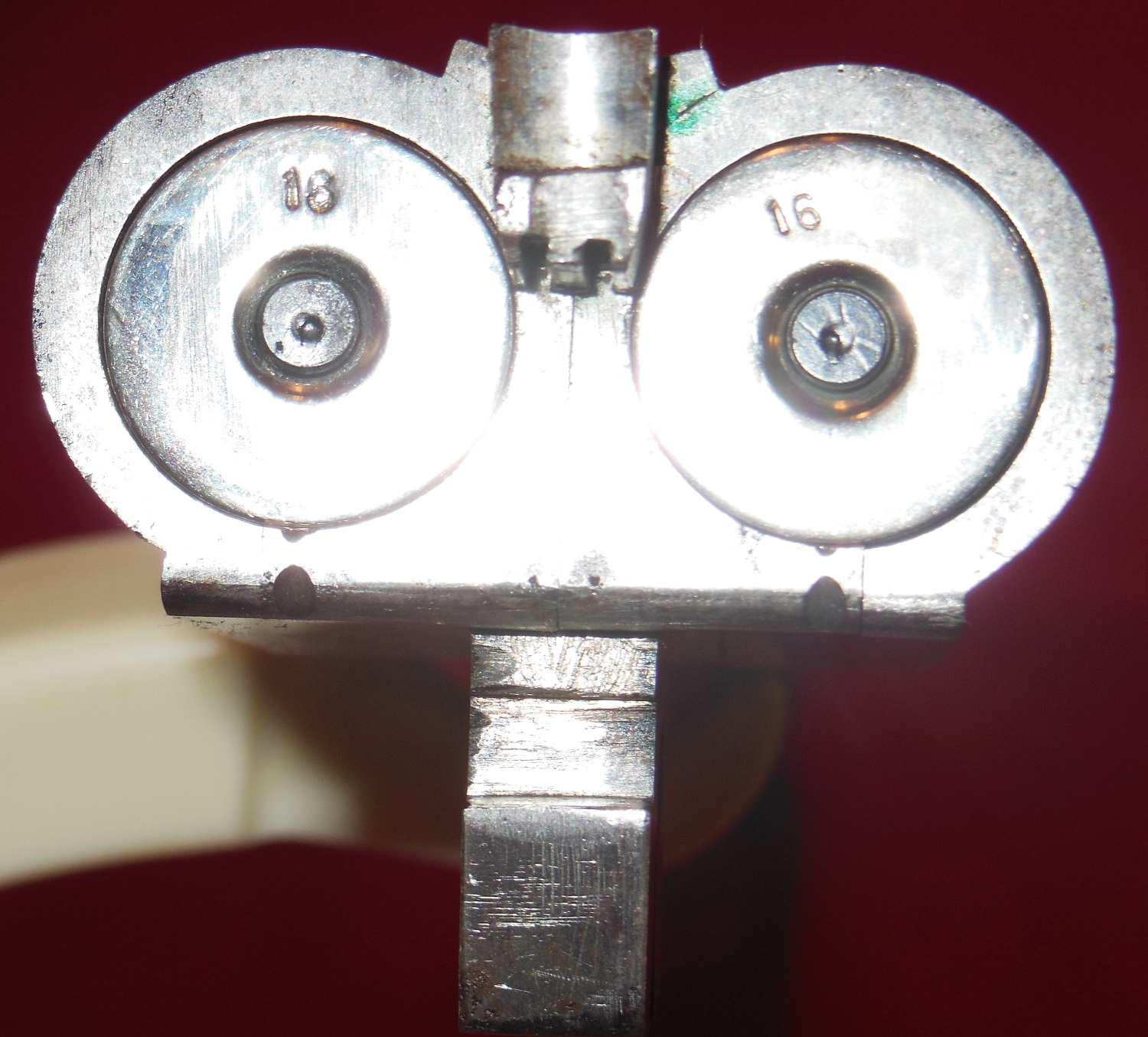

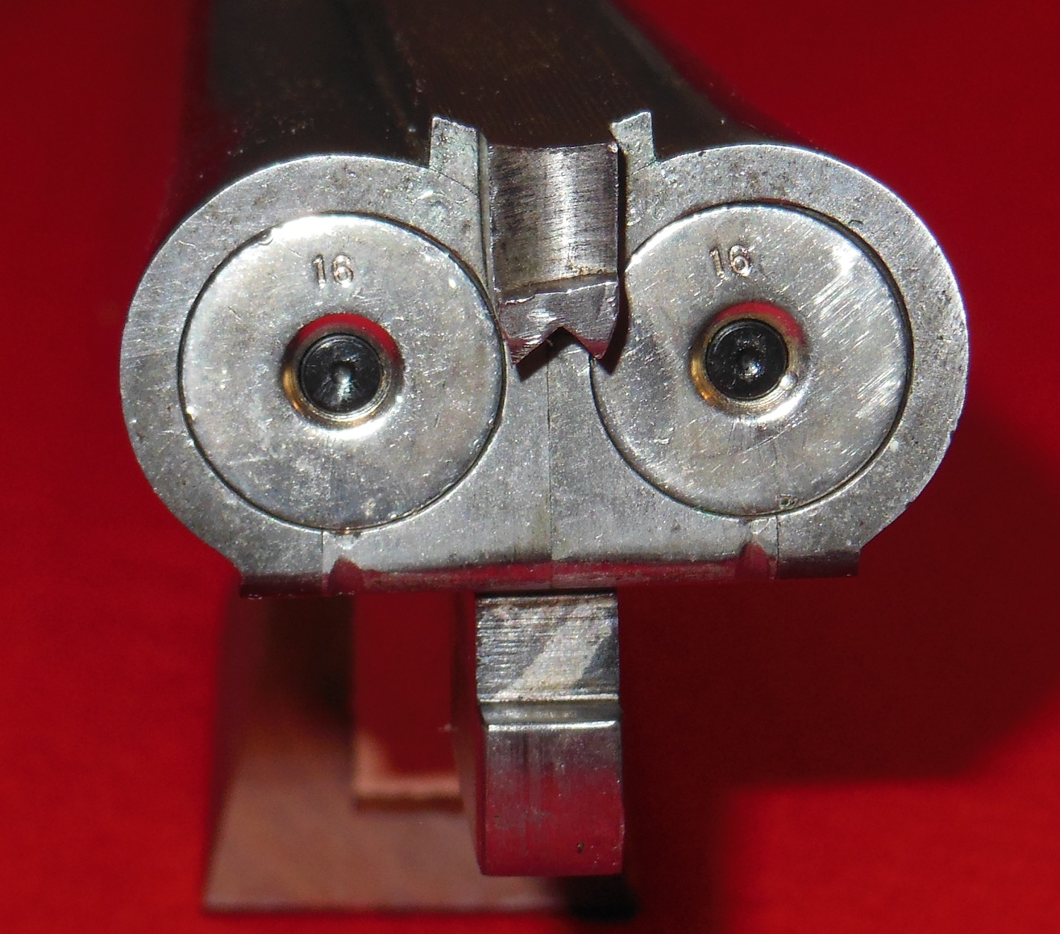

My two 16-gauge guns are both ejector guns, on the late style action, both with 28-inch barrels, both weigh within a fraction of an ounce of seven pounds. The DEO-grade has the two groves style ejector guide --
P132280 15.JPG (515.68 KiB) Viewed 8869 times
and the KE-grade has the single V-groove.
Q380786 01 KE-Grade 16-Gauge.JPG (571.7 KiB) Viewed 8869 times
