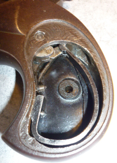

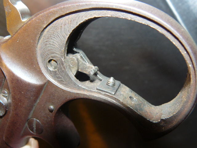

Hello and greetings from France. My old Remington Double Derringer .41 RF is missing its main spring. I have unsuccessfully tried to find spares in France. Could anybody help me finding one main spring in the US? Thanks a lot.

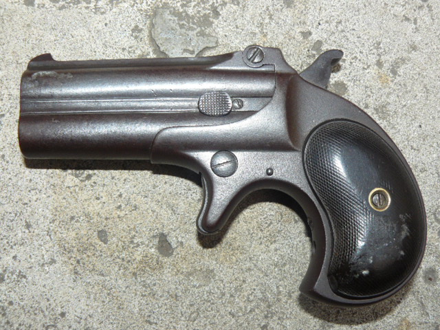

Hi there, I finally got an original mainspring thanks to this forum (and a special thank to Wildwest Thierry and David!!). It was a bit difficult to install it - One must know that there is a risk to break the spring.
I'll try to paste a photo of the pistol that is now complete.
Cheers, Lars
Cheers, Lars
