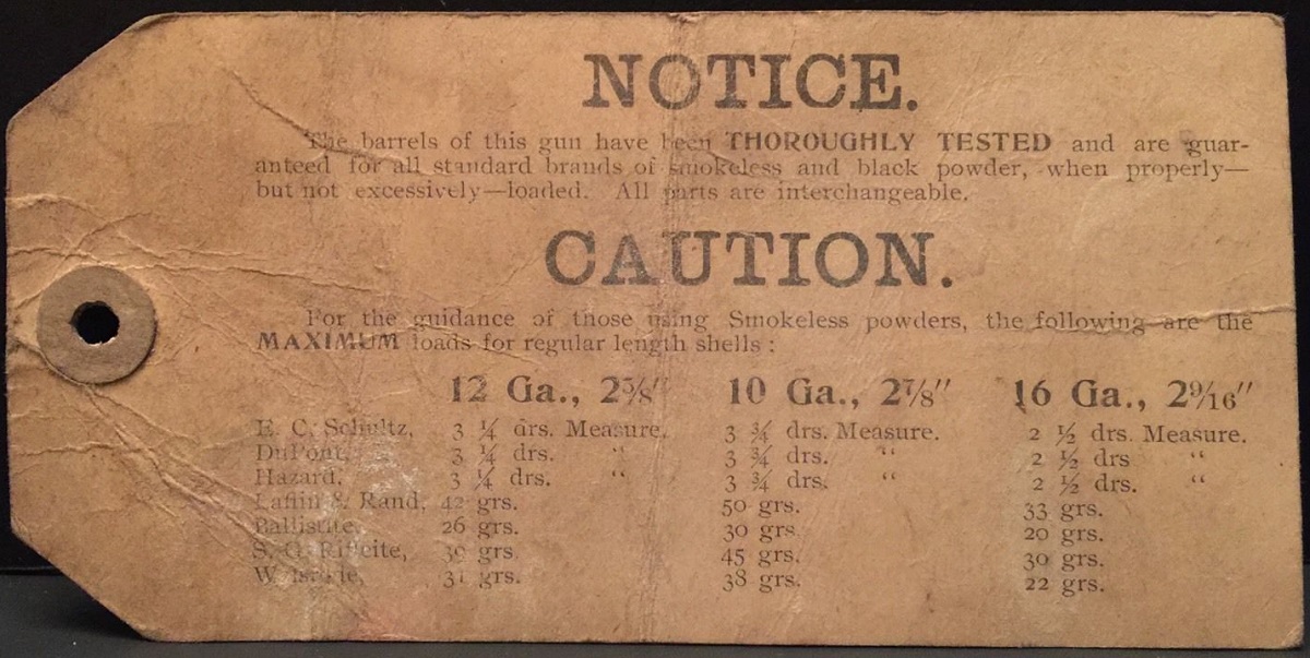

Remember, the 2 7/8 inch 10-gauge shells of the time frame that Remington Arms Co. was building the Model 1889, were not the "Super-Ten" with 4 3/4 drams equiv. of progressive burning smokeless powder pushing 1 5/8 ounce of shot at high velocity. That load was introduced in 1926. The heaviest payload 10-gauge factory loaded shells offered during the time frame the Model 1889 was offered was 1 1/4 ounce of shot, pushed by black powder, bulk smokeless powder (drams) or dense smokeless powder (grains). Here are the powder charge recommendations from the back of a 1902 vintage Model 1889 hang-tag --

Thanks Researcher - very interesting hang tag.
I will only be using very light black powder loads for sure.
