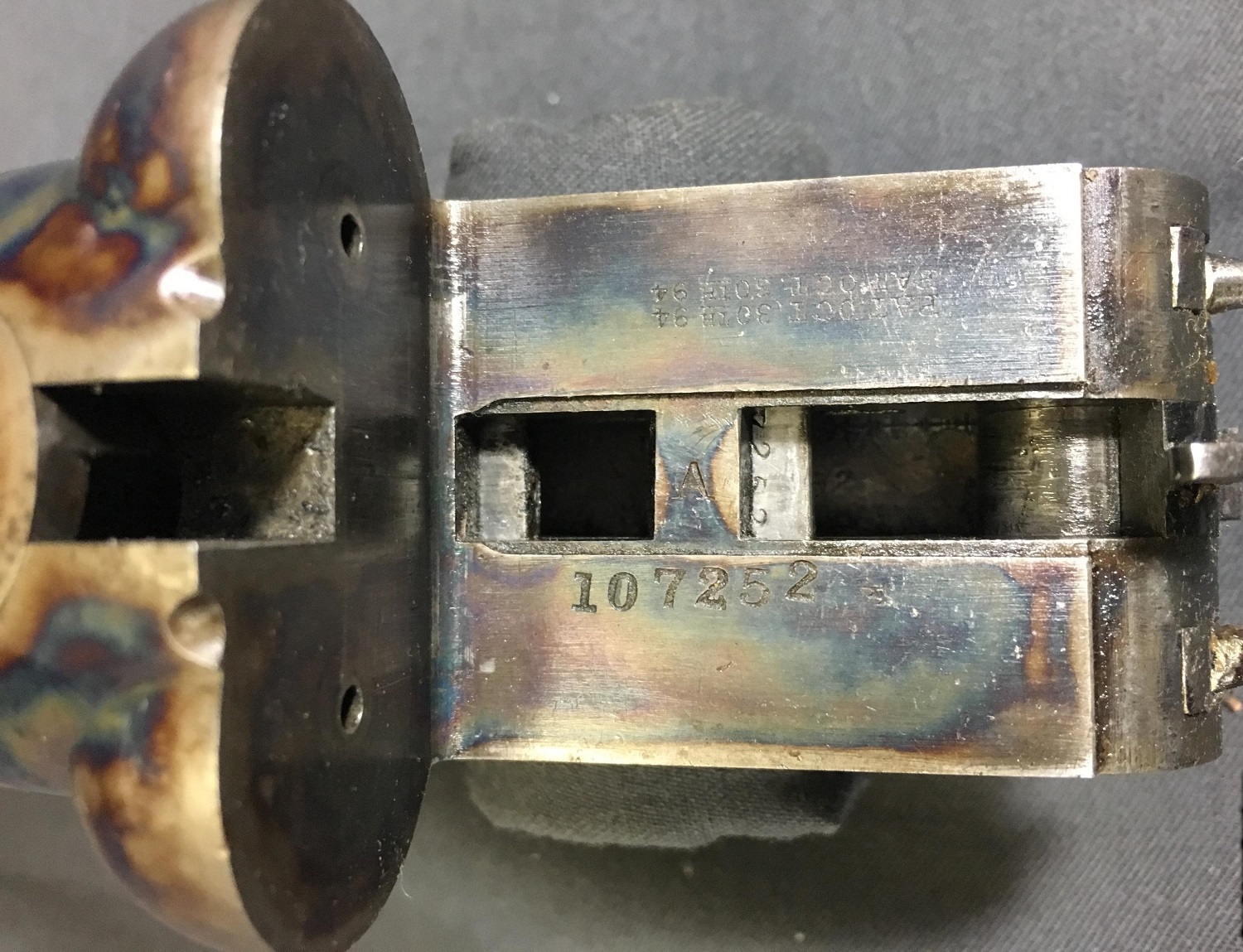

They were pretty common in the first 9000 guns. My Father's AE-Grade in the 103xxx range and a BE-Grade that I have in the 101xxx range are both made in that style.

107252 AE-Grade
107252 AE-Grade
107252 03.jpg (560.73 KiB) Viewed 5744 times

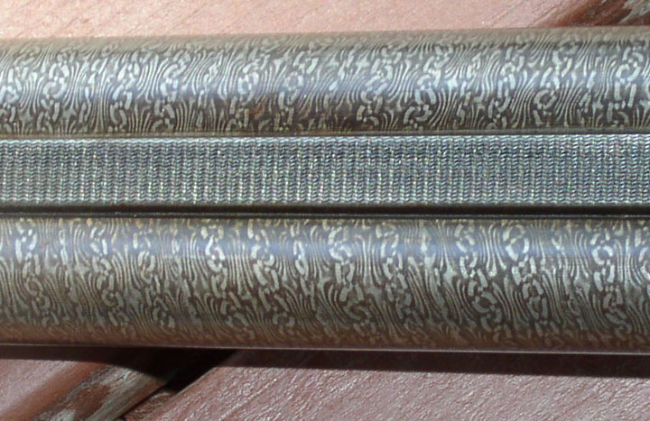

My BE-Grade 101315 has Chain Damascus barrels --
101315 BE-Grade 12-ga Chain Damascus 08.jpg (122.63 KiB) Viewed 5238 times
and the bottom of the barrel tubes are marked B J E.

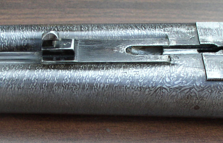

Forearm Loop Early.jpg (97.88 KiB) Viewed 5238 times
In Charles Semmer's book on page 275, he pictures the Damascus patterns salesman's samples, and the Chain Damascus is called CHAIN J. So, I have suspected that the J on my barrels has to do with the barrel material.
The truth is that no one left alive really knows what all the markings on these old Remington doubles mean.
