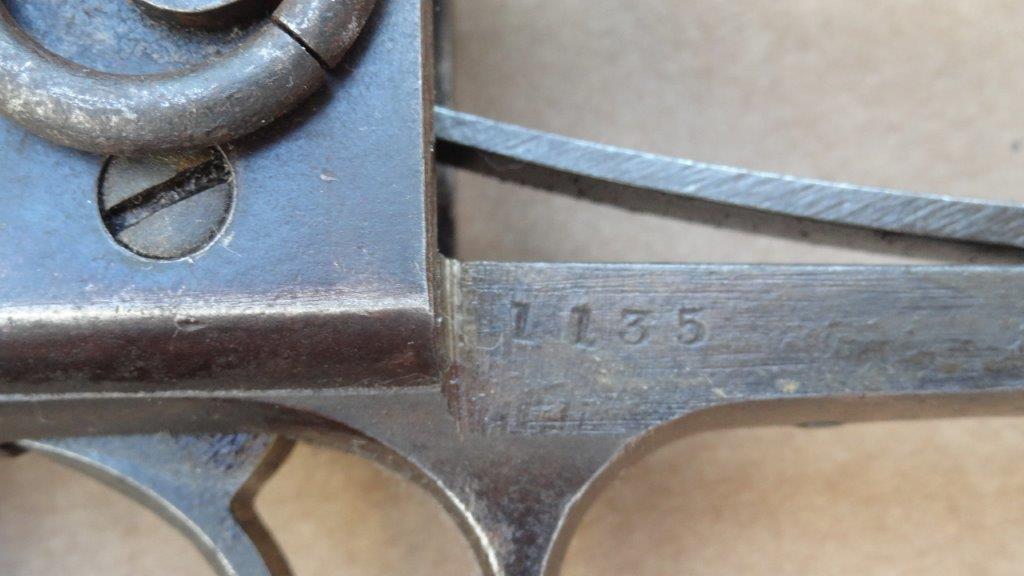

Hello everybody!
i am new here i hope somebody can help me. I have an original Remington Light Carbine in caliber .44 Henry RF.
The serial number is 1135.
In which year was the rifle built?
Does anyone else have some more information about the rifle?
Thank you and best regards!
Jens

The numbers on the side of the upper and lower tang are not serial numbers, but
assembly numbers.

No data on assembly numbers versus date of manufacture is available.

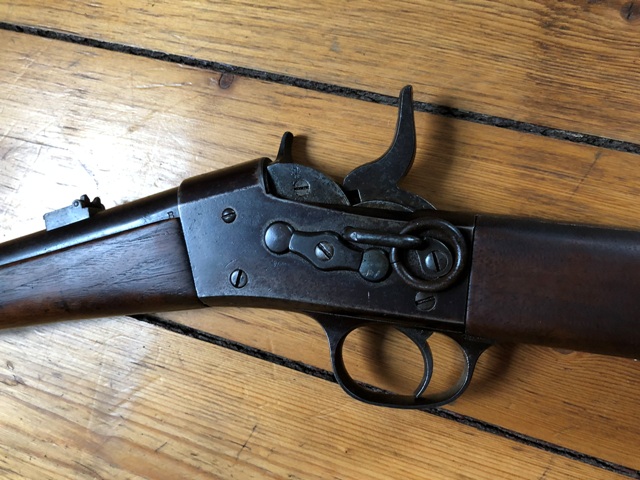

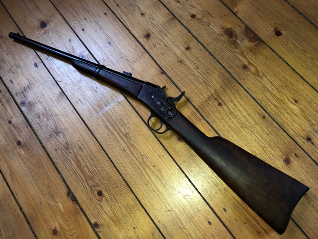

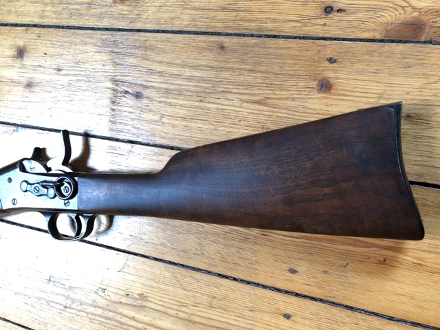

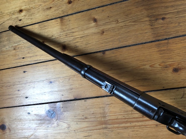

Thank you guys !
Here some more photos :-)

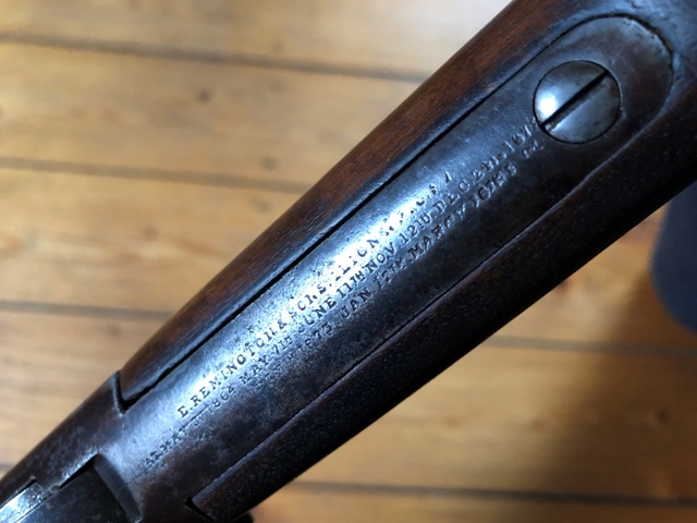

I will make a photo of the upper tang today ...

Post by ehull »

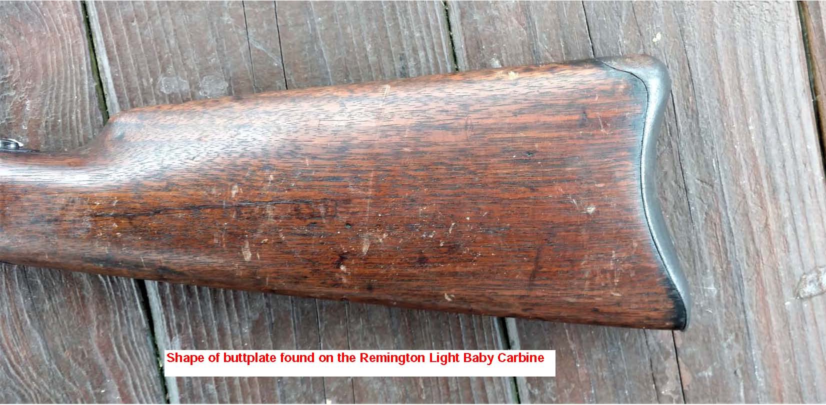

By your photos, this does not appear to be a Light Baby Carbine. It has the wrong buttplate shape, and the hammer and breechblock spurs are too thick - those on the Baby Carbine were much more delicate. The Baby Carbine has an 18 inch barrel; what is the barrel length on this carbine?

ehull wrote: Wed Jan 31, 2018 1:31 pm By your photos, this does not appear to be a Light Baby Carbine. It has the wrong buttplate shape, and the hammer and breechblock spurs are too thick - those on the Baby Carbine were much more delicate. The Baby Carbine has an 18 inch barrel; what is the barrel length on this carbine?
Hi!
The Barrel lenght is 16,54 inch...
And it is stamped ,B'
What sort of carbine is it...? :roll: :?:

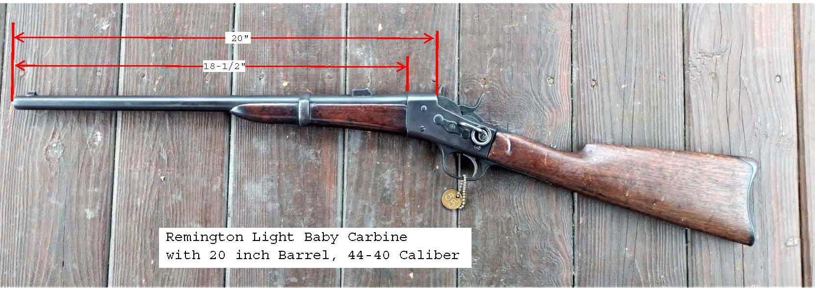

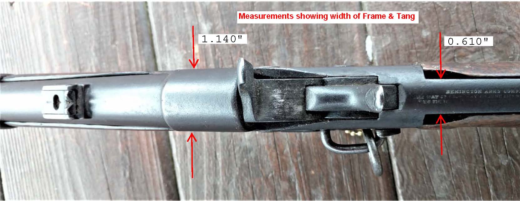

Post by oldremguy »

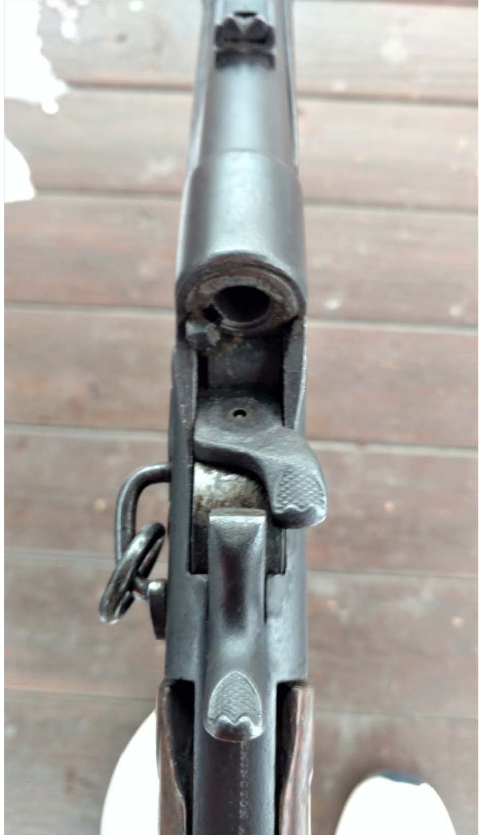

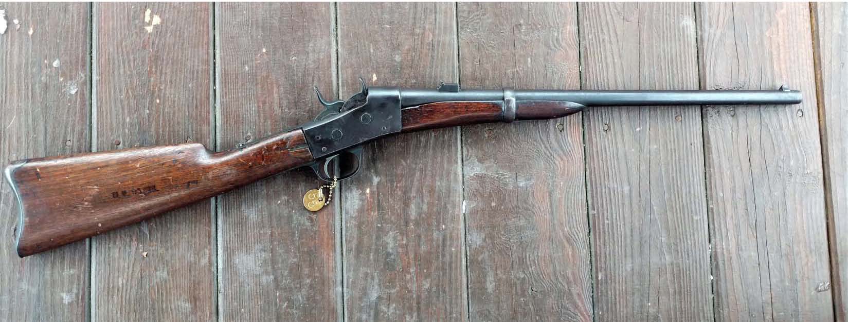

Here are some photos and measurements of a Remiongton Light Baby Carbine, with a 20 inch barrel and
chambered in 44-40 centerfire.

Hi Matt and ehull.
So, the, in the bore length` is 18 "....
maybe it is an early variant and the runlength has changed once? it's from e.remington & sons .., so built from 1885-1886.
otherwise the mass will fit.

Post by ehull »
One key measurement is the thickness of the frame. Matt shows 1.140 inches. The standard military frame, called the No. 1 for sporting arms, is thicker.

Post by Jensman217 »
good Morning! My frame is also 1,140 inches wide. So it's not a military rifle? many greetings jens
