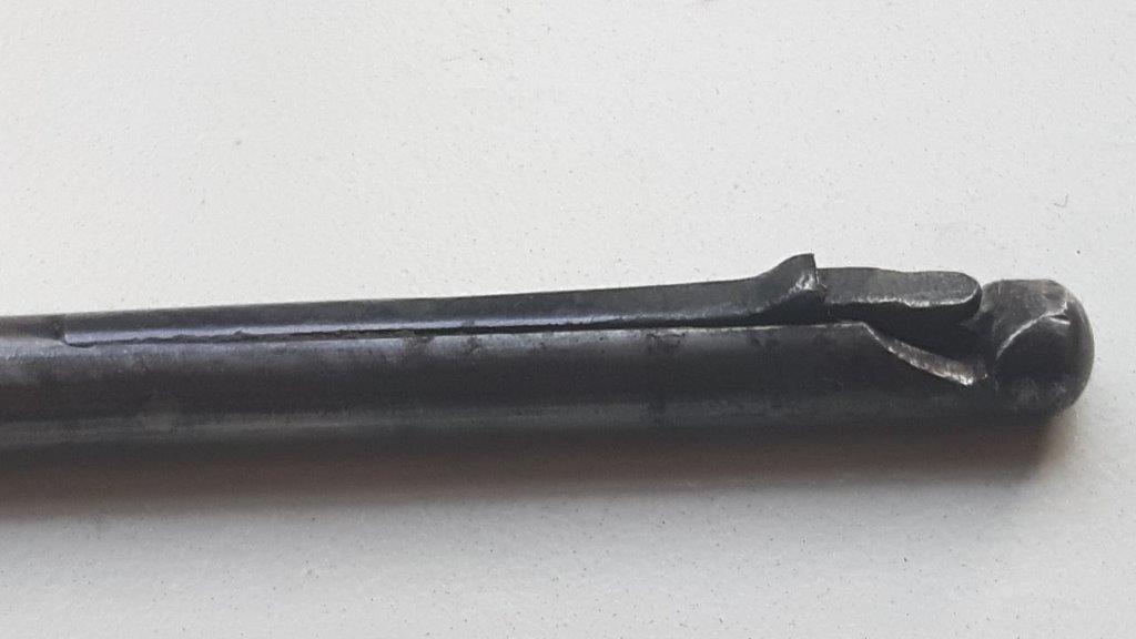

Post by PaulParadis »
I am trying to fabricate a base pin for a 1875 Remington revolver. I am requesting any member that can help me to send some photographs and any measurements that you can. The base pin that I am working on has a slot and a square with an arm type spring /lock system. My email is paul@paradisefirearms.net.

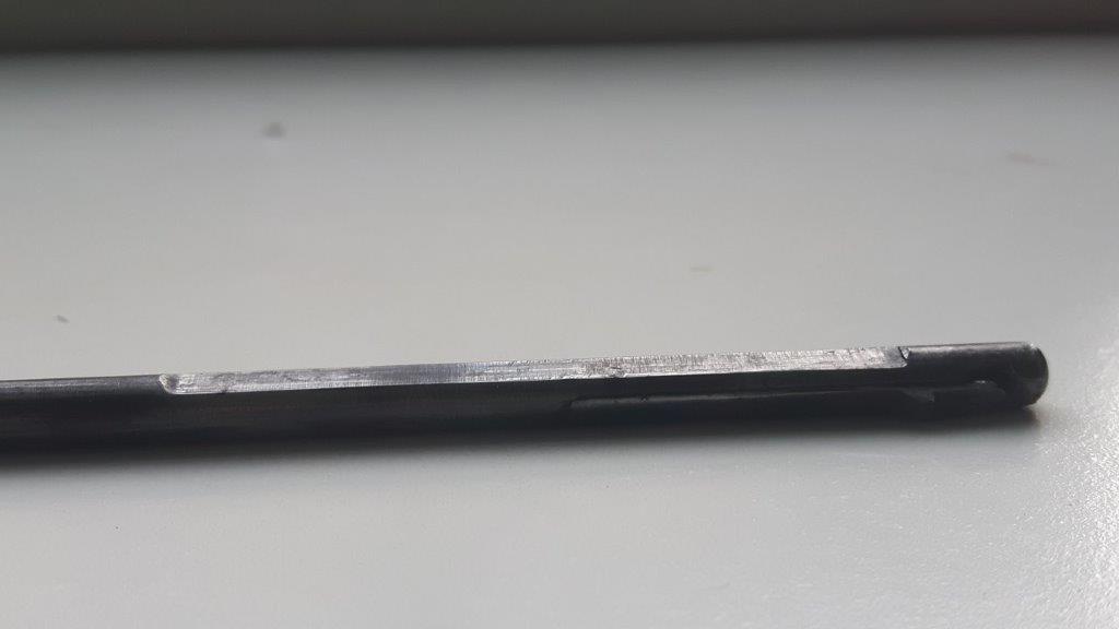

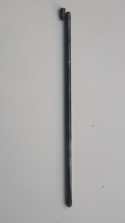

Hi Paul
Hope this is understandable.
Length: 7.55
Dia: 0.194
(don't mind the screw, it was just used for support)
Flat side: 2.145 long, 0.426 from the end, Dia 0.176
Lock arm length : 1.285 Width: 0.085
Cut out: 0.137 from end, length 02, debth 0.90
