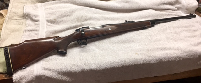

Hi John T. here again talking about 725 Kodiak's and early 62-63 Safari's. I had zero response to my last post on the same subject I guess either not much interest or just no one on the forum that has these guns to talk about ?

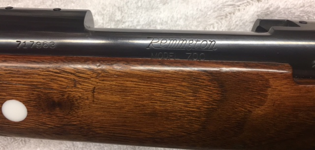

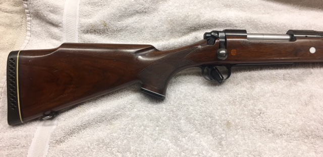

Any way I recently found and purchased a very interesting rifle that I believe is a transitional rifle between the 725 Kodiaks in 1961 and the 700 Safaris in 1962. It is a neat gun with traits from both the Kodiak and the 1962 Safari. It's in 375 H&H Mag the serial number is 717963 "a 725 serial number" yet the receiver is marked " Remington Model 700 " and after looking at it close the
"REMINGTON" is stamped into receiver but the "model 700 " is very nicely hand engraved !!  Same checkering pattern as both the Kodiak and 62 Safaris and the same cut out for receiver sight. Same factory muzzle brake as both guns however the front sight blade I believe has been changed as it's not the stock blade. Same rear sight and black recoil pad.  It has the recoil pin cover plugs like on the 62 Safaris white in front wood to the rear. The bolt, safety and receiver are all 725 features as are the sling swivels. Also the Kodiaks have a screw in the middle of the pistol grip cap but the Safaris don't this gun does not have the screw . It is definitely an odd ball parts clean up gun to me !! If any one has seen anything like it please let me know. I have spoken to John Lacy about this gun and he said he has seen other transition guns but with slightly different options. Again I would love to hear from anyone who owns any Kodiaks or 62-63 Safaris !! Thanks John T.
PS I tried to post more pics but 3 is all that would work !

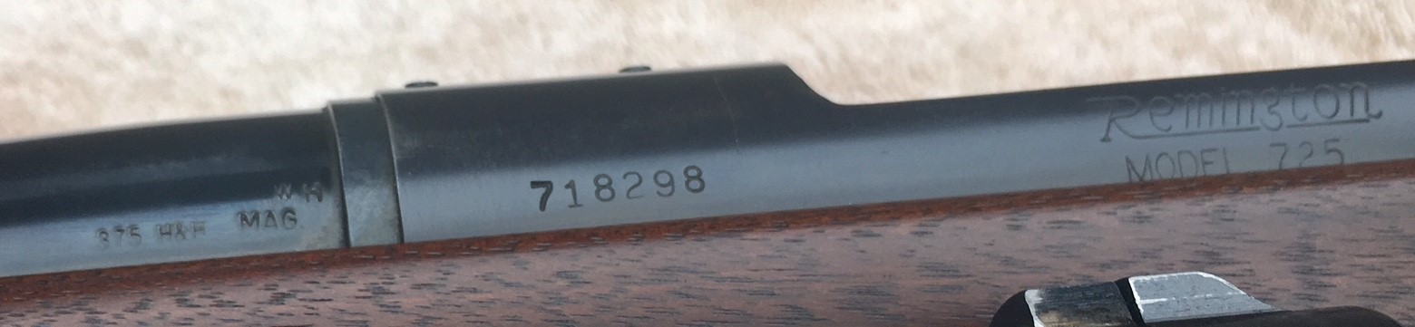

Thanks for the reply ! Being out of the custom shop there is usually no barrel date code but I have owned one Kodiak that did have a barrel code of "WH" which signifies August of 1961 manufacture which is just right for a Kodiak. There is also one listed on Gunbroker right now with the same date code "WH" so I guess they were some times used even in the custom shop !! I own both a 375 and 458 Kodiak now and neither have a date code. John
FullSizeRender (60).jpg (125.2 KiB) Viewed 4403 times
