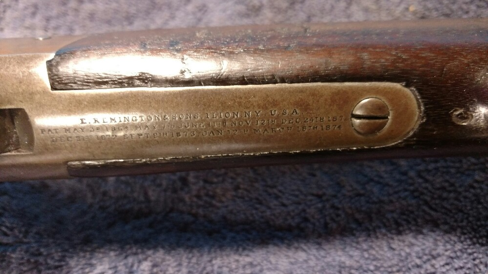

I'm sure you guys see this an awful lot. With that said, i've recently acquired a rolling block from a family member. It seems to have honest wear for its age. I bought George Layman's book and it really doesn't give me anything definitive. Any help would be appreciated!

More pics.. the "C" is right behind the tang on the buttstock.

Your rifle is a military issue so I would not expect to see an indication of origin other than, in a few cases, a crest. The rifles in my modest collection do not have that indication. The one point that is clear is that it was made by Remington (Patent information on tang) post 1874 rather that a licenced manufacture. Once you have checked your chamber cast you should get a good idea as to the military it was issued too.

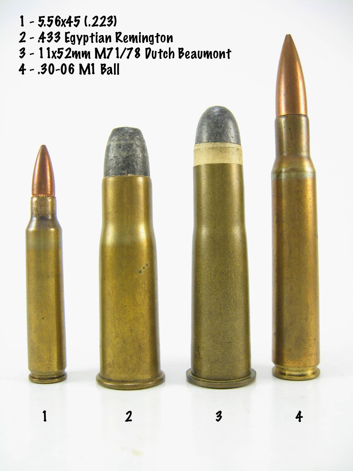

I vote 43 Dutch Beaumont. Very similar to 43 Egyptian.
43 comparison.jpg (131.75 KiB) Viewed 11750 times

I own and shoot 2 Egyptian Rolling Blocks and I can use Egyptian or Beaumont cartridges in them. I found this out when my usual supplier couldn't supply the Egyptian cases so I tried the Beaumont ones assuming that I would have to resize them but there was no need to do so.

stanforth wrote:I own and shoot 2 Egyptian Rolling Blocks and I can use Egyptian or Beaumont cartridges in them. I found this out when my usual supplier couldn't supply the Egyptian cases so I tried the Beaumont ones assuming that I would have to resize them but there was no need to do so.
Similar situation here: I noticed that modern 43 Egyptian ammo (made I think from 32 ga. brass shotgun shells) chambered easily but the fired cases had the shoulder fire-formed into a different angle. I bought some modern 43 Dutch Beaumont and it chambers a little tight so that the rolling block did not want to finish closing by just a smidge. What I did was to chamber each of the 20 new 43 DB rounds and used a mallet to tamp the rolling fully closed using extreme care. That sort of formed the brass to the chamber so that subsequently the rolling block closes easily. I haven't fired any of the 43 DB yet.

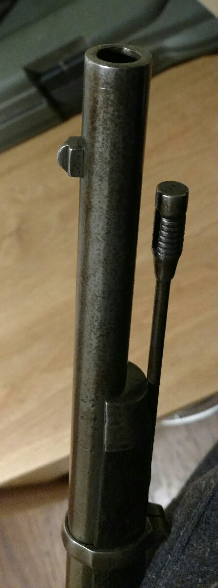

New Swedish aquisition..
Now just need to find a source for 8x58R.. :mrgreen:
