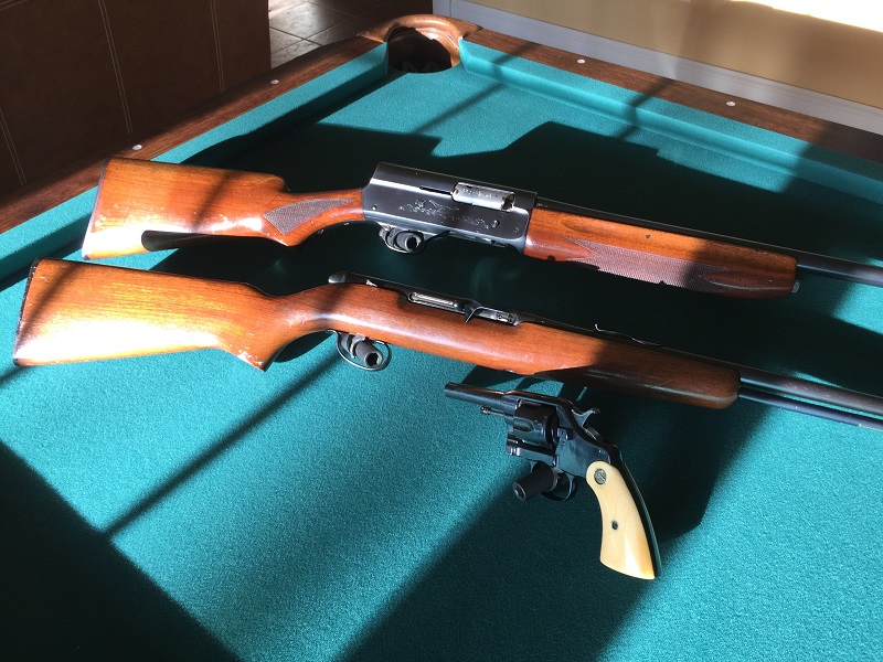

This was my grandfather's shotgun. SN# 800633. I also inherited his 22 rifle model 550-1 and a colt revolver. I'm really enjoying these precious gifts. I have no plans to sell but I just want as much info about the guns as I can locate. I am including a pic and would b happy to share with anyone on the board. I'm sure there are "Sportsman" experts here so please feel free to ask questions about the guns or tell me what I have here. I took the pic just after I cleaned all of them this morning. I know very little about guns but I am very interested in learning about them.
Thanks
Henry
Picture of inherited remington Sportsman
abcfisher1
- Shotgun sn#800633
22. model 550-1 - guns 020.JPG (205.89 KiB) Viewed 2850 times

Re: Picture of inherited remington Sportsman
In 1930, Remington Arms Co., Inc. introduced a three-shot version of their recently introduced 20-gauge Model 11 (a five-shot), and called it "The Sportsman."
The 20-gauge “The Sportsman” had serial numbers beginning low S1? Maybe S1000? They added 12- and 16-gauge "The Sportsman" in 1931, with 12-gauge "The Sportsman" having serial numbers starting at S500,000 and 16-gauges having serial numbers starting at S200,000. In the early years, "The Sportsman" had a three-bird roll-stamping on each side of the receiver.
In 1934 DuPont acquired controlling interest of Remington Arms Co., Inc. In 1937, Remington reduced the roll-stamping on "The Sportsman" to one bird on each side and started putting the roll-stamping on Model 11 receivers as well. At the same time, the name "The Sportsman" or "Model 11" began being stamped on the bolt.
On Sep. 28, 1937, they stopped the separate serial number sequence in the 2xx,xxx range for the 16-gauge "The Sportsman"; on Aug. 24, 1937, they stopped the separate serial number sequence in the 5xx,xxx range for the 12-gauges and finally on Feb. 14, 1938, they ended the separate serial numbers for the 20-gauge “The Sportsman” at 16,753. From then on the "Model 11" and "The Sportsman" were serial numbered together, continuing the Model 11 sequences. Combined 12-gauge "Model 11" and "The Sportsman" serial numbers reached 499,999 on August 1, 1943. Serial numbers were then jumped to 700,000 and continued. A gun in the 800000 range must be one of the very last ones before they went to making the streamlined Sportsman-48.
In addition to The Sportsman A "Standard" Grade, Remington also offered The Sportsman B "Special" Grade with nicer wood --
and the hand engraved and custom-stocked Sportsman D "Tournament" Grade, Sportsman E "Expert" Grade and the top of the line Sportsman F "Premier" Grade. About 1934, Remington added a Sportsman Skeet Gun to their offerings --
the main features being SKEET choked barrel, a bit nicer wood, a fatter forearm and a capped pistol grip.
