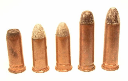

Here is a picture showing, from left to right:
(1) .50-70 blank
(2) .50-45 (short case) Navy carbine, and SA-made (RB) cadet
(3) .50-45 (long case) Navy carbine, and SA-made (RB) cadet
(4) .50-55 carbine, and Army cadet (Allin system)
(5) .50-70 rifle
One should not be able to chamber a .50-70 (1.75" case) in an arm originally chambered for the shorter .50-45.
