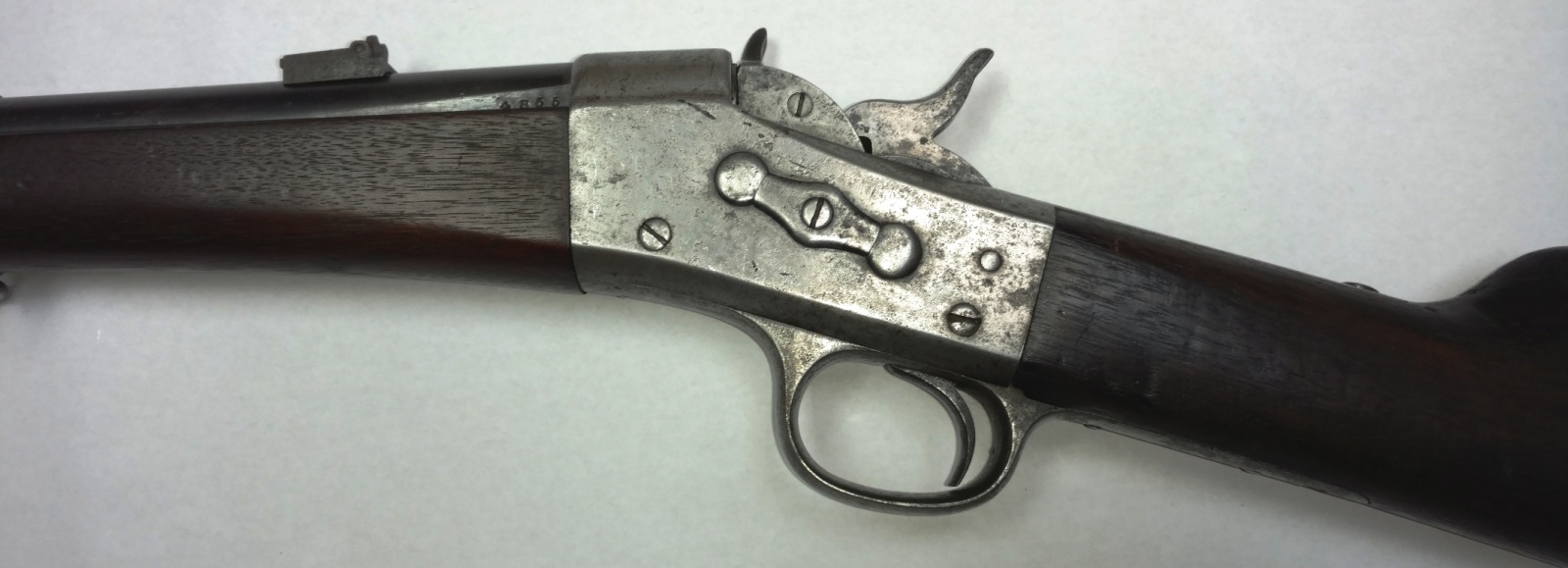

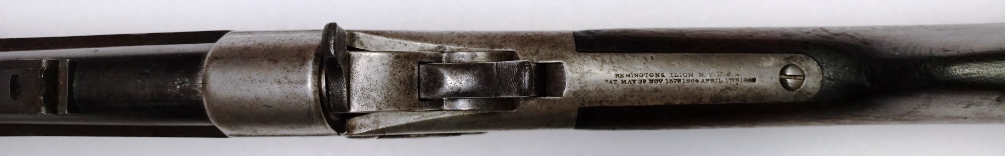

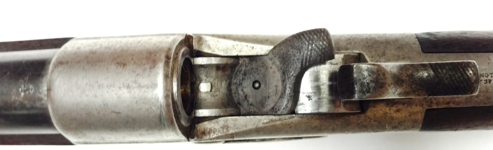

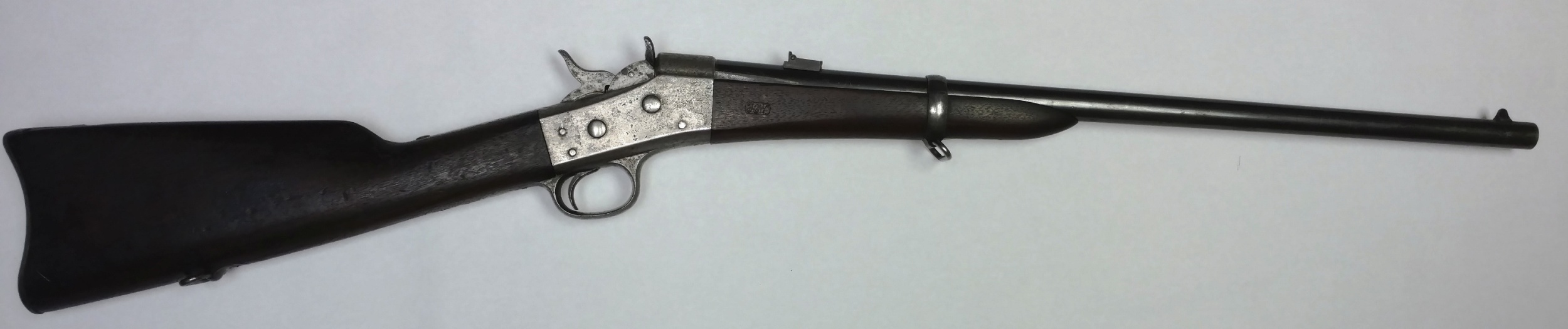

Attached are photographs of what an original 1867 Navy Rolling Block Carbine looks like.
photo 1 - Copy.jpg (222.47 KiB) Viewed 7798 times
photo 2 - Copy.jpg (236.78 KiB) Viewed 7798 times
photo 3 - Copy.jpg (216.5 KiB) Viewed 7798 times
Will add more photos in the second post.
Have a Good Day,
Matt

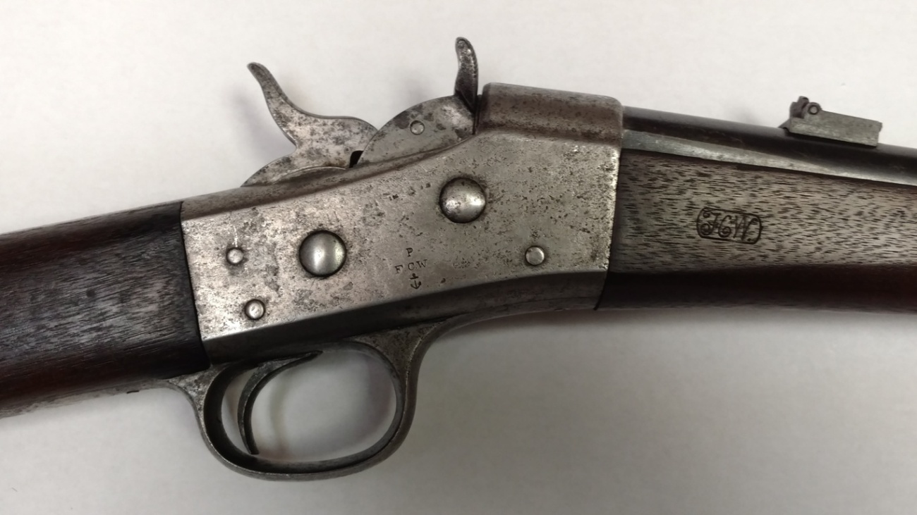

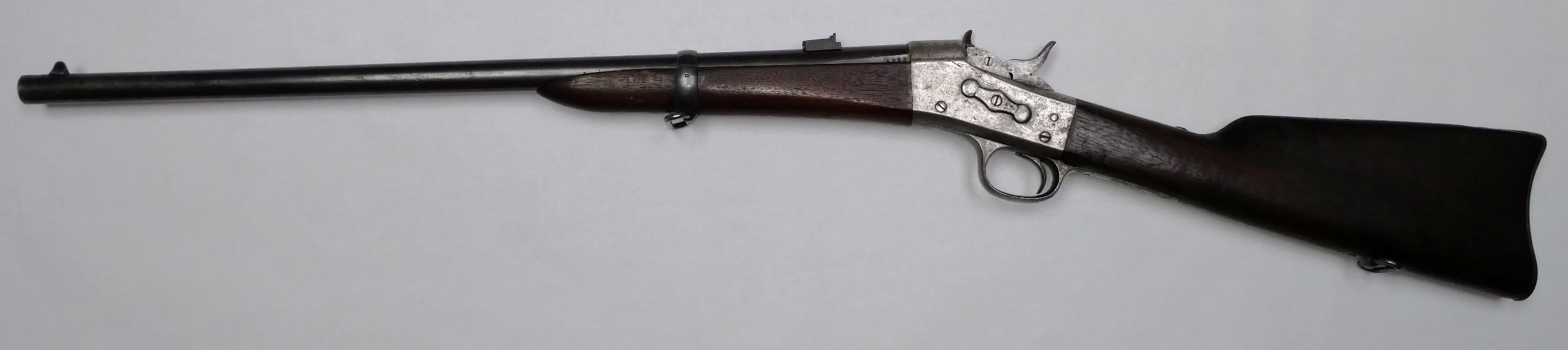

More photographs of the 1867 Navy Rolling Block Carbine.
photo 4 - Copy.jpg (221.91 KiB) Viewed 7798 times
photo 5 - Copy.jpg (184.75 KiB) Viewed 7798 times
photo 6 - Copy.jpg (175.17 KiB) Viewed 7798 times
Have a Good Day,
Matt

Oldremguy: Thanks, That is absolutely exactly what I have with the damn exception that the one I have is refinished so much on the action flats the markings are gone, the barrel is the same and the rear sight has been changed out to a 3 piece flip type express. I will take some Pics in the AM when the light is good. as in the posts above I reference the Numbers and markings that are visible. To bad the old owner had to "make it so pretty". Thanks so much for giving me and all the other followers something to compare with the real thing. That is a beautiful rifle.

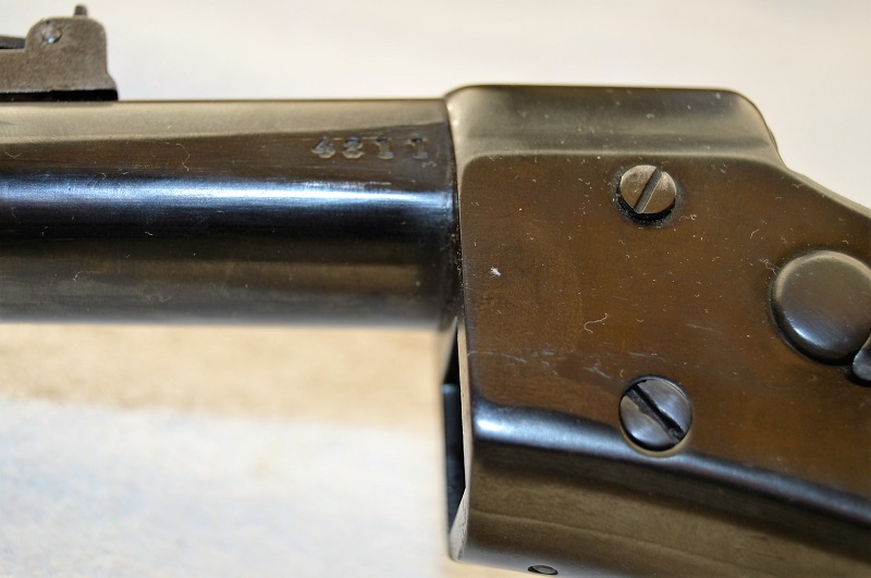

Re: Tulsa GS find 1867 Navy carbine PHOTOS ADDED
Post by jon_norstog »
Why does the Navy need a carbine? Is it for the Horse Marines?
JN
ehull
Posts: 247
Location: So. California
Post by ehull »
Note the extra screw on the left side of the frame on the refinished carbine - that's a non- Navy frame which originally had the slide extractor (and the breech block is also cut for the slide extractor). It appears someone mated a nice original barrel and forestock to highly refinished frame parts from other sources. Thus, the mismatched tang numbers. If it's a good shooter then you certainly did not over pay.

JV Puleo
Post by JV Puleo »
A couple of points... these were NAVY carbines, intended for use by Naval landing parties. The Navy liked carbines for this purpose and had bought Smiths and Sharps & Hankins during the Civil War. At the time they were purchased, the Marines were still armed with muzzle loaders, usually M1861 &1863s. When the Marines went ashore in Korea in 1871, they borrowed the Navy's carbines, I suspect because the commander of the Marine landing force, Capt. McLain Tilton, had been a member of the board that recommended adoption of the Rolling Block. But — while the Navy adopted the RB, the Marines never did adopt it as their official arm. When the Navy adopted the M1870 RB rifle, these were sometimes loaned to Marines as well. The Marines adopted the M1868 Allin conversion in 1870 but it often took a long time for the new rifles to reach Marine detachments on ships far from home (which is why they didn't have them in Korea).
