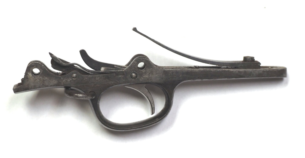

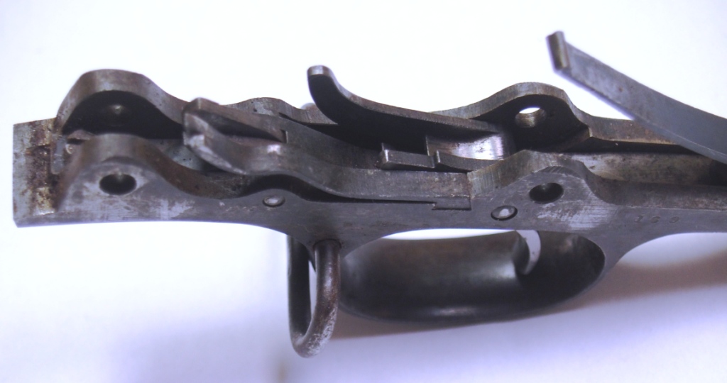

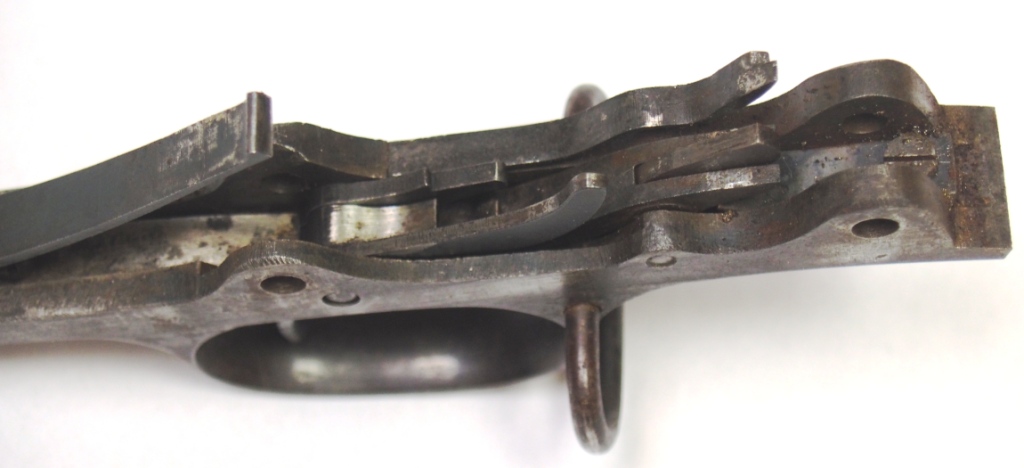

I have done many reg rolling blocks with no problems, but I can't seem to get the NYS version to go back correctly. I think I am doing something wrong with the small maybe 7/8 in long spring that I am installing near the Mainspring. So someone help me out Please!! Is there a special way it goes in?

The photos below showing the where the springs are located inside the trigger guard of a NYS Model rolling block rifle.
P1010300 - Copy.JPG (87.02 KiB) Viewed 4168 times
P1010308 - Copy.JPG (155.94 KiB) Viewed 4168 times
P1010311 - Copy.JPG (134.4 KiB) Viewed 4168 times
Hope the photos help.

Great info - thanks for sharing. What a Rube Goldberg (I show my age) mess.

Thanks for that 'Oldremguy'.
I have saved the images in my Rolling Block file on my computer. It has also helped me to make the decision ' Don't take the NYS rifle apart unless absolutely necessary.
