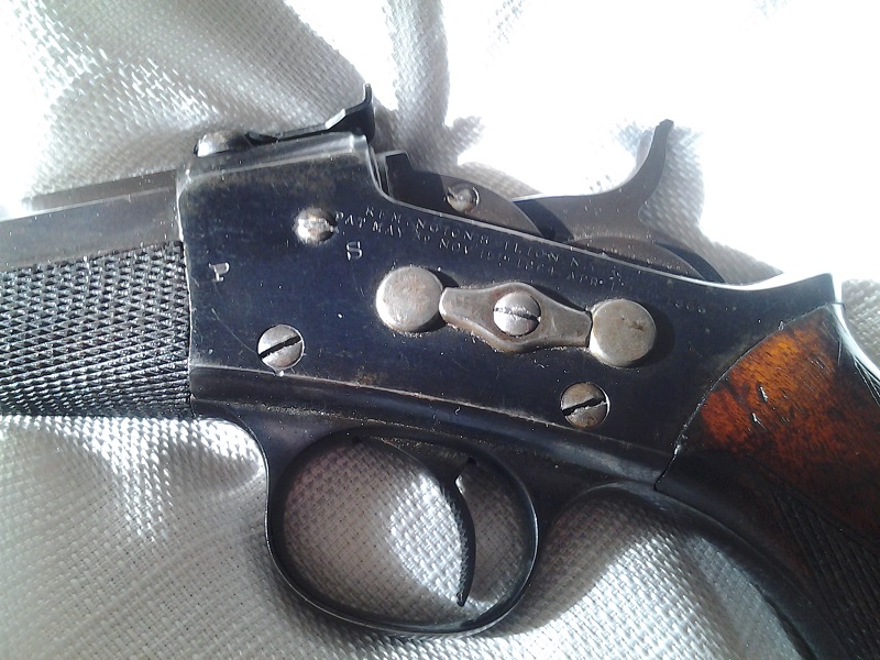

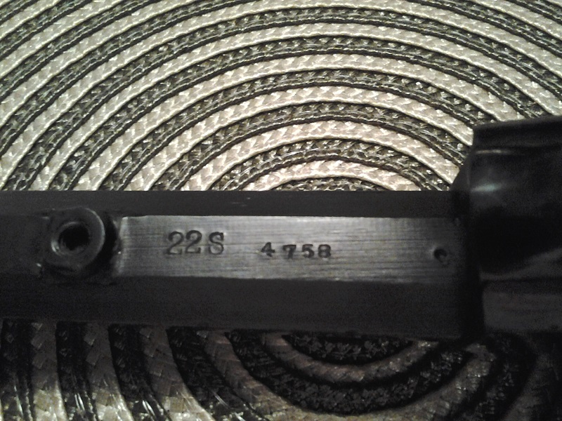

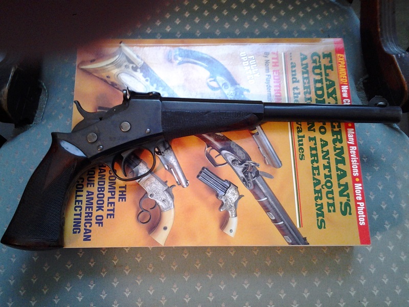

Okay, here are pictures of this firearm? What is a fair price to pay for it? It might be priced too high for my liking, but what might be a good wholesale and retail price for it? Any other thoughts regarding this firearm?
- Remington1901(3).jpg (183.25 KiB) Viewed 7711 times
- Remington1901(2).jpg (184.94 KiB) Viewed 7711 times
- Remington1901(1).jpg (190.39 KiB) Viewed 7711 times

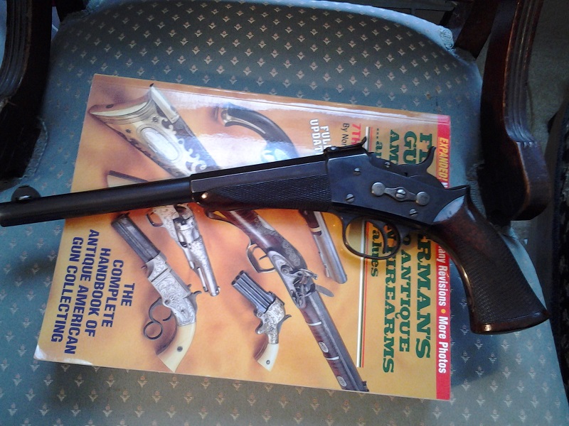

And one last photograph of this Remington 1901:
- Remington1901(4).jpg (200.11 KiB) Viewed 7711 times

I cannot comment on the value of the revolver because I have not examined it. The rear site is different from any that I have seen on 1901’s. It may be a replacement. The original site was is adjustable for elevation and windage.
Bill
Bill
Re: Remington 1891 & 1901 Target Rolling Block Pistols
Yes, the rear sight is adjustable for elevation AND windage.
