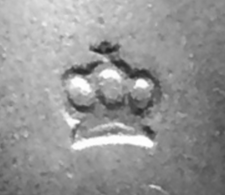

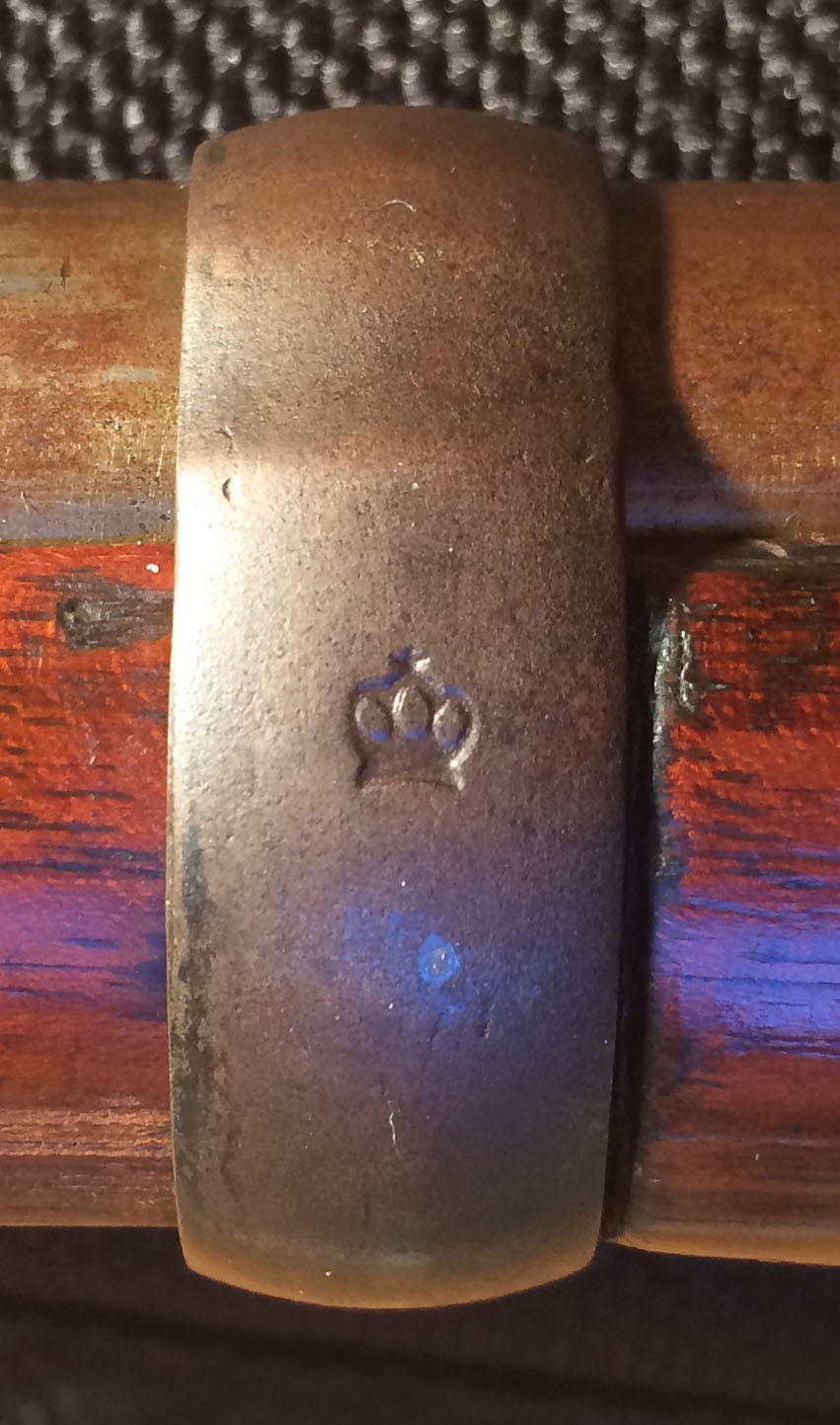

The barrel bands are of the solid type, retained by spring clips attached to the forestock. The front barrel band has a crown stamped into it (see pictures). This crown is slightly different in style than the ones on the Greek RB shown on pages 83-85 in George Layman’s book. The cross on the crown in Layman’s book appears different than what we see here: the crown on the Greek RB seems to be splayed out more along the horizontal axis, and the design of the cross atop the crown appears to be different. In fact, to my eye it’s more of a star than a cross atop the crown on my RB (but there may be no historical precedent for stars atop crowns so I’m not pushing my opinion here). The crown on my front barrel band (and it is the only crown on the gun) looks very much like the crown shown at http://www.theopenrange.net/forum/index ... pic=6174.0. Someone commented on that site that the crown was a Danish crown, but the Danish crown has four lobes, not three. I’m not so certain it’s Danish. Does this crown reveal anything about the history of my RB?

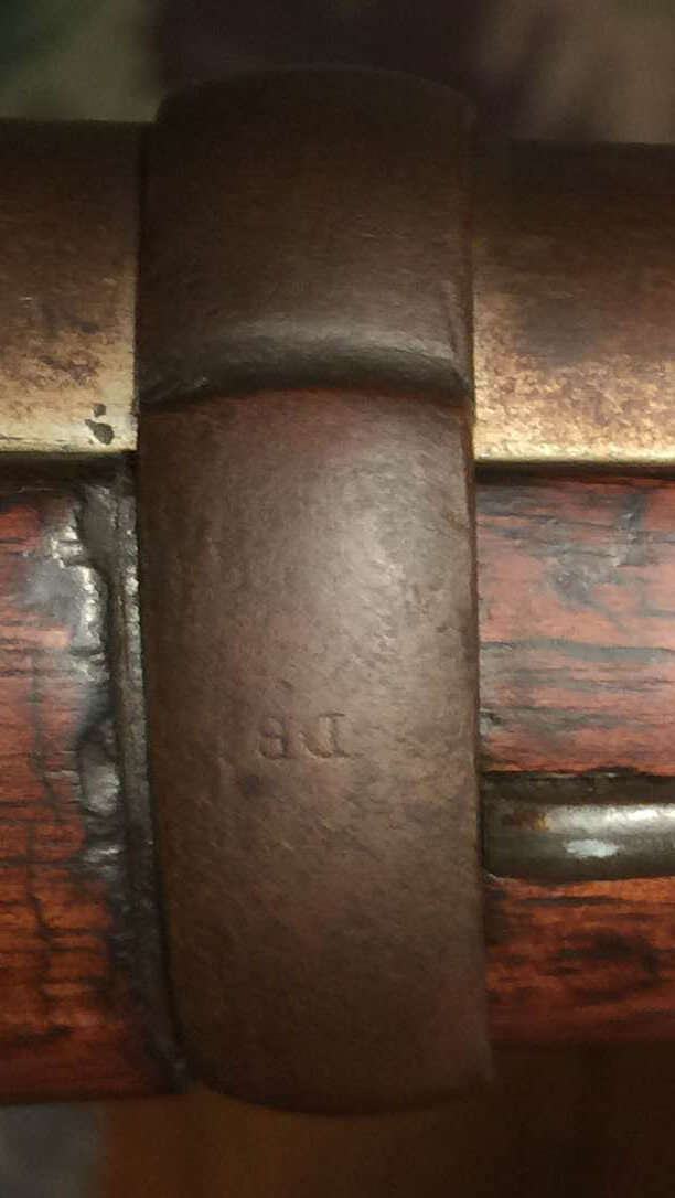

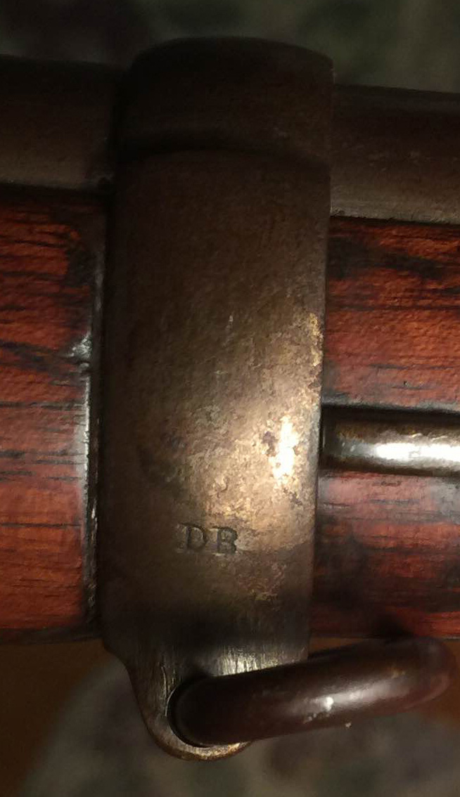

The middle and rear barrel bands are stamped with the letters ‘DB’ as shown in the attached pictures. Any ideas? Has anyone seen this before?

Detail of the crown stamped into the front barrel band.
Crown Detail.jpg (150.57 KiB) Viewed 2215 times
The middle barrel band stamped with the letters 'DB'.
Middle Barrel Band.jpg (165.15 KiB) Viewed 2215 times
The rear barrel band stamped with the letters 'DB' up-side-down.
Rear Barrel Band.jpg (201.03 KiB) Viewed 2215 times

Resending picture of front barrel band that didn't make it through the first time.
Front barrel band with crown stamped into it.
Front Barrel Band.jpg (179.92 KiB) Viewed 2214 times
