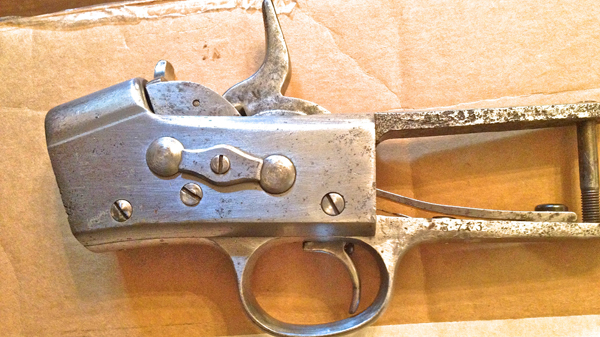

George, Thank you for replying to my post. Since the initial post I have bought and have been reading your book. The only reference to my action is on page 30 regarding the "Day extractor". I have compared my action to every action image and unless I have missed an image the photo in upper left hand corner looks like the screw and pin configuration of my action.
As I stated, the gentleman I bought this action from thought it to be a 1 1/2, but you refer it to be a "#2) and also a size 5. The markings on the tang have been ground or polished off and the only other marking is a series of numbers on the upper tang looking at left side of action 5152 and the an obscure number. On the lower tang on the left side is a series of numbers 3713. Unfortunately, there are no other markings.
Again, the gentleman I bought the action from said it had a single set trigger which I cannot get to work. There is an adjustable set screw threaded into the rear of the trigger.
If I can get some photos down loaded maybe they will help identify the action. Pardon the tape. No pin or screw under tape on upper part of action, but a screw is covered by tape on lower part of action.
Again, I appreciate your reply to my rather terse post.

Re: Model No. 1 1/2 Rolling block
DixieJack,
I will not represent myself to be an expert on rolling blocks but I will make the following comments.
1. The receiver is not a No.1 as all number ones have the sliding extractor as indicated by the extractor retaining screw in the upper left of the receiver. The lower tang on Number 1 sporting receiver is longer than the upper
2. It is not a 1 1/2 as all of them have flat sides and a three facited top on the receiver. The receiver should measure 1.14" thick on the 1 1/2.
3.It is not a number 2 as the rear of the number 2 has unique quarter circle shape at the receiver/stock intersection.
4. The flute on top of the receiver would indicate to me that it is a shotgun or " foraging rifle" receiver.
5.The robust hammer and rolling block dimensions indicate that it is of military origin.
6. My best guess is 1868 military.
Now let the more knowledgeable people chime in.

Dixiejack
31 rst
You can measure the bore diameter, measure the chamber length and diameter. Google for .45-70 dimensions and that would give you a pretty close idea of the caliber. Numbers, sorry I can't help you there.
rider
I have definitely ruled out a 1 1/2 action and if I read Mr. Layman's book right, there were no official #2 Rollies (more of a collector's designation of a 2nd model #1).
I don't think the flat on top of the action at the breech means it is a shotgun. Most all the round breech ends have that flat. Mine has an index mark that is center of that flat but on the front edge.
The action is the size of a #5, but what puzzles me is there are no upper action pins that I normally see on military rifles..
rider

tanpatsu
Hello George,
I have been away here for a bit...Anyhow it seems your action as shown has no Remington tang address and from my view, it appears to be a late Whitney type 2 action. If the extractor has an "S" configuration, that would be it, not to mention that they snap back like the later 1902 Day type extractor. Whitney seemed ahead of Remington as far as extraction improvement is concerned as when the Rider patent expired, Whitney introduced the "Improved Whitney Military Rifle" (and action) around 1882 to supersede the overly complicated Laidley action known as the Whitney Type 1. The position of the extractor screw beneath the front breechblock pin is the giveaway. Another oddity is that most Whitney rolling block actions both early and late, had the "button" retainer adjoined to the hammer and breech pins, but very late in time, perhaps just before Whitney's 1888 bankruptcy, simplified things by using breech pins held with the convention Remington style button retainer. By the way, any evidence of a serial number on the bottom of the tang, worn down, even appearing "scrubbed" or rubbed off? Thank you for the comments on my book, and I apologize for space reasons in the book, I could not elaborate on the Whitney as much as I wished. Perhaps in a revised edition we will be able to cover much more territory.

Dixiejack
George, I too, apologize for not replying to your last post. Thank you for shearing more light on identifying my Whitney RB action. The extractor screw below the breechblock pin had me puzzled. I never could find a #5 action with the extractor screw in that location. In fact, it appears to be an exclusive feature of the Whitney, as you stated. On page 30 of your book show such a screw, but no reference to Whitney.
One other "oddity" I have found is an adjustment screw running horizontal through the upper part of the trigger. It has a slotted head, but there is hardly room for even a jeweler's screw driver to fit the slot. The gentleman I bought the action from said it had a single set trigger that I cannot get it to set. I'm thinking this might be some type of trigger pull weight adjustment screw that was added later by a gunsmith or possibly this action is not a military action and this could have been a factory option. I have no proof--just conjecture on my part.
One question. Are the Whitney's value more, less, or on par with the Remington Rolling Blocks?

tanpatsu
Hello George,
Thank you for the reply...Say I really don't know about that added screw feature as its sort of something new to me regarding the Whitney as I have never taken notice of such a feature on the military size action. It MIGHT be a gunsmith addition but I honestly cant answer that. Pricewise complete Whitney military RBs are right up there in price and do indeed have a following, as well as from myself too. On the whole, the later version seems scarcer than the earlier Laidley-Whitney type one, however in fine condition or (especially with the Mexican RM cartouche in even fair condition), one can find them to reap $1100 to $1500.00. However I have found more RB collectors seem to be after the Remington than the Whitney. I have always been a fan of the latter with equal liking. Hope this is of help.
