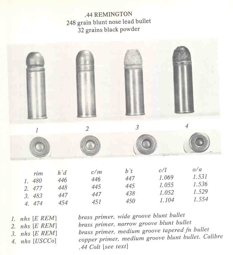

Here's a photo of the page listing the .44 Remington. Note that example 4 is the .44 Colt. George has it pegged with the three calibers the 75 is chambered for, but I am working on a project to investigate the 450 Boxer and 455 Webley for the London market.
I'd like to see a photo of the cylinder in question as well as the dimension of the gap between the rear of the cylinder and the face of the frame.
