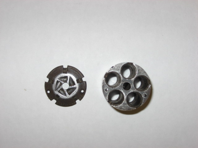

Hi Mike..Could you clarify something for me..Is the cylinder for the NMA, two piece as found on the Police and Pocket models?....Jim
Mike Strietbeck
Re: Remington army factory conversion information sought
Post by Mike Strietbeck »
Jim,
Yes, the conversion cylinder for the NMA is a two pc. capping plate design. It differs from the Police, Pocket, and Revolving rifle style in that the NMA appears to be earlier and doesn't have the knurled edge on the capping plate and is not nickel plated, its well worn blue.

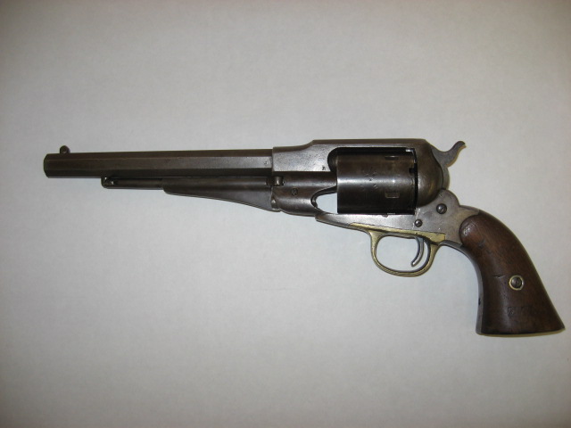

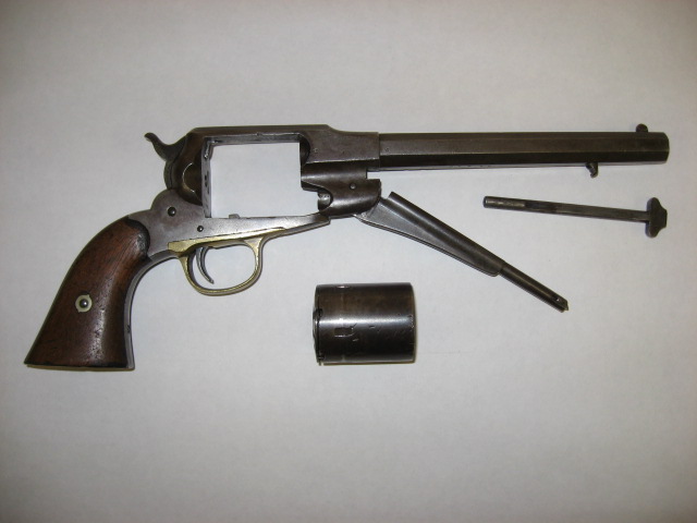

Mike Strietbeck
Here's a couple of photo's of the NMA capping plate conversion. It's S/N 98317 and I have the percussion cylinder with it as well. I have a second example as well but without the percussion cylinder.
Best regards,
Mike
gmaque
Posts: 100
Joined: Sat Apr 05, 2003 5:29 pm
Location: Baton Rouge, LA
Post by gmaque »
Mike
Thanks for the pictures. Now I have to find a capping plate .44.
