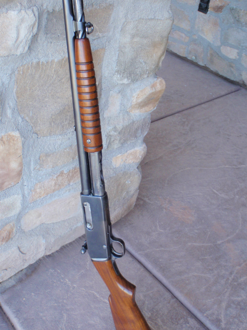

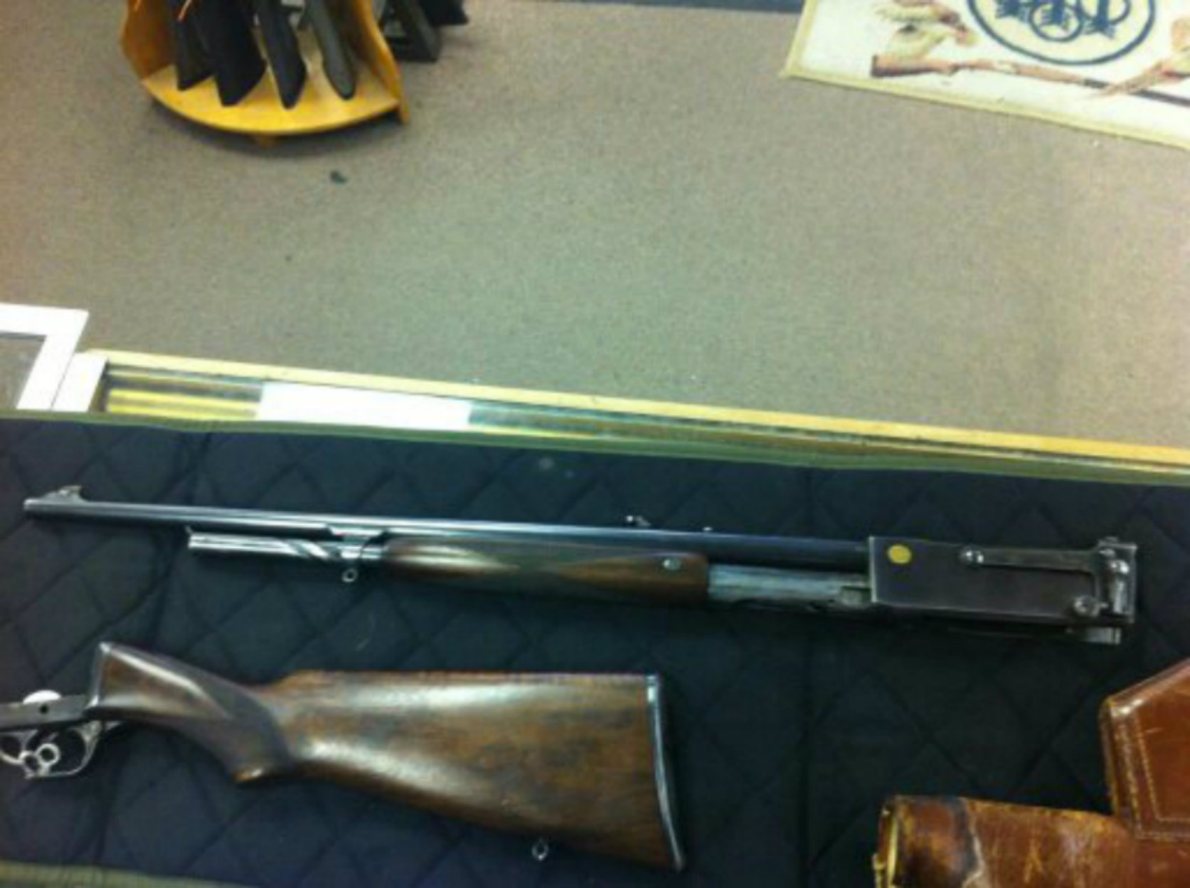

Thought I better post a pic of my new model 14 Deluxe 35 Rem, (the one on the gun store counter), along with my 32 Remmy.
The 35 was made in 1918 I believe, and later returned to Remington for service in 1931. The 32 Remmy is 1927 vintage. It has an old pachmyer pad and a Pacific sight, but is otherwise stock.
