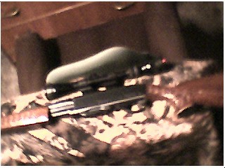

I have owned about 16 or more Remington Gamemasters in my 35 year hunting career and my family owns another 10 Gamemasters and they all wear one sort or another of a SEE THRU scope mount.
One brand that comes to mind is the Kwik Site, another is a Genuine Remington See Thru mount, such as was sold in the Kmarts and Walmarts at one time or another.
Putting the scope above the open sights allows you to look through the scope easier and in time you will forget about using open sights. JMHO.
- Remington 760 Gamemaster BDL Deluxe .jpg (27.37 KiB) Viewed 5703 times
