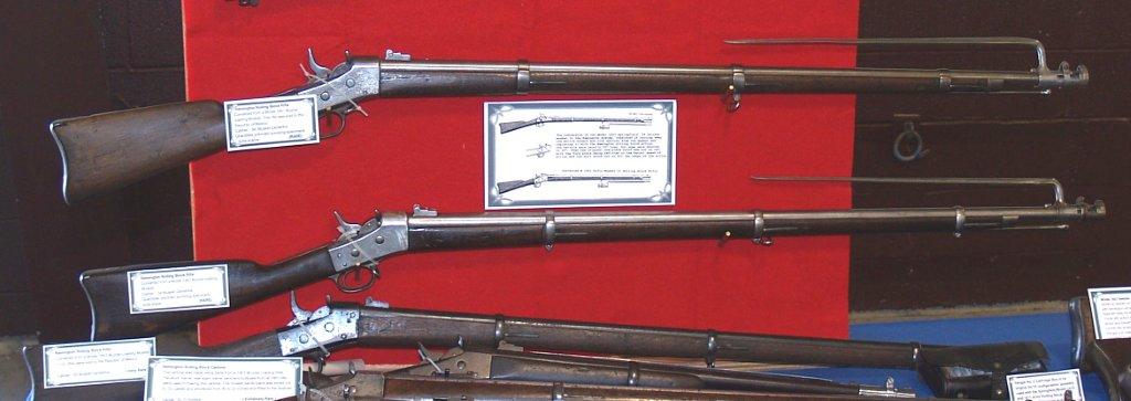

Here is a photo of (3) Springfield 1861 and 1863 Muskets that were converted to the Remington Rolling Block system. The rear sight would of been the ones that were used from the musket and not the Model 1868 sight.
Converted Musket to Rolling Block.jpg (55.5 KiB) Viewed 5359 times
Hope the photo helps show you what they would of look like.
Remington would of cut the musket in front and in back of the lock plate of the musket and then used all of the rest of the parts on convert the rifle.
