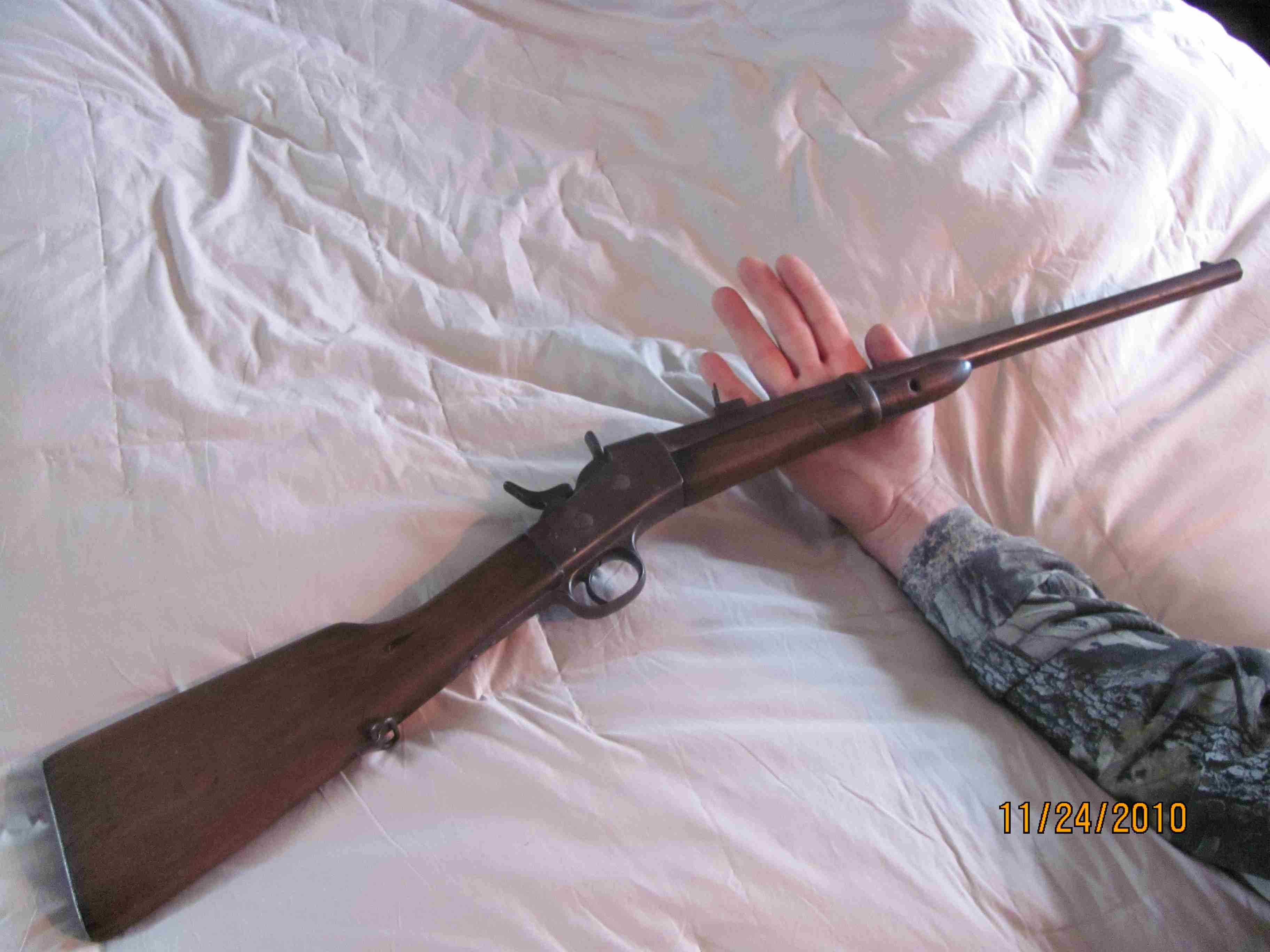

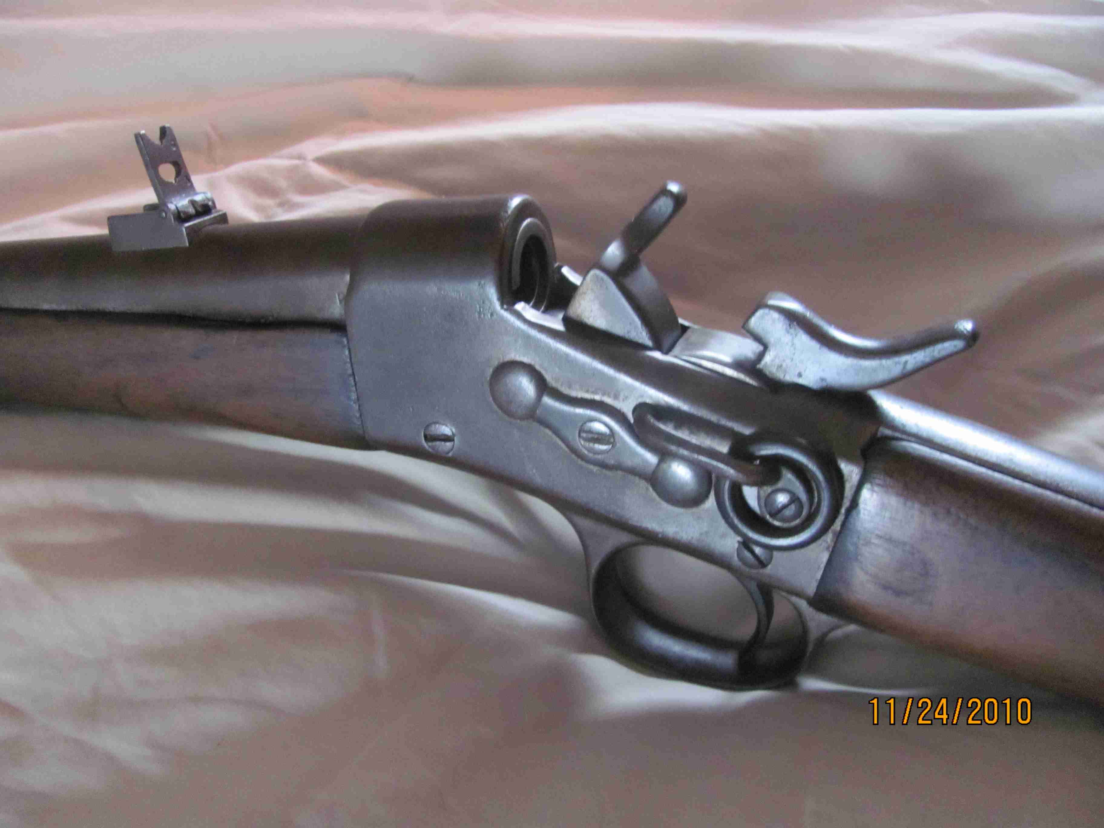

Hi, I'm wondering if this a remington light baby carbine...
- IMG_0467.jpg (151.35 KiB) Viewed 9581 times
- IMG_0465.jpg (163.63 KiB) Viewed 9581 times
- IMG_0463.jpg (161.9 KiB) Viewed 9581 times
Re: Remington Light Baby Carbine
Your carbine appears to be a standard military carbine, using the military sized frame (called No. 1 in sporting arms). The buttstock also appears to be from a later smokeless era rifle. Suggest you check the chambering; a .44 cartridge (as in the Light baby Carbine) would have a very short chamber as compared to the .43 Spanish cartridge.
