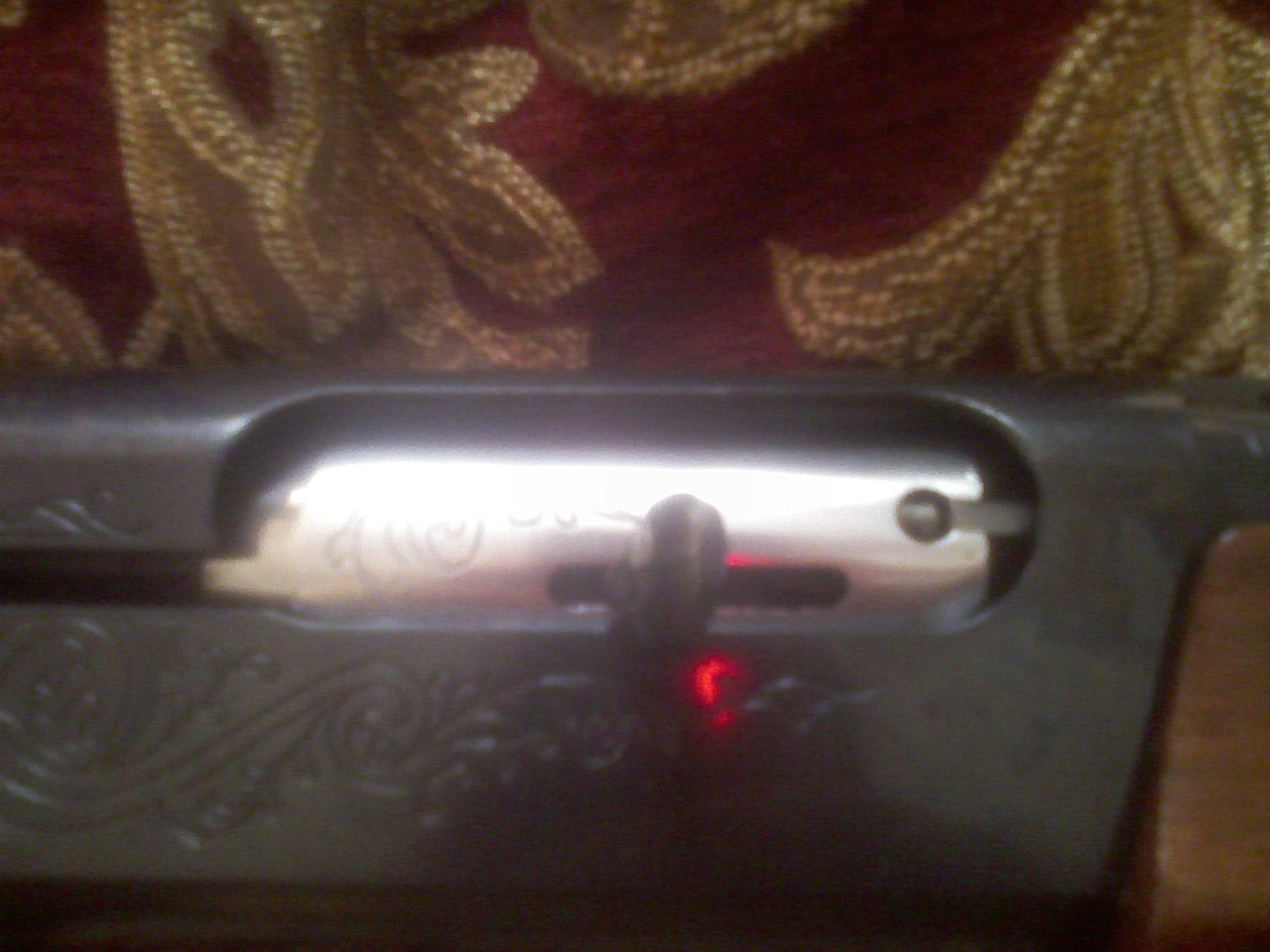

The extractor does line up with the extractor slot in the barrel, but the bolt does not close enough to seat it.
- This is in "firing position"
- 1100 Breach Problem.jpg (157.49 KiB) Viewed 4145 times
