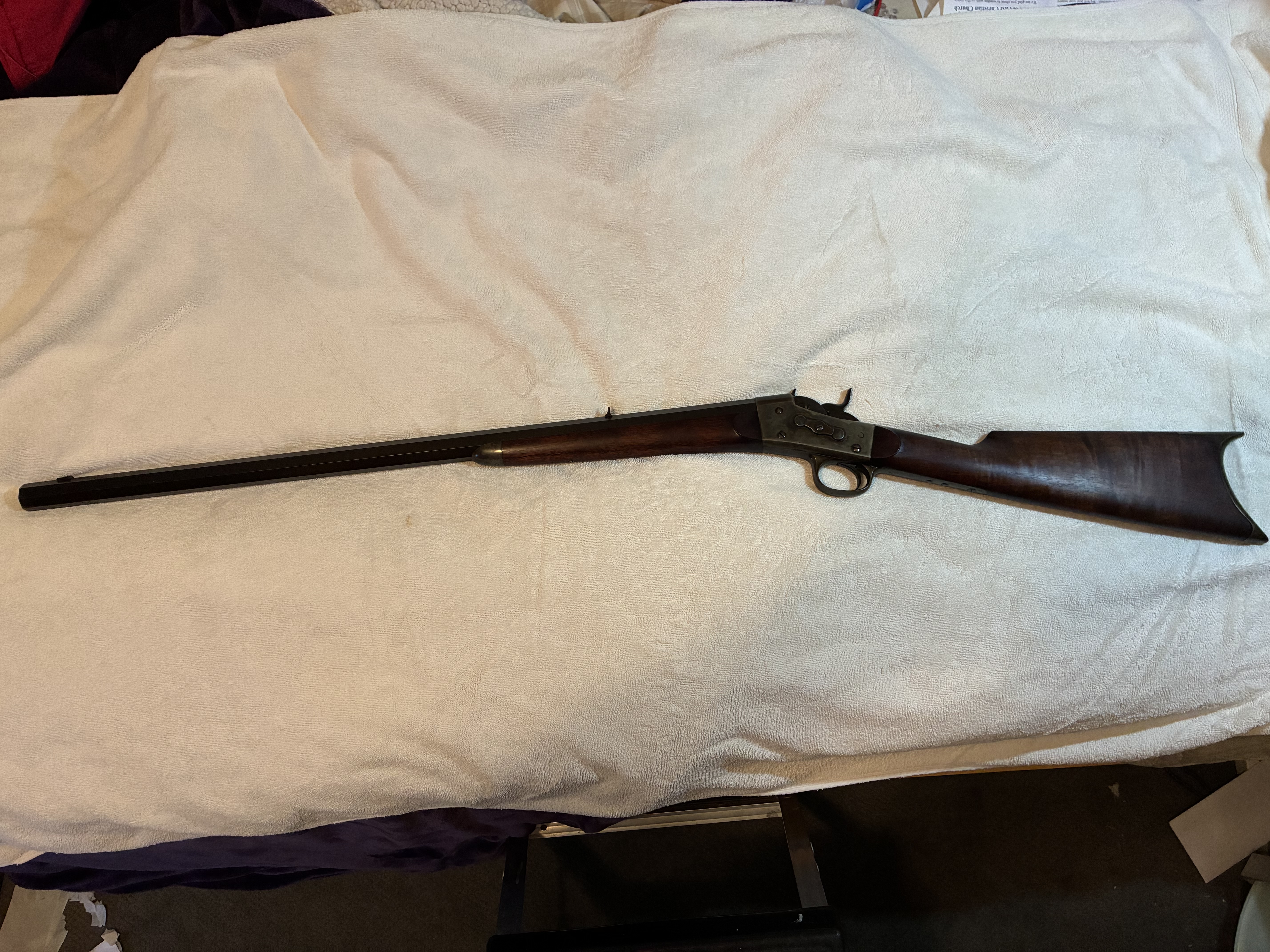

I think I have a pretty early #1 sporting rifle
Post by ODMMDO »

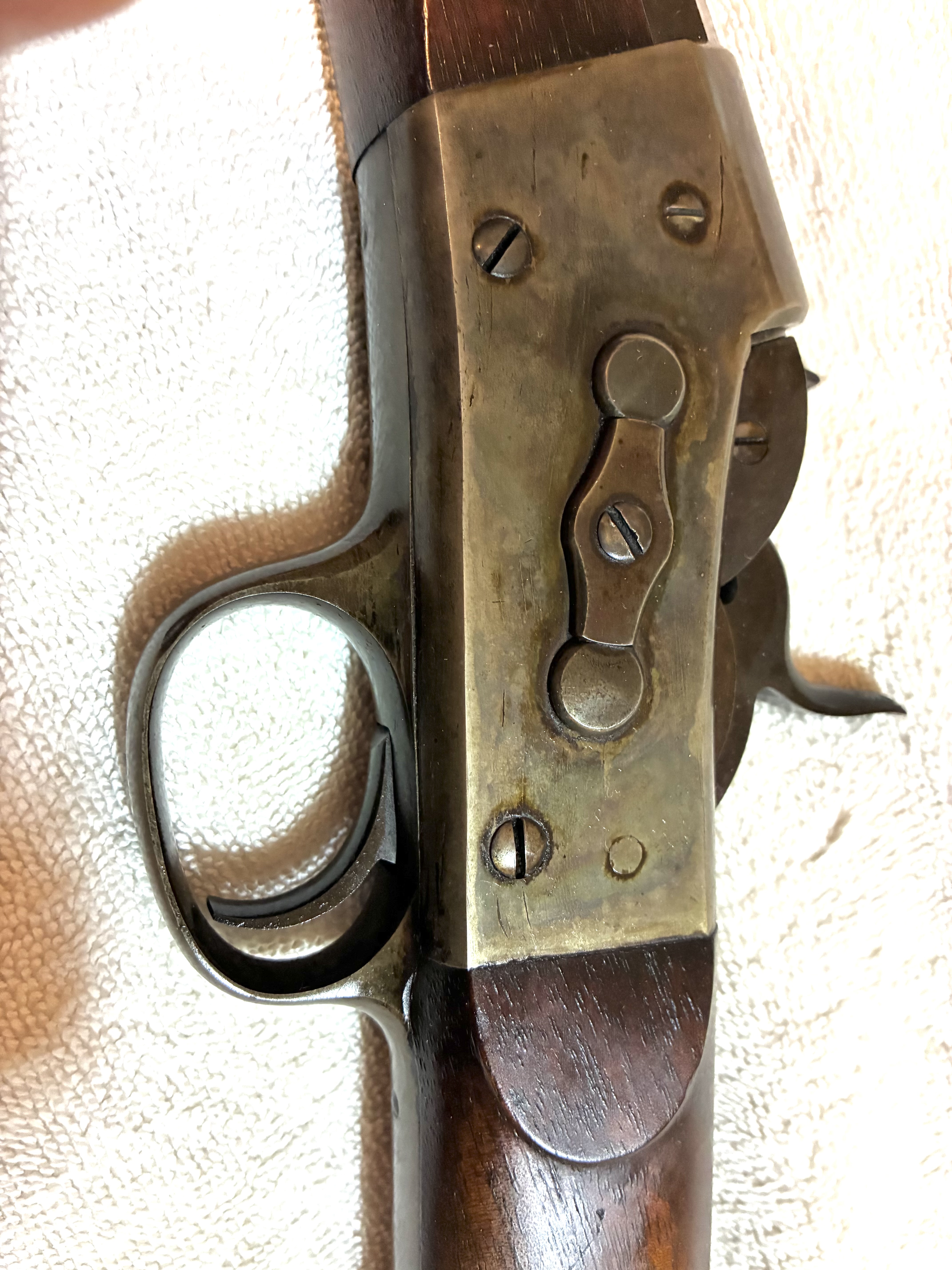

I know that you all will let me know if I’m right or misinformed.
I don’t know how many photos I can attach but here goes…

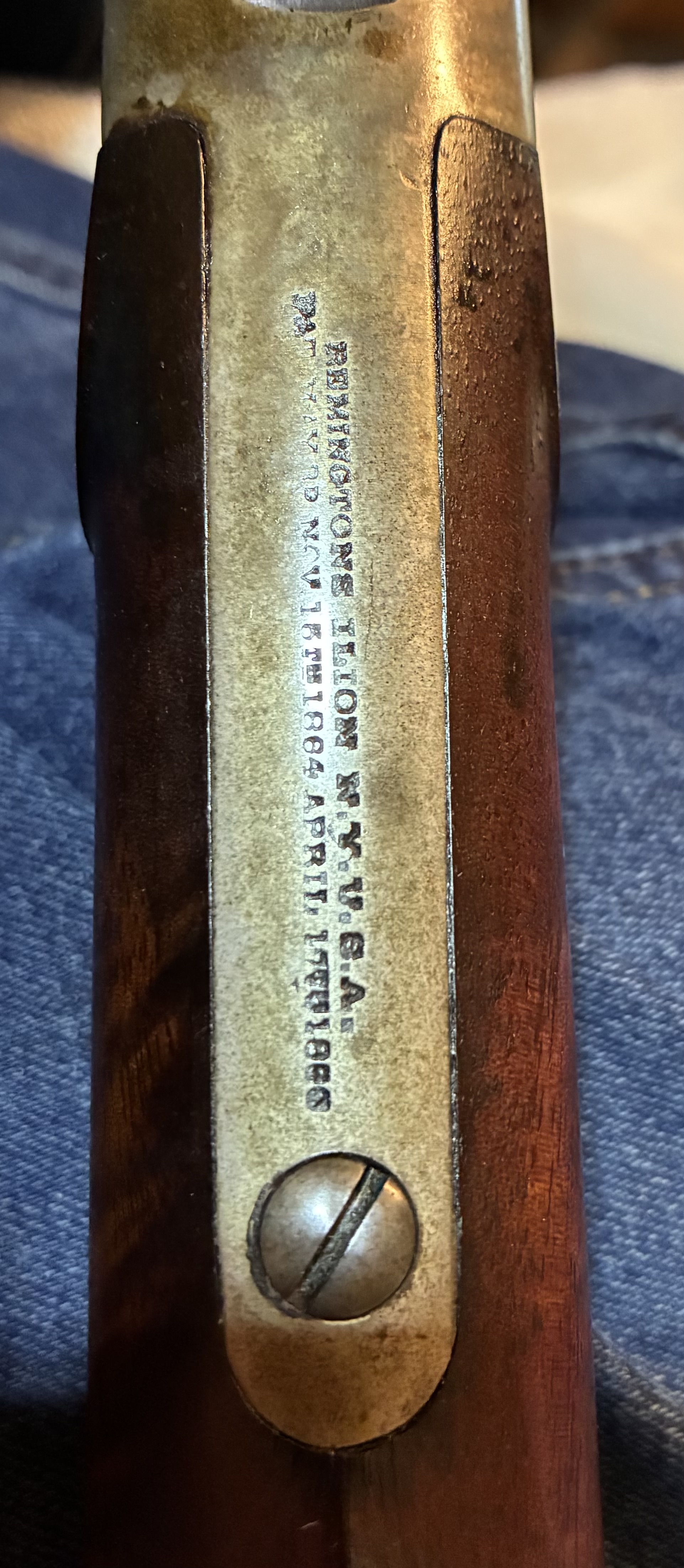

The only numbers or text that I see are those in the photos.

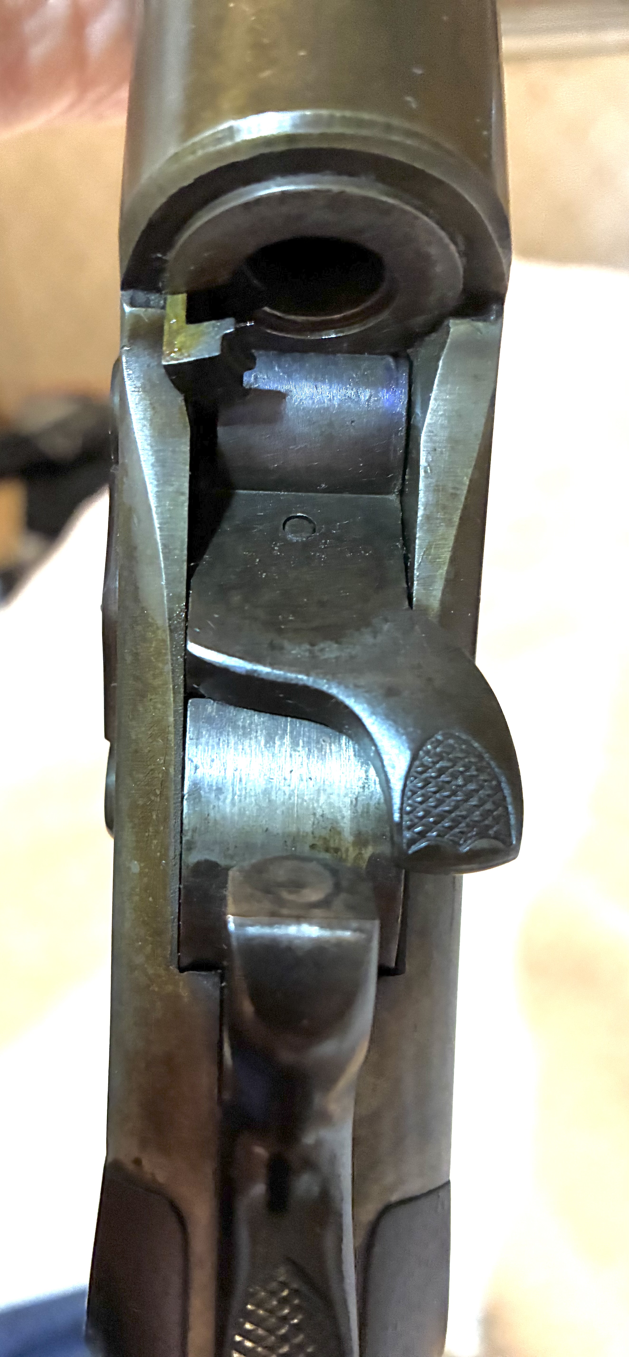

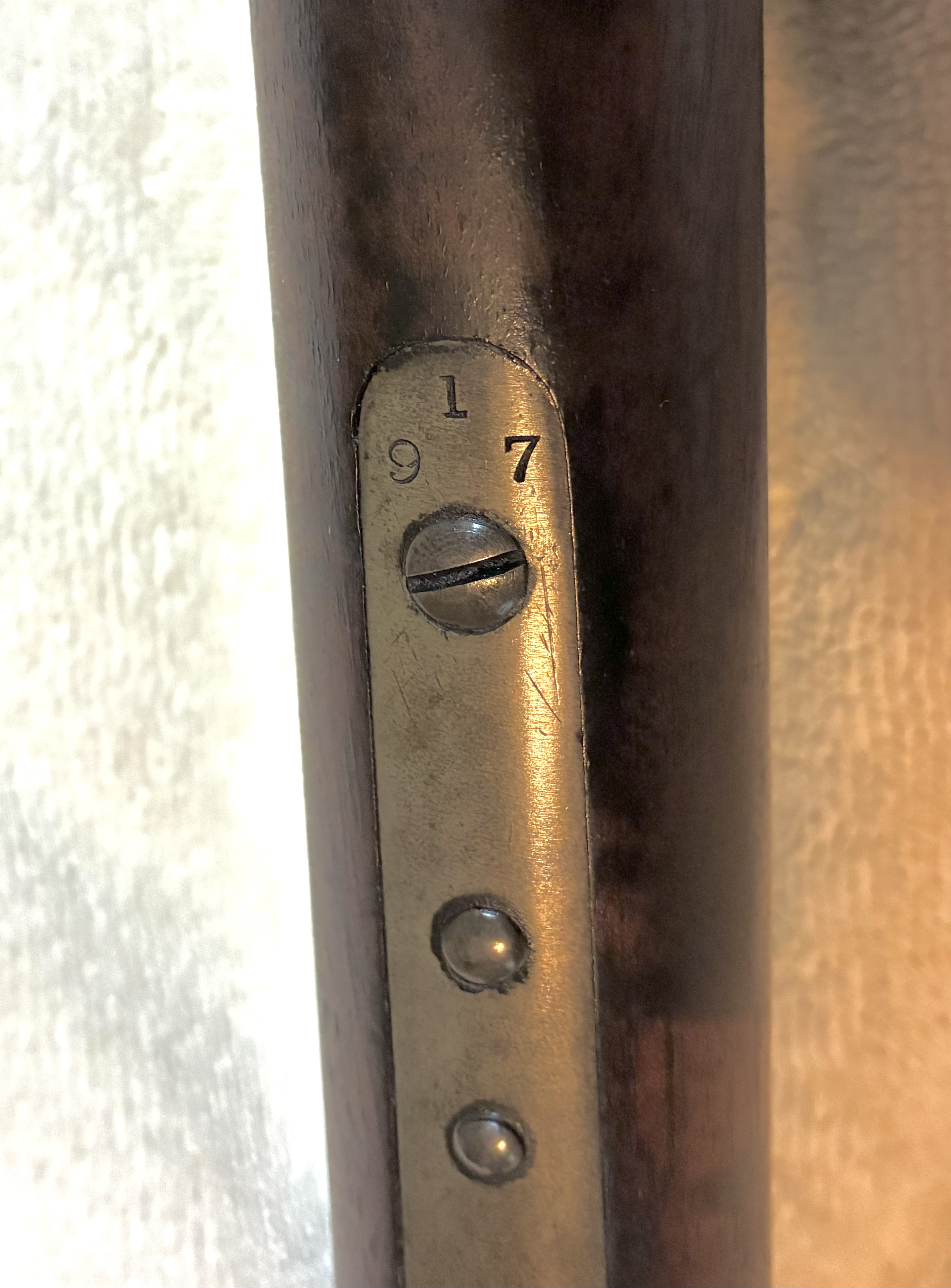

From what I have gathered from research on the Net, being the top of the receiver is round vs flats, indicates that it is early. Could the 917 be the serial number, I hope that it is. I have read about “assembly numbers” and don’t know if 917 is an assembly or serial number.

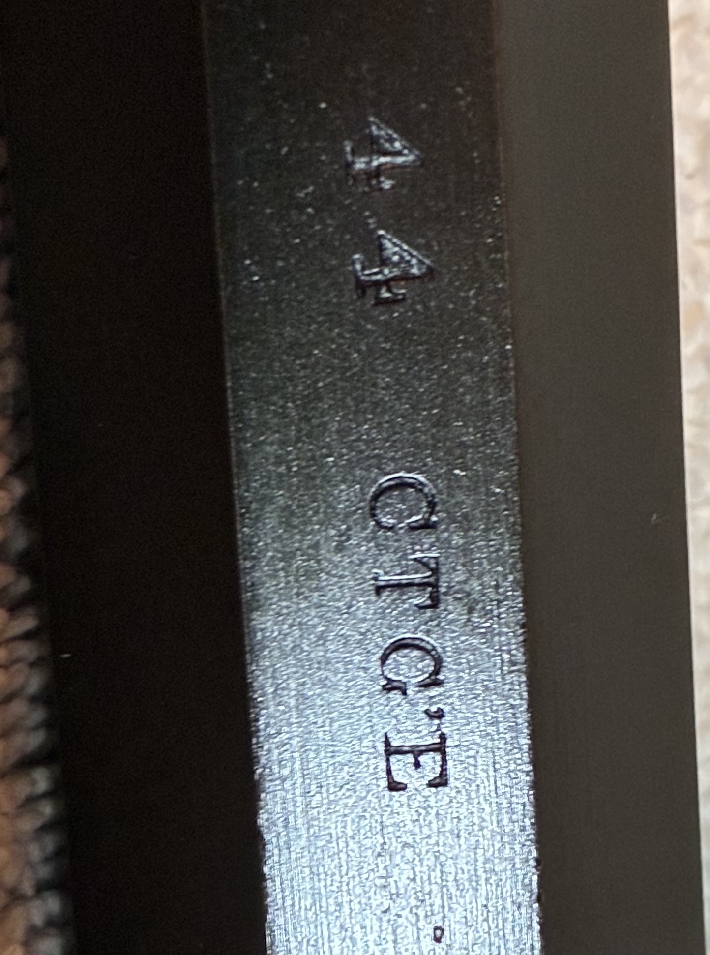

The 44 cartridge marking is on the bottom flat of the barrel. The only markings not shown in the photos is a dot on the top flat of the barrel that lines up with a strike mark on the receiver as though they were “line up” marks.
The lower tang is longer than the upper tang and there are no other numbers or text on the lower tang other than the “917”.
Thanks in advance for your insight!

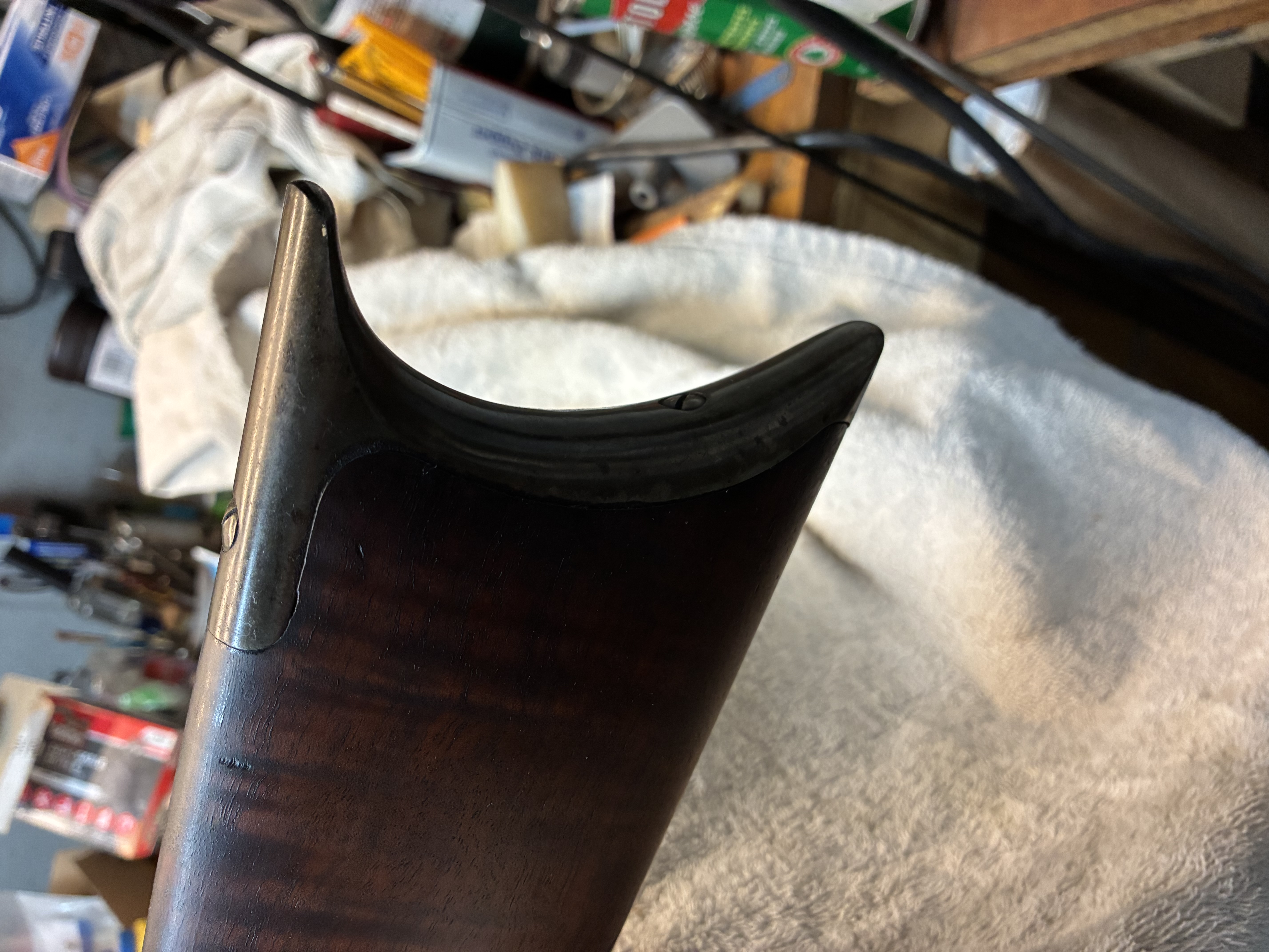

On a Sporting Rifle like yours the round top receivers, deep crescent buttplate, and rounded nose cap are all features of very early Rolling Block Sporting Rifles. The location of the serial number near the last lower tang screw is correct also, and not an assembly number as those were on the sides of the tangs on Sporting Rifles.
That's a very unusual way of stamping the serial number with the "1" above the other numbers. I've never seen any that were done this way? Have you removed the forearm yet to see how the serial number is marked there? It should match the lower tang, and maybe be in a row instead of staggered.

Thanks much Marlinman, I did go down to my shop and removed the forend screw. It gave some resistance but came out without any damage to the screw or the forend but the forend was not cooperating and I didn’t want to damage it so I replaced the screw.
I am curious but what with over a century of dried lubricants resisting my efforts, well I’m not so curious as to risk damaging the forend.
Someone else probably wouldn’t be so cautious but it would break my heart if I damaged it.
I have no intention of selling it, I got it for what I believe was a steal so I’m happy with it as is and your expertise confirmed my suspicions regarding its age. I’ve got a pretty nice piece and I’m happy.
Thanks much!

I wouldn't force it either, as it's not worth damaging the forearm. Have you determined which .44 it's chambered for yet? Could be a few options with the ".44 CTGE" marking from a .44 Long RF or CF, or a .44-77 Bottleneck, or a .44-90 BN.

Since it's a rimfire it should be a .44 Long RF as that's the only one I know of. That explains why it's in nice shape since .44 Long RF hasn't been made in many decades, so it sat unused.
