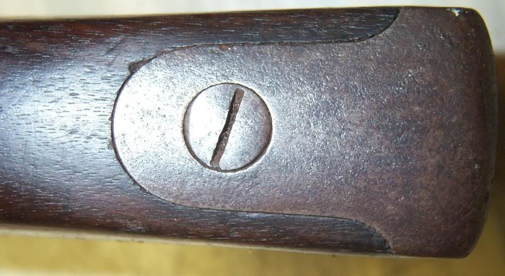

Are there any marks remaining on the buttplate tang? Can you provide photos of the open breech and chamber?

I'll try to get some close up photos of the tang and breech. The tang has a few markings still visible, but not much. I didn't see any markings on the buttplate such as "US" that I expected. I didn't see any other markings on the rifle. But I'll look again tonight and try to get some better photos.

Here is the buttplate tang, no markings that I can see.

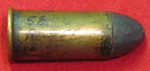

I found a couple photos of original .58 Roberts cartridges. After looking closely at this one, it does look like the bullet is larger than the case mouth, it may be a heeled bullet.
But then this one doesn't look larger than the case mouth, perhaps a different manufacturer?

I have to expand the case mouth slightly to seat the bullet. I was giving you an idea of what the fired case diameter would be, therefore a closer look at chamber dimensions, without the expander plug influence.
