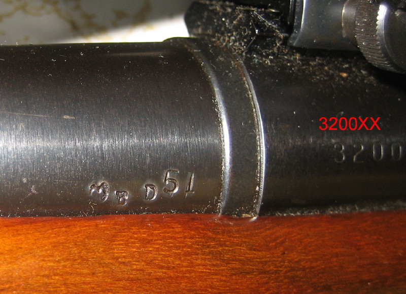

dugby
Re: 721 722 725 dates of mfg
I am trying to understand the date codes described earlier. It looks like they blew off the codes on this rifle and just stamped the year 1951. Is that correct?
- IMG_3057_1_3.JPG (149.95 KiB) Viewed 11622 times
