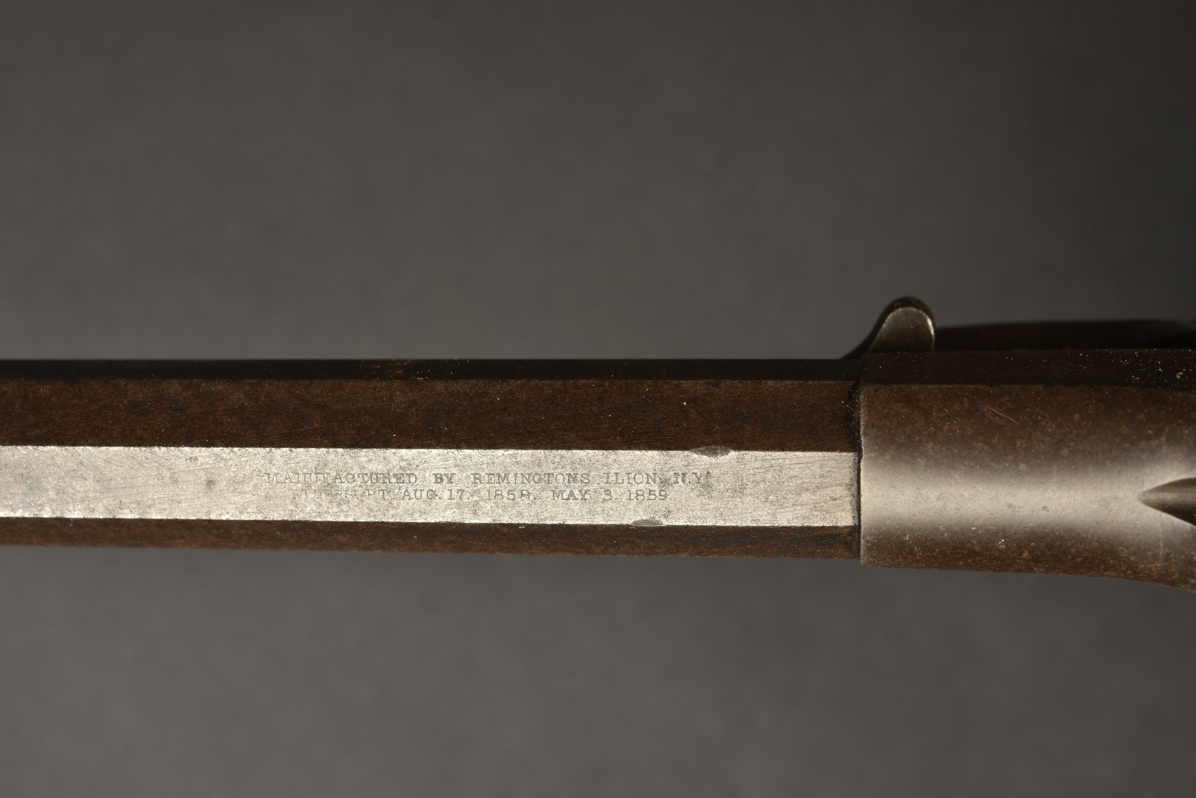

Hi C44L,
I have some informations for you :
Belt SA Model # 6012
(Serial number on frame and trigger guard has to be confirmed)
.36 caliber,
Round cylinder,
Barrel 6 ½",
Blade sight,
Barrel adress in 3 lines,
Finish unknown (the revolver saw heavy use, was heavily cleaned and badly restored),
Wood grips,
Stamps :
« J » on the upper rear portion of the trigger guard (left side),
« N » in front of the lever latch post.
Observation :
Some Belt revolvers has a hole in the handle (where the main spring is maintened by a through screw) but not that one.
I sold it some years ago but I can contact the new owner for more informations and photos, if you need.
I purchased a new one, #1069 and I can already give you some caracteristics waiting for its delivery for more details.
Belt SA Model # 1069
.36 caliber,
Round cylinder,
Barrel 6 ½",
Blade sight,
Blue Finish,
Wood grips,
Stamps :
« C » on the frame (under the percussion shield),
« C » on the upper rear portion of the trigger guard (left side).
Observation :
no hole in the handle - N°26 stamped on the left panel grip.
I hope it will help you.

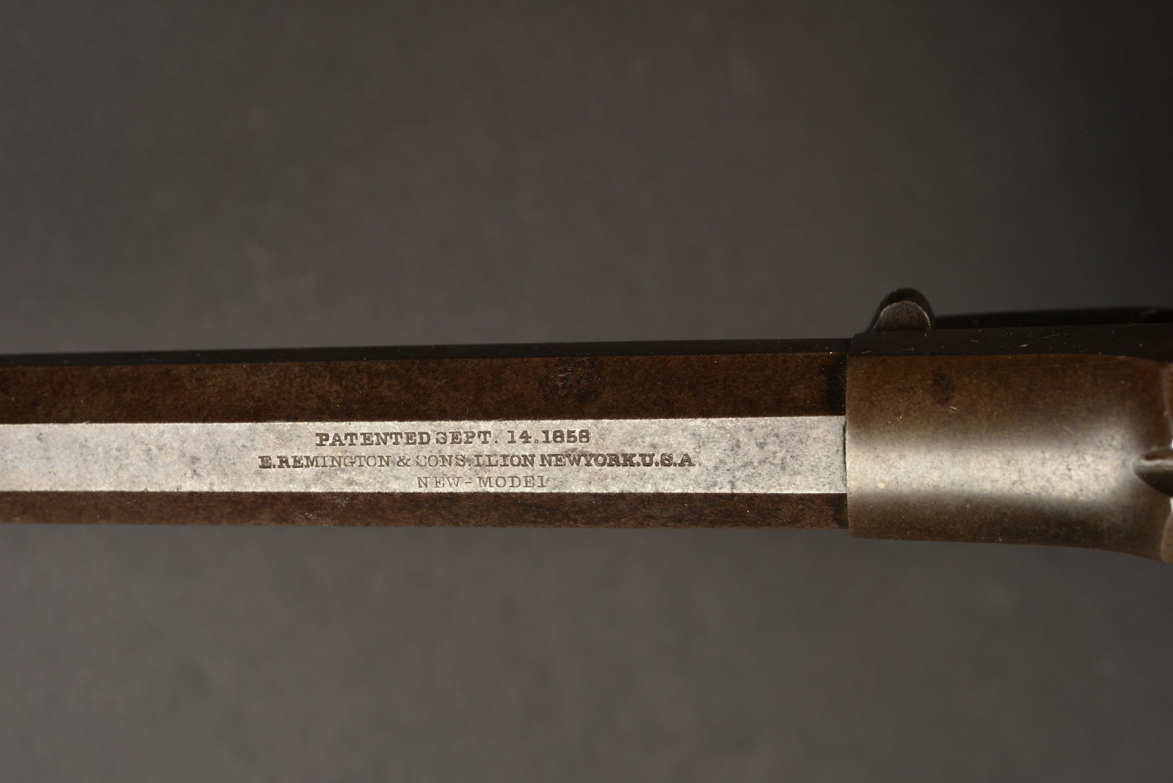

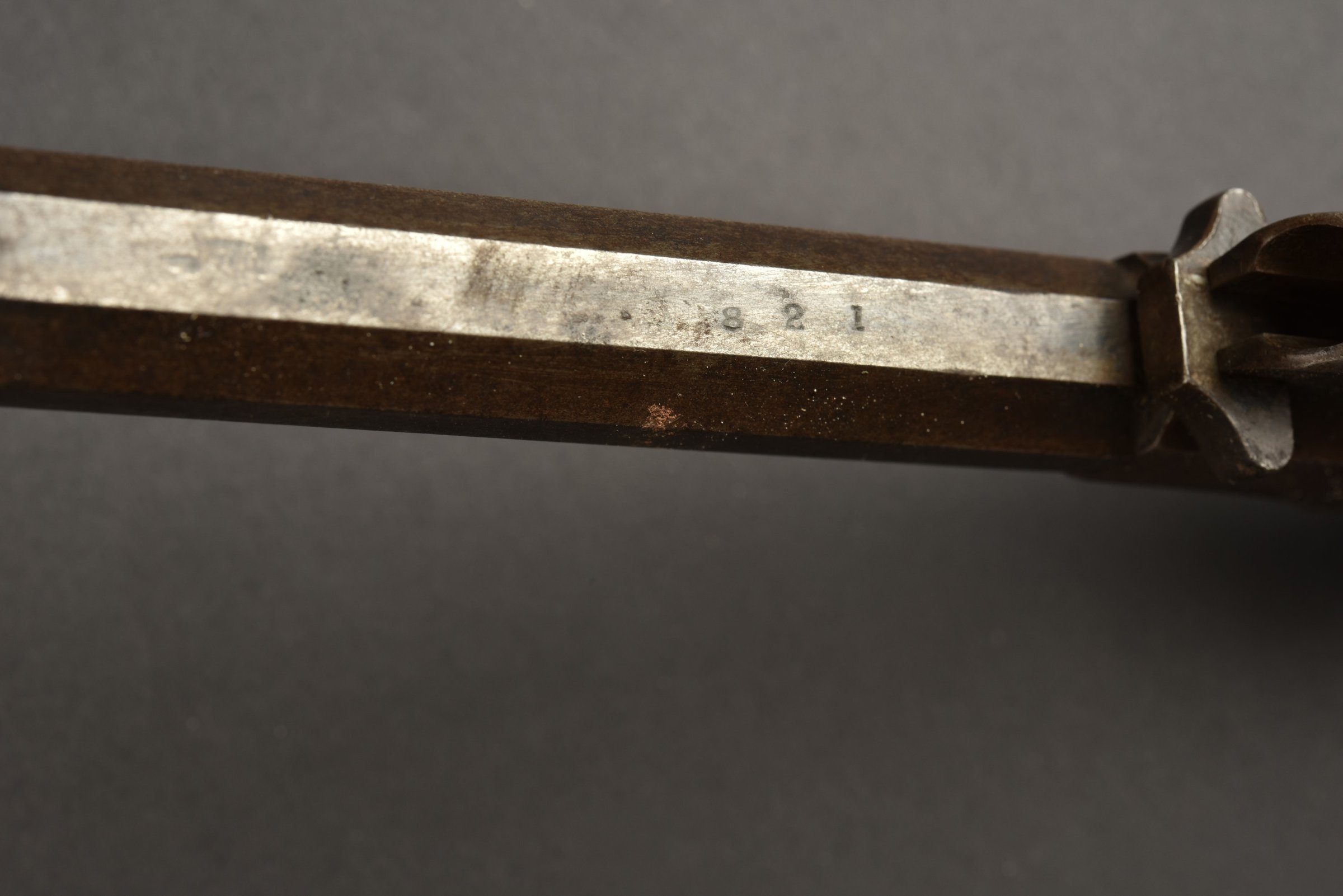

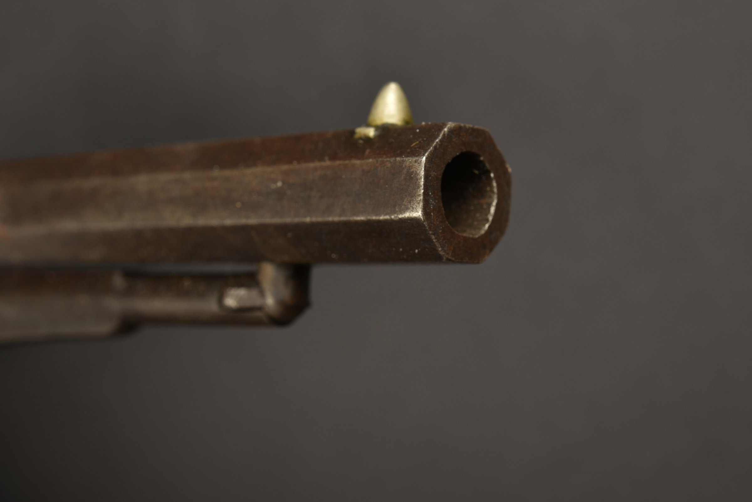

« Cerise sur le gâteau »
Rider DA Model # 821 - sold in France recently
# 821 (all matching number)
.36 caliber,
Fluted cylinder,
Barrel 6 ½",
German silver cone,
Barrel adress in 2 lines
Blue Finish ?,
Wood grips,
Stamps :
No stamps are visible
Observation : more photos and description
https://www.aiolfi.com/vente/2269-autom ... le-action/
Voilà,
Karu

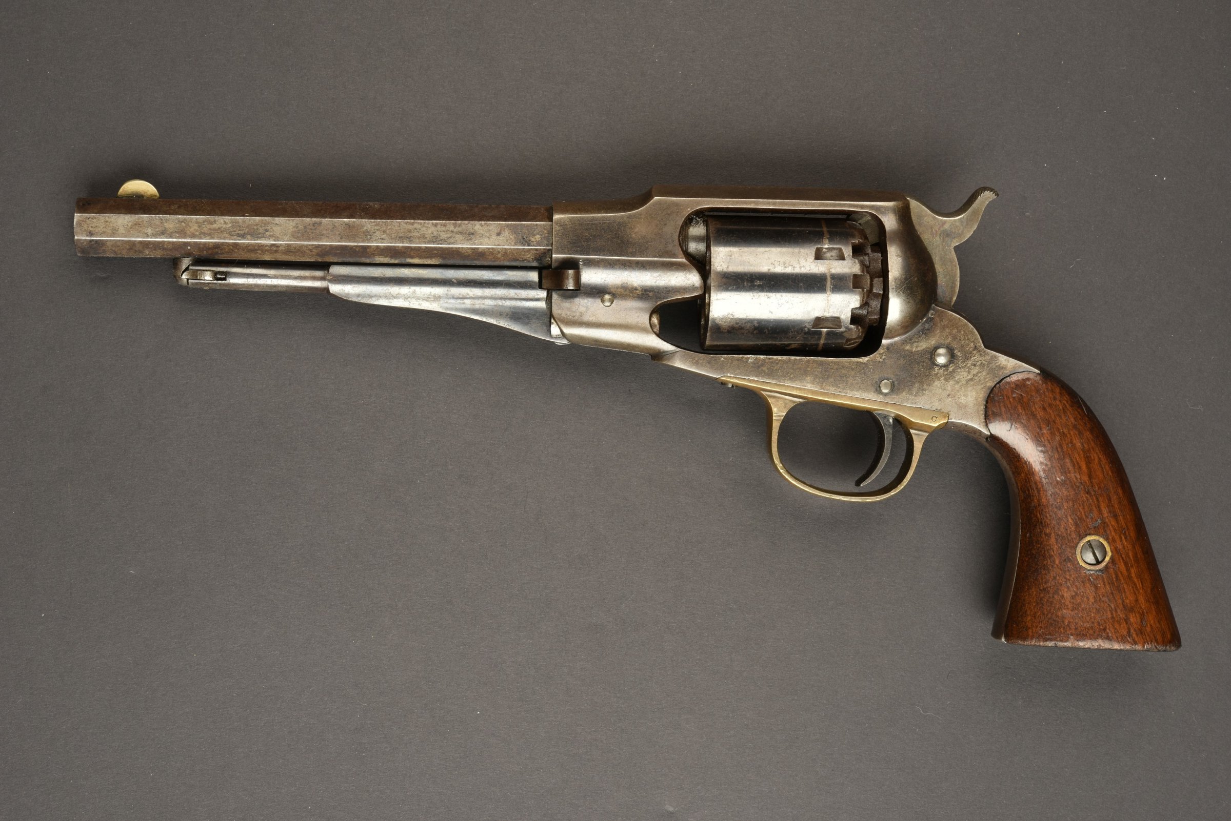

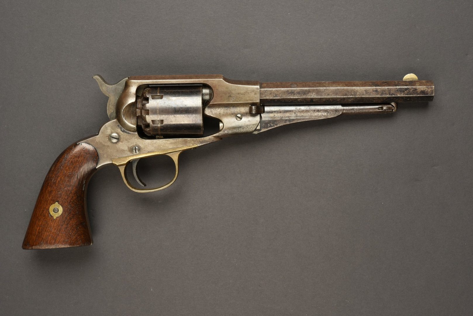

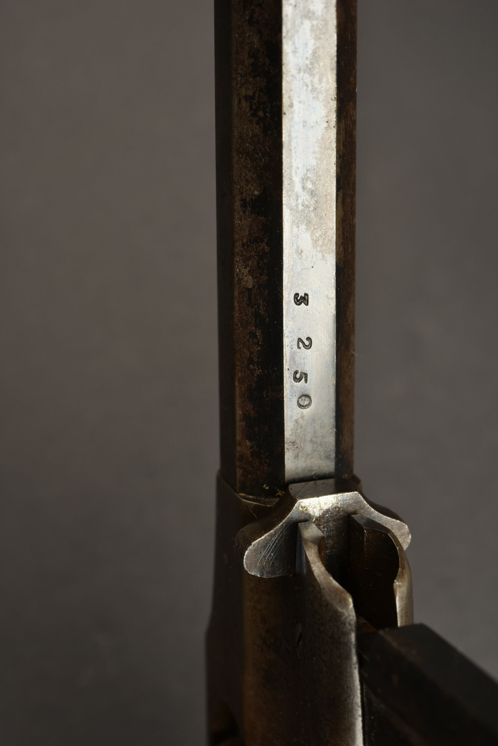

Another Belt SA Model from the same auction in France.
Belt SA Model
# 3250 (all matching number)
Percussion .36 caliber,
Rounded cylinder,
Barrel 6 ½",
Blade sight,
Blue Finish,
Wood grips,
Stamps :
I'm done for today..
Karu

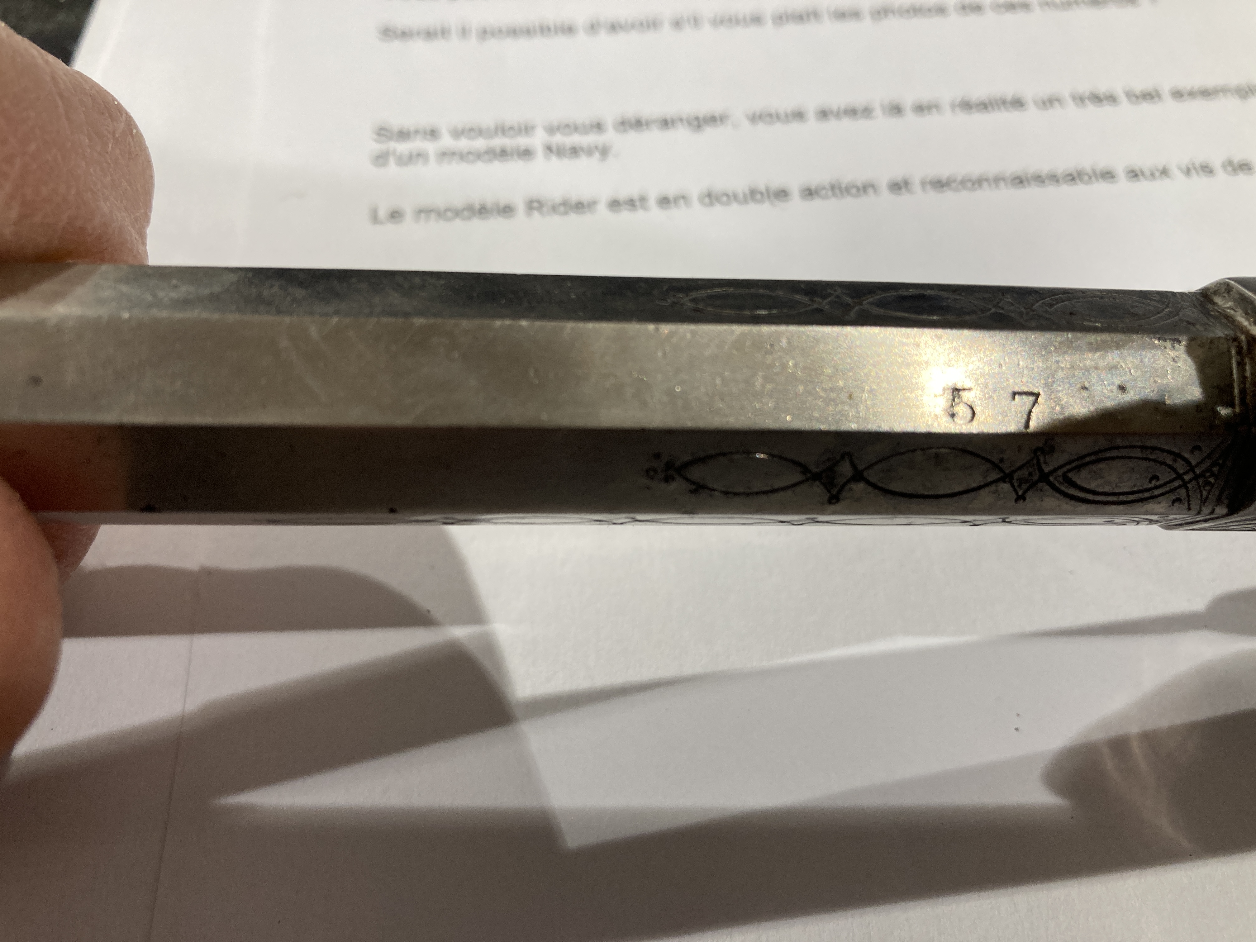

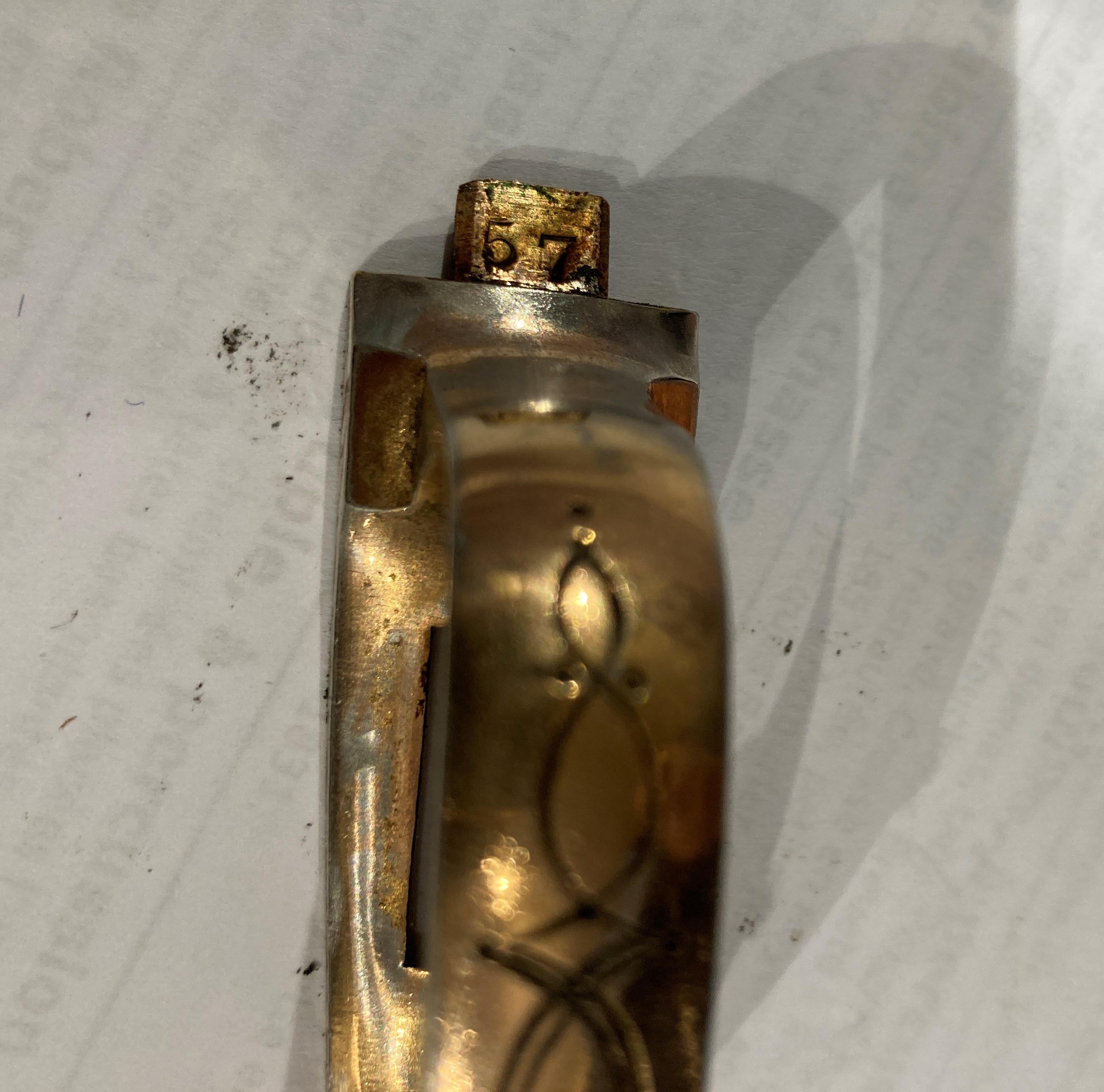

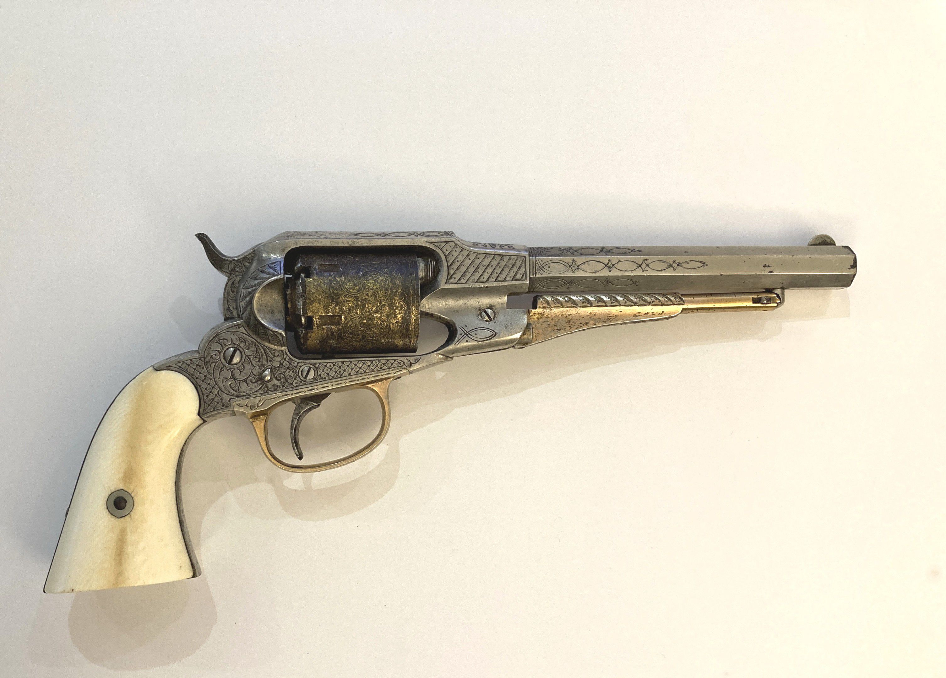

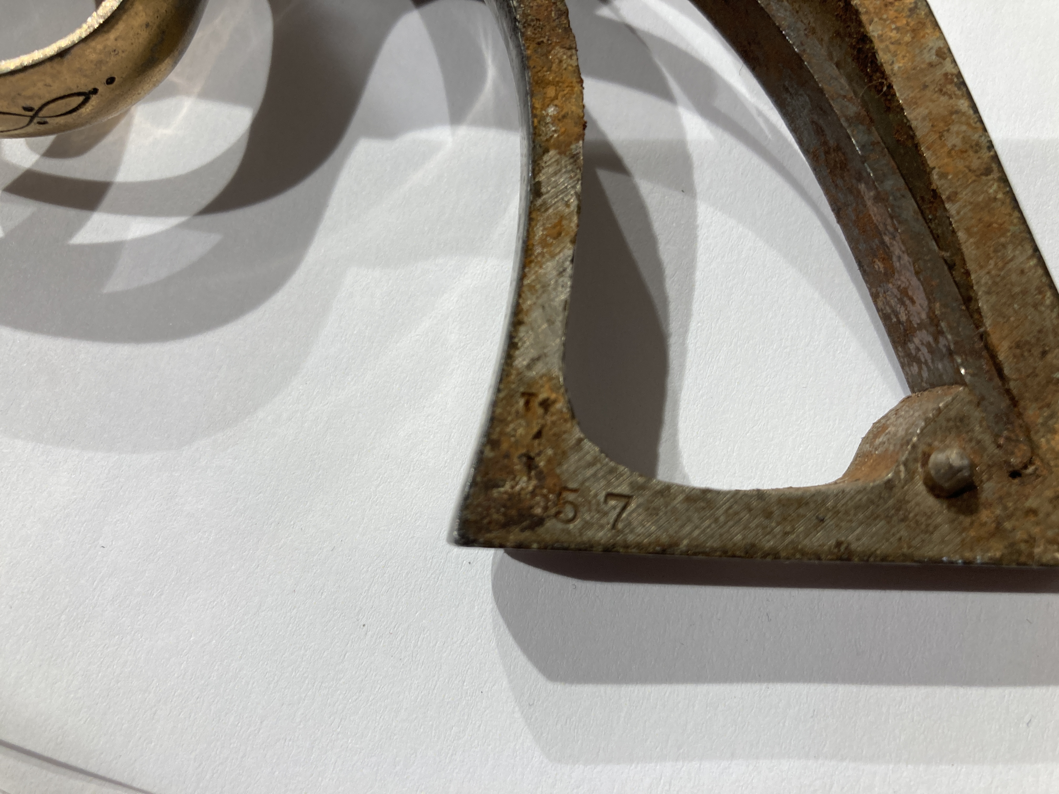

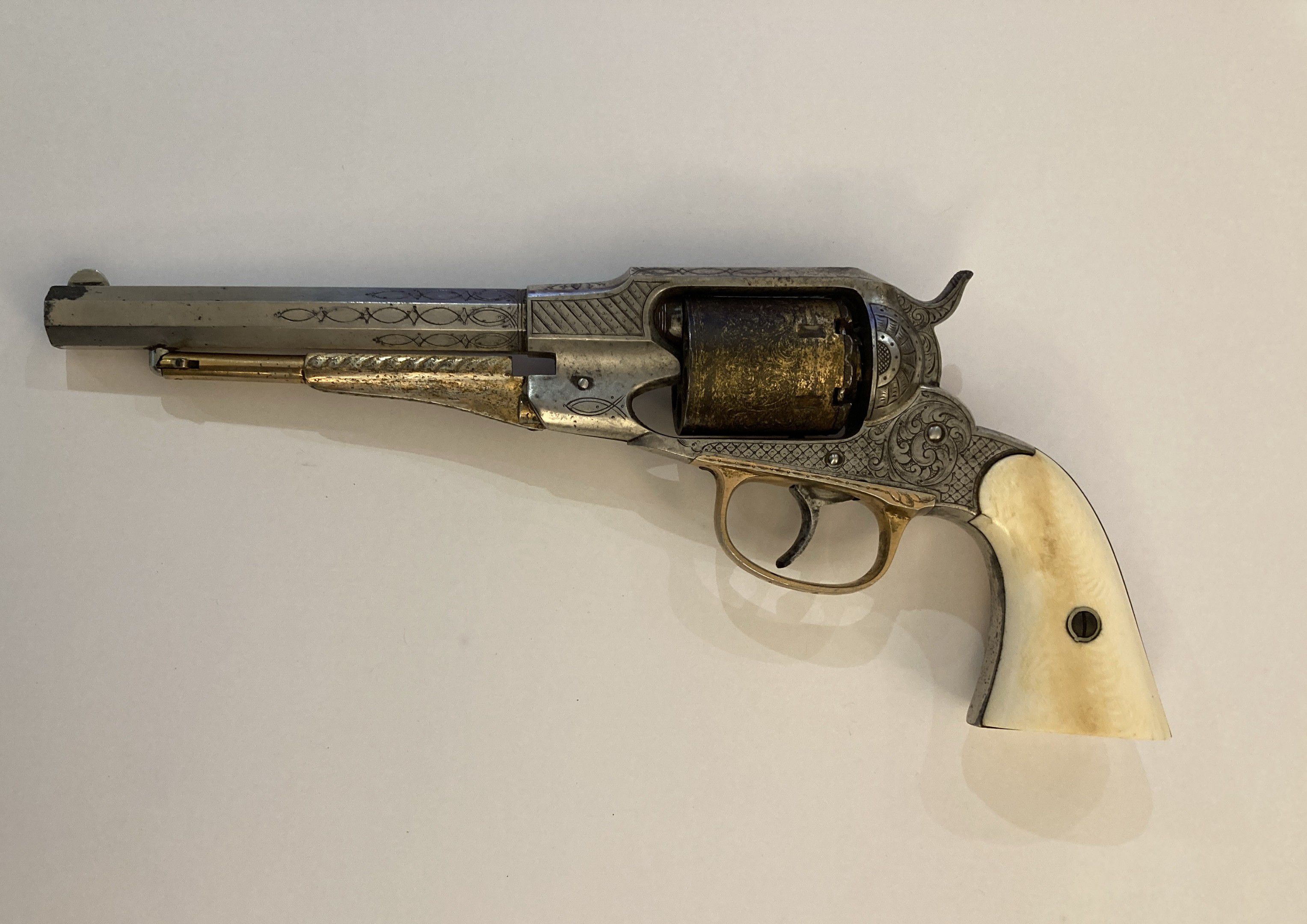

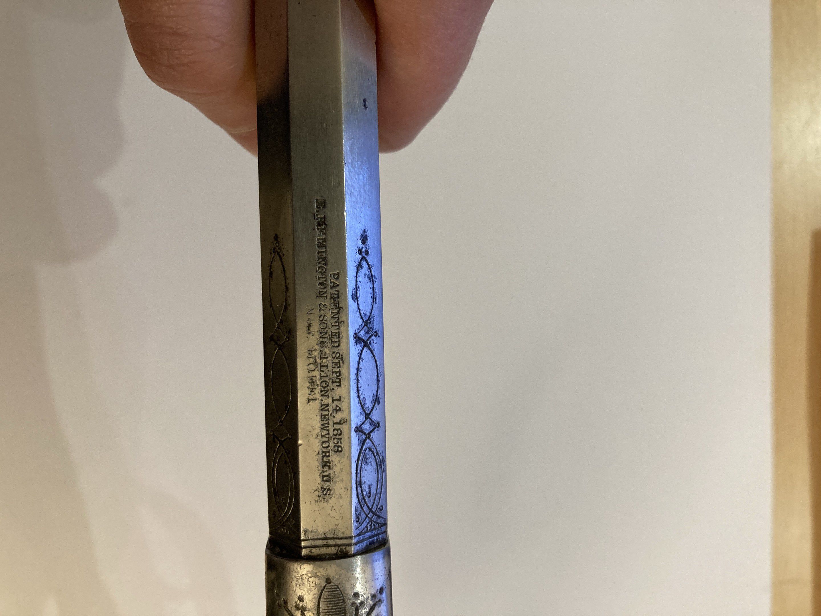

Hi,
A new one will be for sale in 2 days in Paris.
It's a DA model and the serial number seems to be #57.
Rider DA Model
# 57 ??,
Rimfire .38 caliber,
Rounded cylinder,
Barrel 6 ½",
Blade sight,
Nickeled/gold Finish ??,
Pearl grips,
Stamps : ??
All matching numbers!
This DA received a special finish which may explain the serial number..?
Do you think it was factory engraved?
Thanks,
Karu

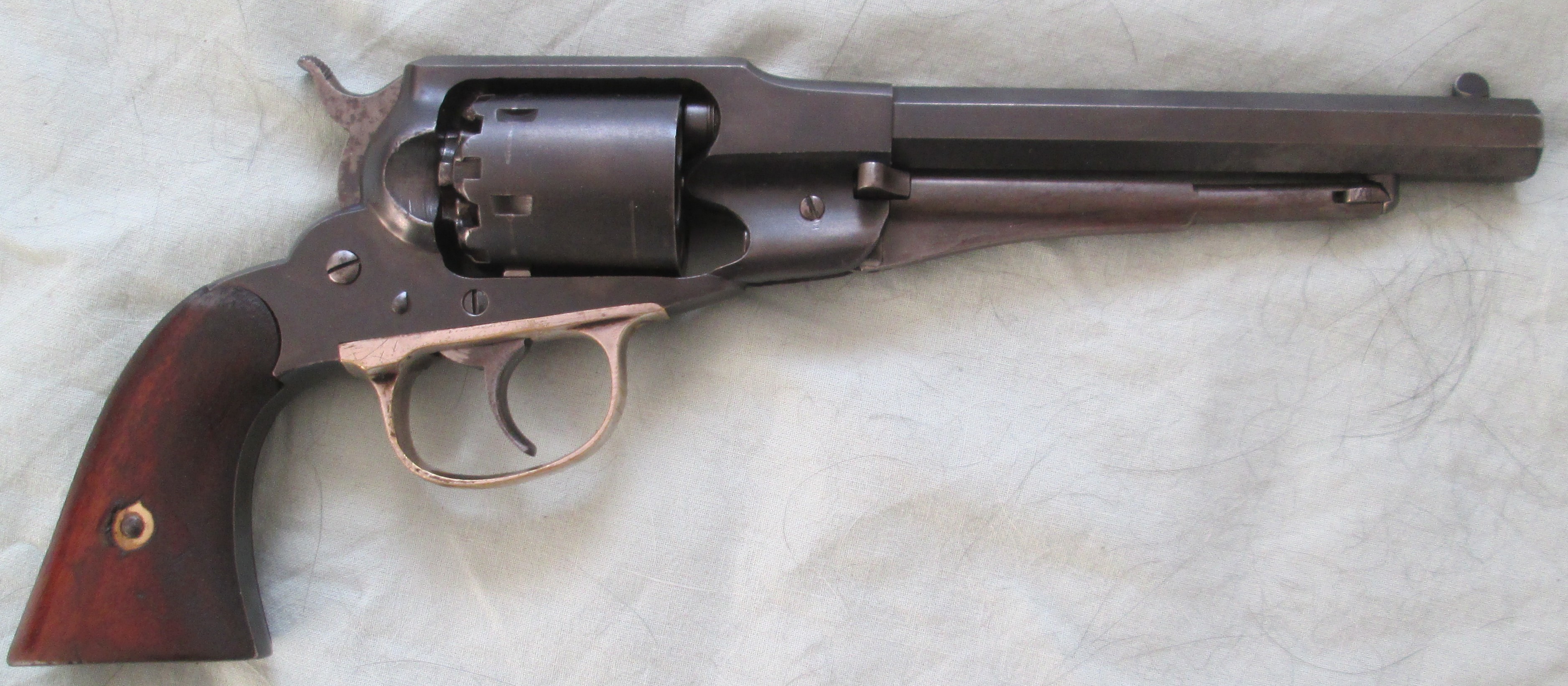

Photograph of my .36 Rider DA, serial number 1783
- RemRidDA.JPG (1.3 MiB) Viewed 23041 times

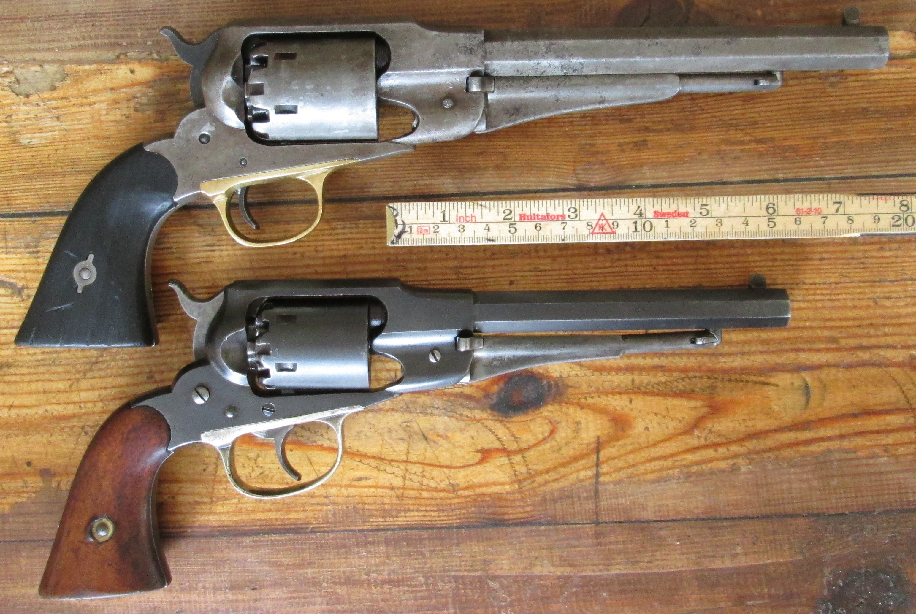

Mechanism
Size comparison with the 1858 New Army
- Mech1.JPG (1.47 MiB) Viewed 22981 times

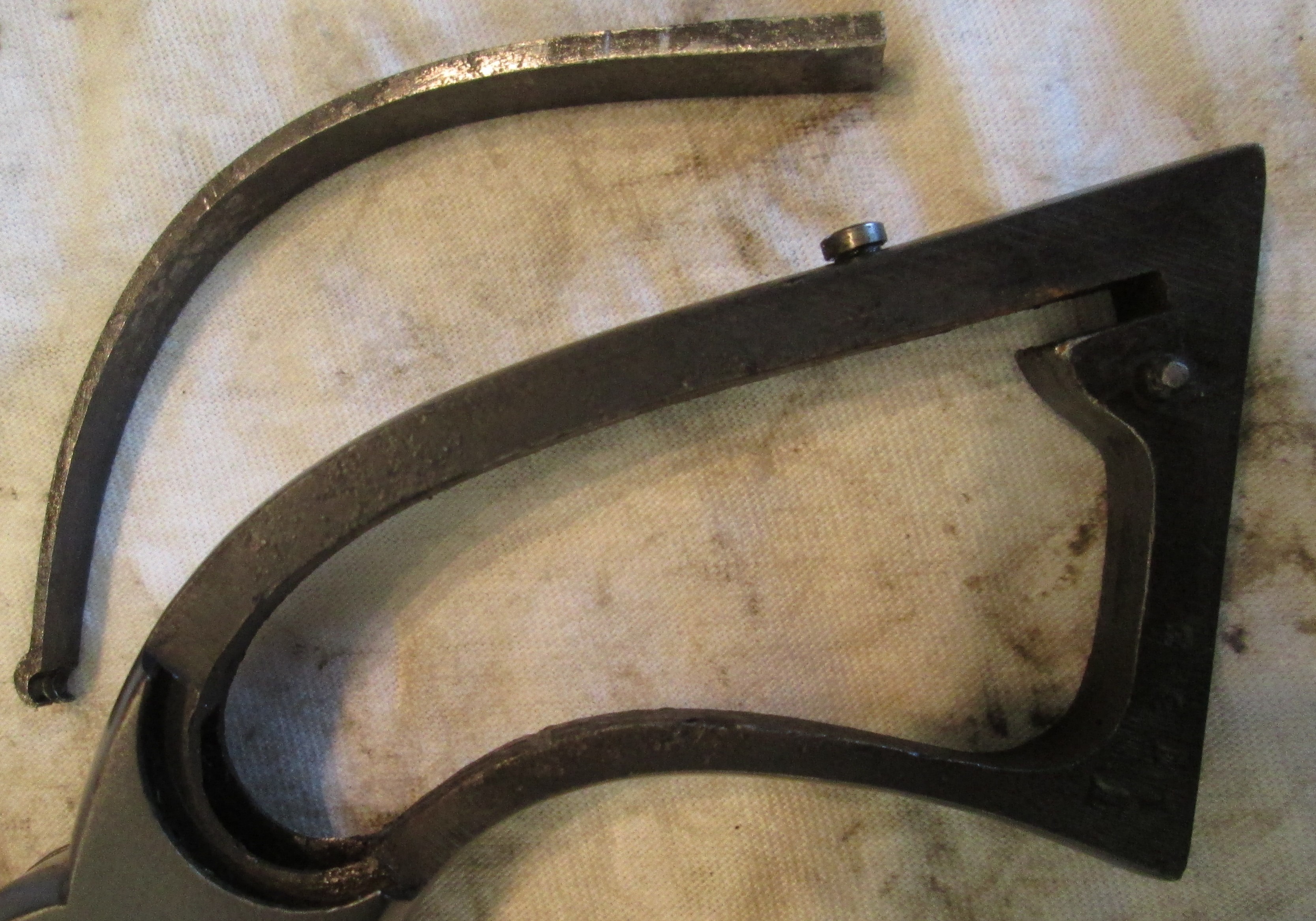

Re: RESEARCH PROJECT: BELT/RYDER REVOLVERS

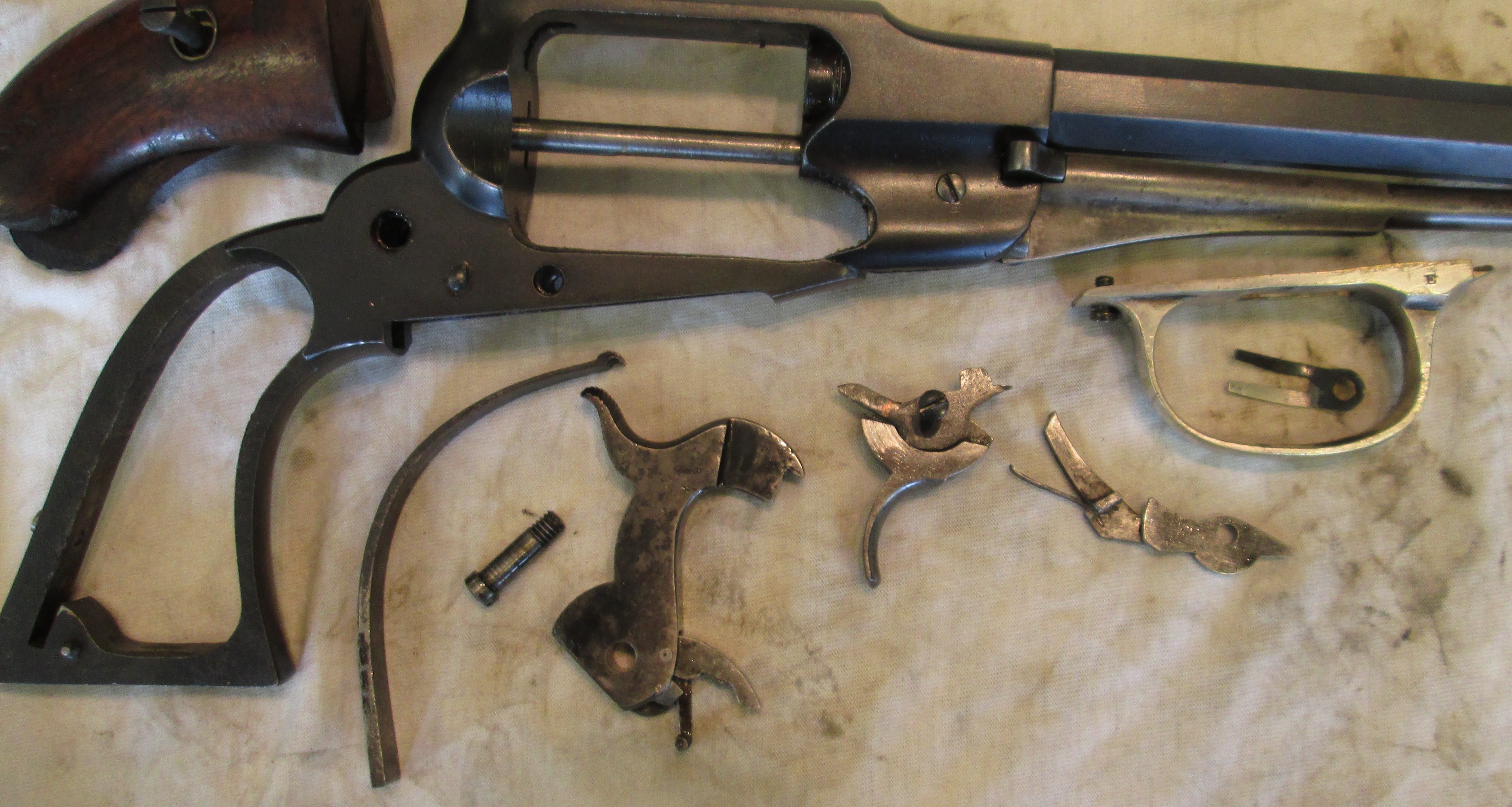

Mechanism
Main spring works the other way around compared to the 1858 Army.58, i.e. the spring is pulled up when cocking. Spring is stuck in at the back and held in place by a screw (from the back)
- Mech2.JPG (1.45 MiB) Viewed 22981 times

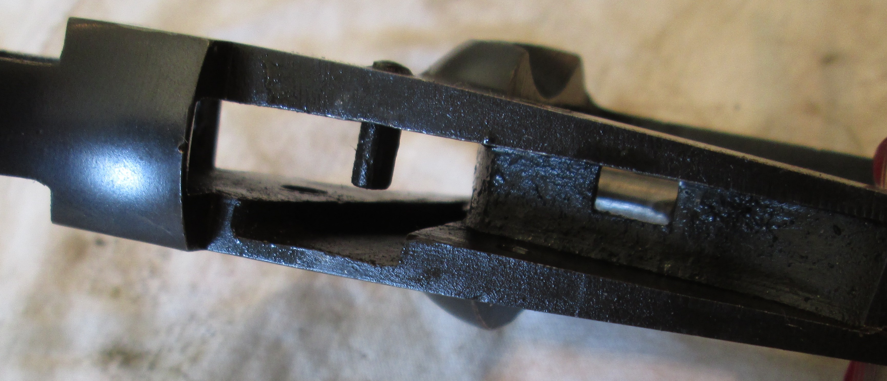

Mechanism
Mechanism recess seen from under. There's a rod going half way through the recess, for the release arm to be forced against
- Mech3.JPG (833.44 KiB) Viewed 22981 times

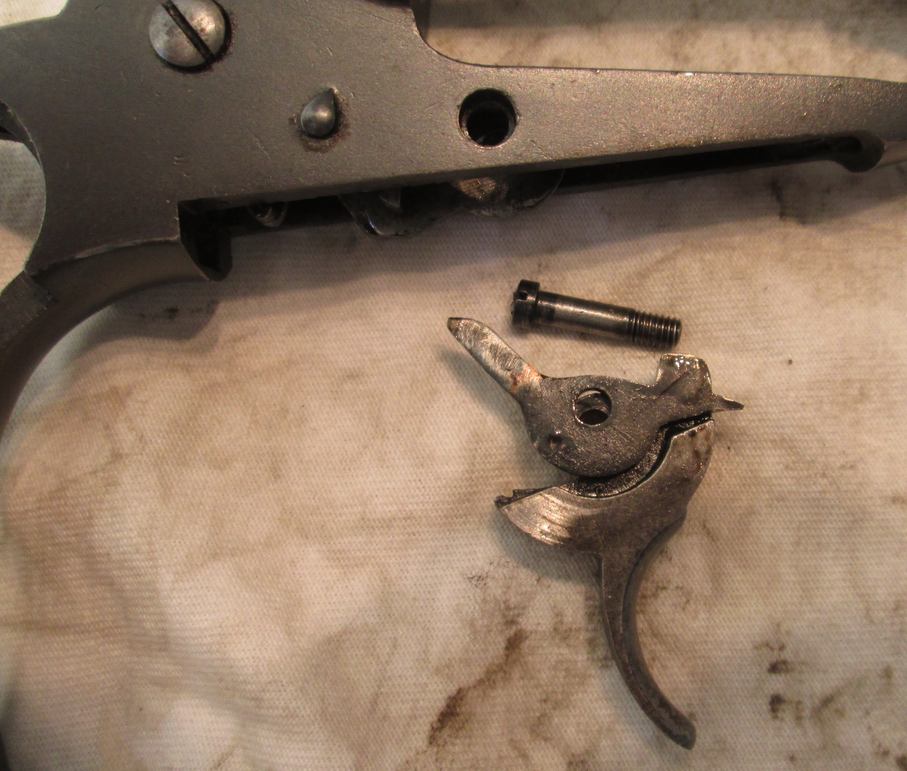

Mechanism
The trigger doesn't work directly on the hammer sears. Trigger got a cradle for the hand and push thingie. See next post.
- Mech4.JPG (1.4 MiB) Viewed 22979 times

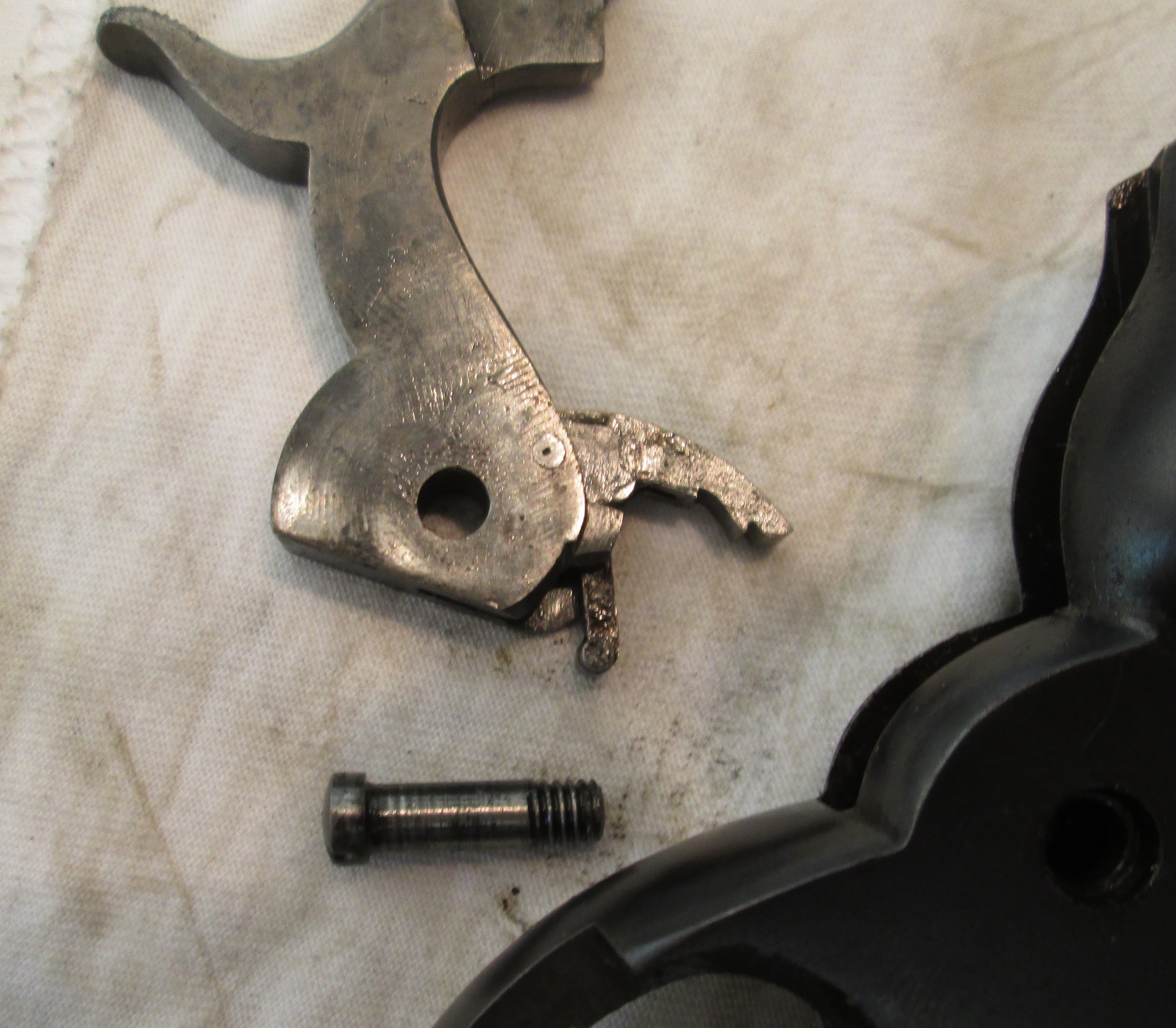

Mechanism
Hammer got one hinged push rod with sears at the bottom, and on that rod is also hinged the main spring pulling rod (to the left in picture).
The sears rod goes behind the half-way-through rod seen in picture Mech3.jpg above. The half-way-rod prevents the trigger-pusher to slip off the sears rod.
- Mech5.JPG (1.22 MiB) Viewed 22979 times
