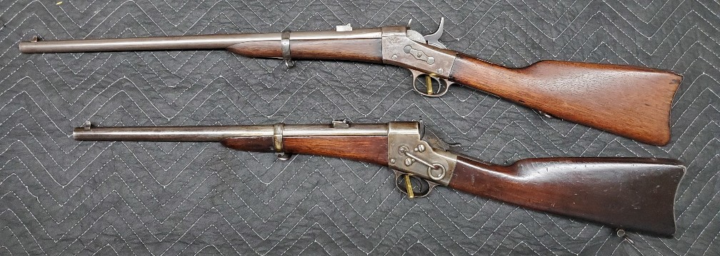

According to the same article in The Gun Report from Nov 2005 the sample carbine provided to the Bureau of Ordnance was based on Remington's standard .50 Spencer rimfire model. This one was not accepted and the advise was to keep the grooving, twist etc but increase the barrel length 4", the sight to have a graduation for 200 yards and swivels for sling bands to be attached to all arms.
I have no idea whtat the rifling of such a Spencer carbine was.. Anyone on this forum??
I will stick to my plan to get a mold for a 430-450 grain bullet that should give a stabilized bullet with this barrel configuration. It is always possible to make the mold shorter.

Post by ndnchf »
If their report referred to "Remington's standard .50 Spencer rimfire model", then that would be the split breech carbine. Here are mine together. Note that my navy carbine is a put together version with an original navy barrel.
