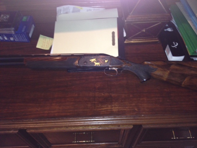

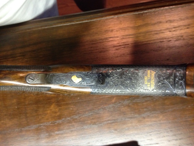

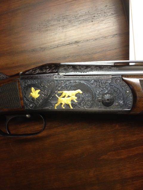

Pictures of the 32F - Sorry for the picture quality!!
- IMG_0251[1].jpg (107.26 KiB) Viewed 12906 times
- IMG_0250[1].jpg (97.96 KiB) Viewed 12906 times
- IMG_0249[1].jpg (95.04 KiB) Viewed 12906 times

The attached photo is poor at best buy at least gives outline of checkering.
