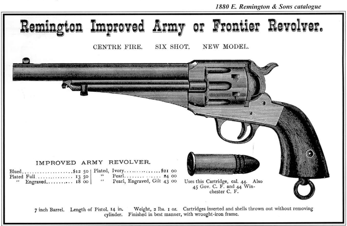

Remington used several names for this model
during production. In addition to the two names above, the
1877 through 1880 Remington catalogs referred to the
revolver as the “Remington Improved Army”. In the
catalog it is called “Remington Improved Army,
or Froutier Revolver”.

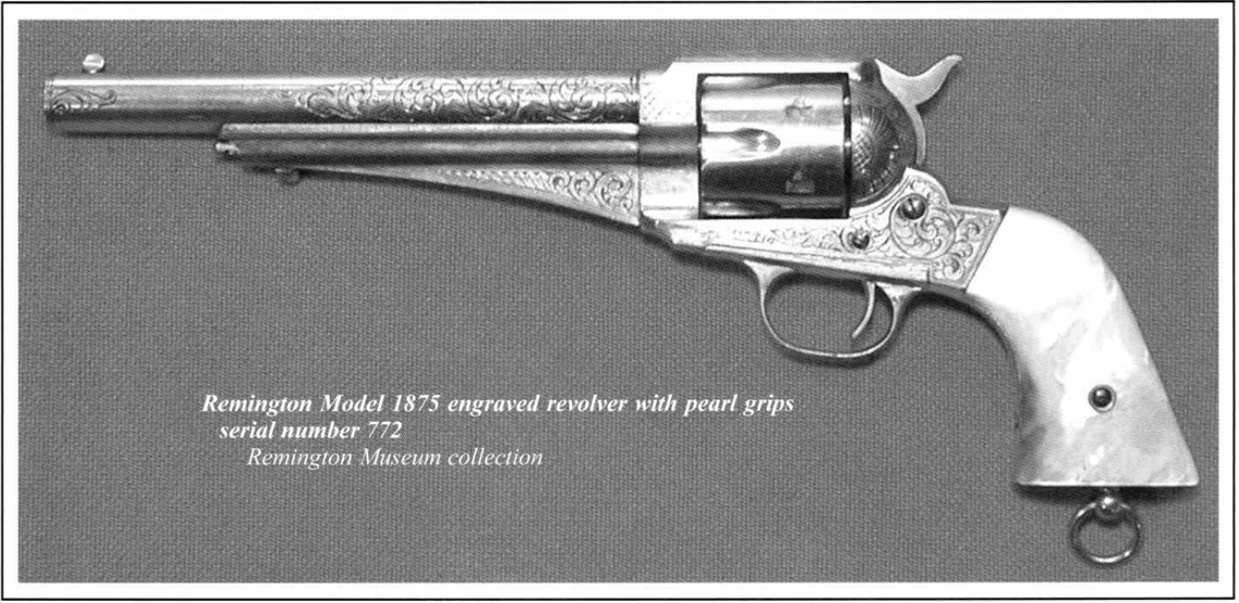

Photograph above Remington Model 1875 revolver with special, deluxe checkered grips.
Tower of London collection

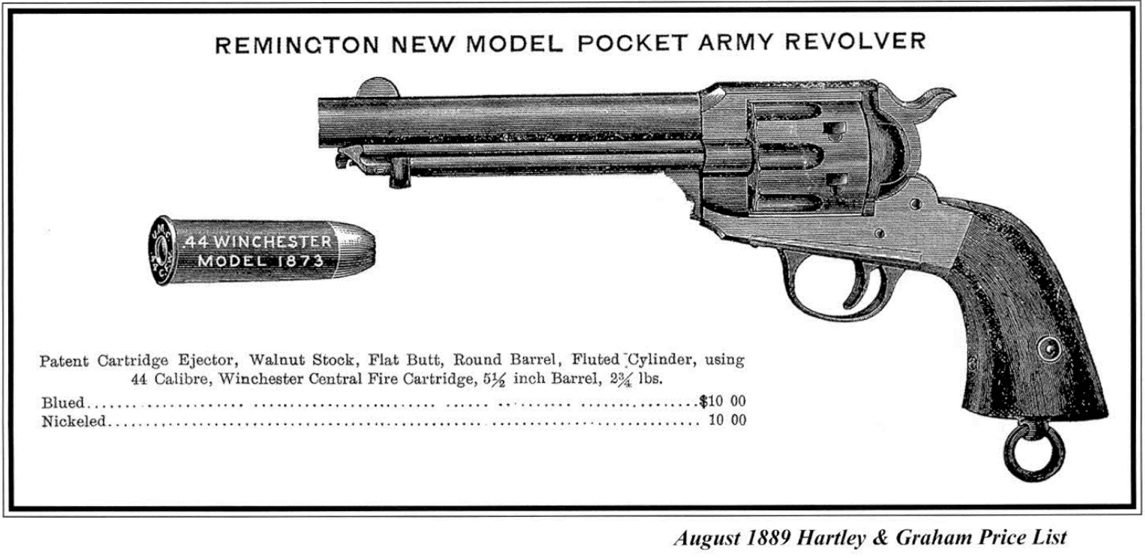

Until the last decade, this model was a stepchild in
the Remington family of revolvers. Looked on as a gun-
smith alteration of the Model 1875 by collectors and dealers
alike, the revolver was finally exonerated in the 19903 by
the discovery of a rare advertisement in an equally rare
1889 Hartley & Graham catalog. This Remington revolver
was offered only in .44 WCF caliber in a
5.75-inch barrel version, as the Remington New Model
Pocket Army Revolver.

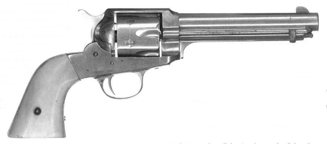

After the controlling interest of the Remington
firm had been acquired by Marcellus Hanley in June 1888, new
management had noted a large lot of
Model 1875s gathering dust in inventory. Some of these
had evidently been on the shelves for several years.
A new revolver was designed, and the old stock of
arms were altered by shortening the barrel to 5.5-inches,
and milling offthe web on the ejector housing.

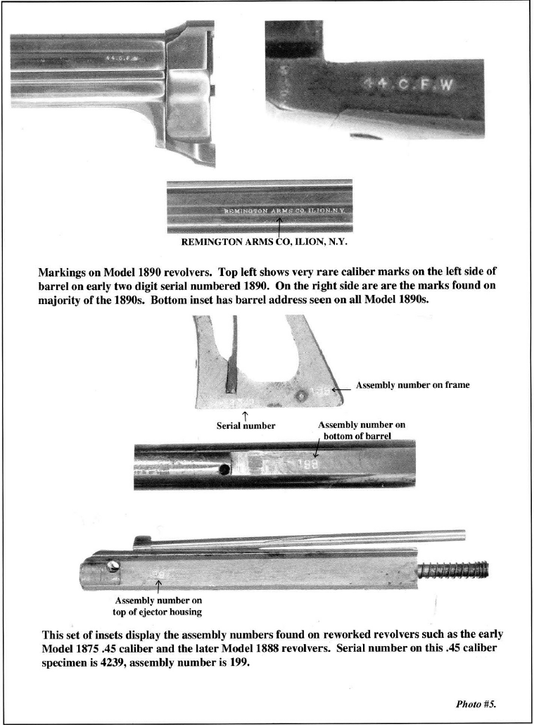

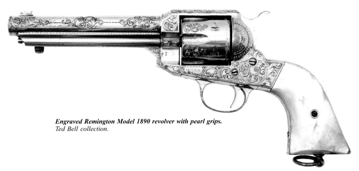

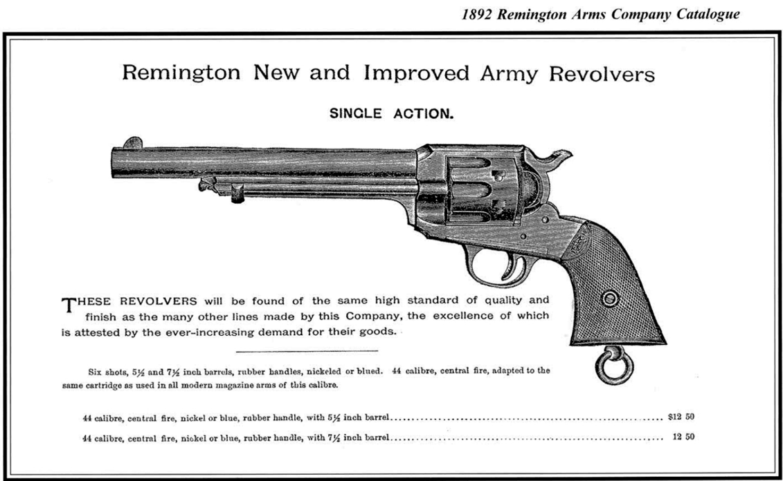

The Remington Model 1890 Revolver
Mechanically, the Model 1890 revolvers are identical to the Model l888s.
There was a different barrel address which reflected new ownership of
the Remington firm: “Remington Arms Co. llion , N. Y.” This new model
was also offered in two barrel lengths, 7 and 5 inches. Another departure
was the use of molded hard rubber for the grips. These were
checkered and had a Remington Arms Company logo at the top.
This model was available in one caliber only, the .44-40 Winchester
center Caliber markings have been seen in two locations. A few very
low serial numbered guns have the caliber stamped on the left side of
the barrel as “44 WCF”. The location of this stamp was soon moved to
the lower left side of the frame, beneath the cylinder.
Sales of the new Model 1890 revolver must have been disappointing, as
production ceased after only two years.
Factory records indicate that only 2,020 Model 1890s were shipped.
Page 19 1st Quarter 2004

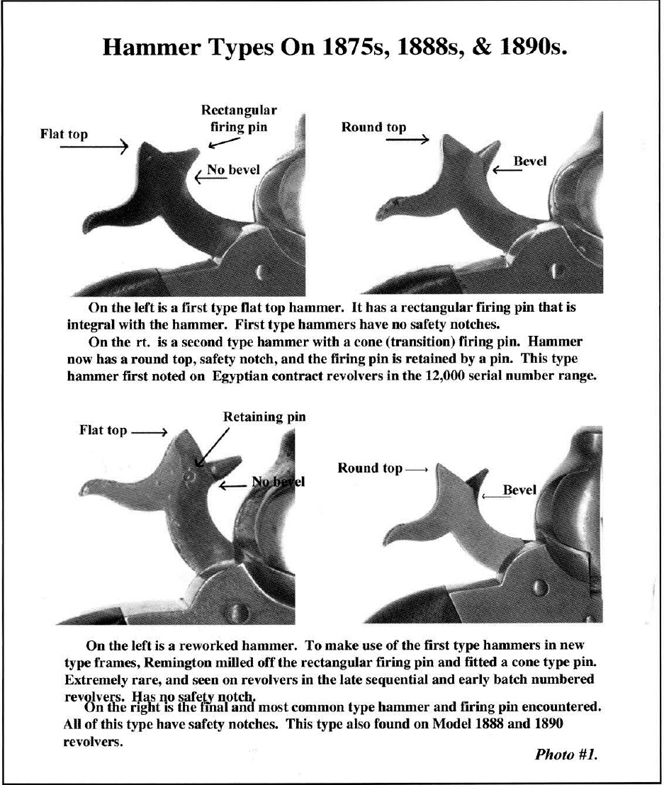

Photo #l has three hammer types and three firing
pins found on the Model 1875s at different stages of
production. Each successive firing pin has a more pointed
nose1 so this progression was probably to eliminate
problems with
detonating primers.
The lack of a safety notch on the early hammers was also a
serious safety concern.
The first hammer and firing pin changes occurred
during the Egyptian contract deliveries, so these may have
been responses to the inspector’s complaints

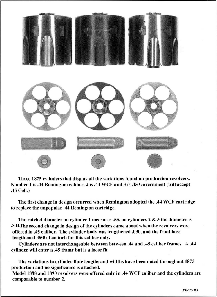

On photo #3, the pictures and captions are also self explanatory,
with the possible exception of the length of the .45 caliber cylinders.
This was probably another safety issue. The longer length
prevented a .45 caliber cylinder from being installed in a .44
caliber frame, thus preventing a possible disaster.

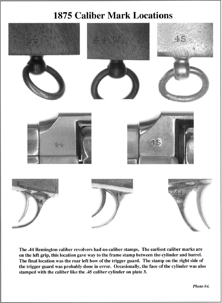

Photo #4 has the caliber marks and their locations at
different periods of production. Caliber marks on the grips are
first seen in the late sequential serial numbered revolvers
Page 20 1st Quarter 2004
Page 21 1st Quarter 2004
Page 22 1st Quarter 2004
Page 23 1st Quarter 2004
Page 24 1st Quarter 2004
and this location was also used on early batch numbered revolvers. The
frame location was used until alter the adoption of the blade sight.
The trigger guard location was in use in 1883, when revolvers were
ordered by the U. S. Interior Department for use by the Indian police
on reservations.

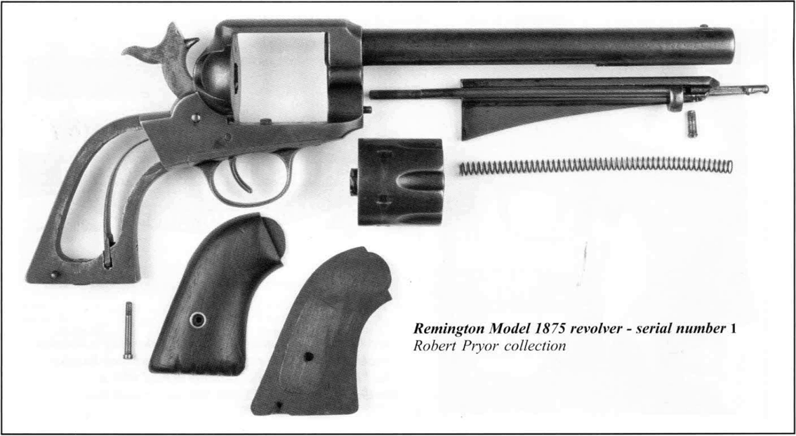

Photo #5 is also self explanatory, but some further discussion of
serial numbers Seems warranted. I have a very early production
revolver, serial number 36. The serial number appears on the frame,
barrel, ejector housing, trigger guard, hammer, rear of cylinder,
loading gate, and even on the flat of the ejector rod. It is logical
to assume that the first revolvers off the production line needed
some hand fitting and therefore the need to identify the various
components of an individual revolver. As the milling and machining
techniques improved, interchangeable parts became the norm and
serial numbers were used only on the frame, trigger guard, and
loading gate.

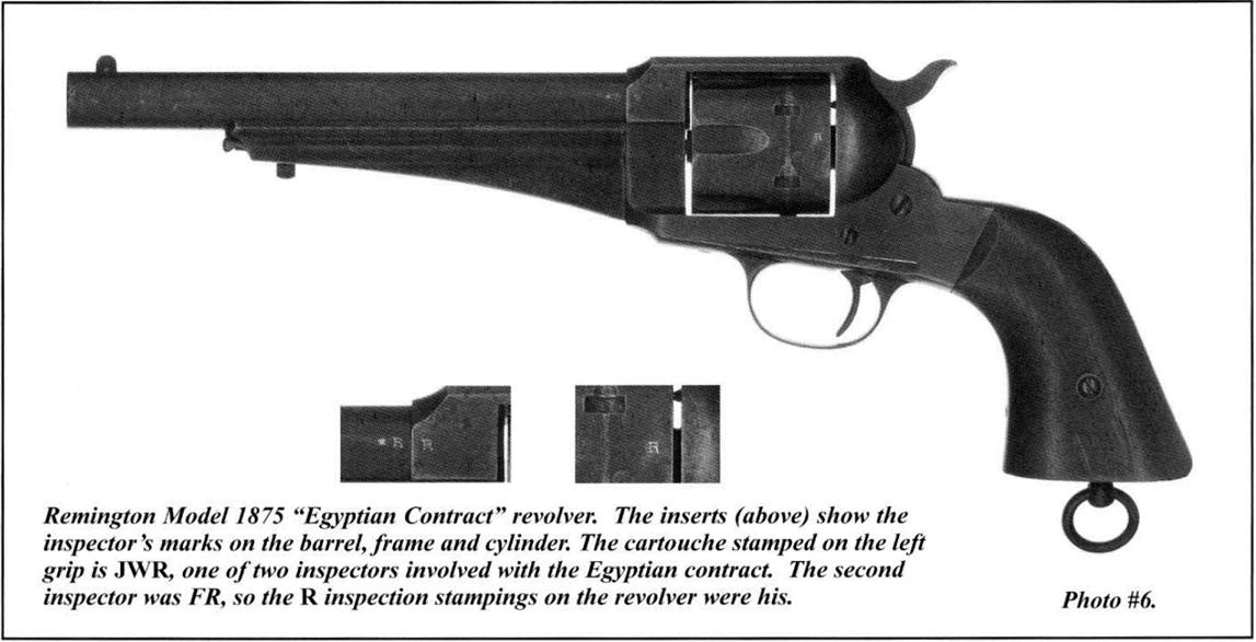

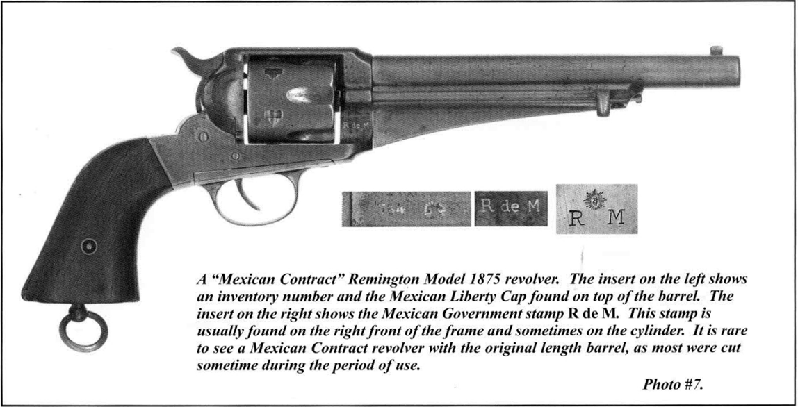

Photo #6 depicts an Egyptian contract revolver
which l have already discussed to some extent. These were
originally furnished in blue finish. I have examined some
specimens that have all the inspector’s stamps except for
the cartouche on the left grip. These appear to be revolvers
that either failed to pass final inspection or, passed the
inspection and were not delivered because of the defaults
in payments by the Egyptian Government. Many of these
were later reworked to .45 caliber and sold to the Mexican
Government. Others were Sold on the commercial market in
both the original .44 Remington caliber and .45 Government
caliber
Photo #7 shows a Mexican Government .45 caliber
Model 1875. These are reworked .44 Remington caliber
revolvers that E. Remington & Sons’ Armory had in
inventory when the Mexican Government ordered revolvers
for the Mexican Army. The chain of events leading to the
reworking of these revolvers is uncertain. A question
remains: did Remington alter the arms after receiving the
Mexican order, or had the revolvers already been altered for
commercial sales? A clue to the answer may lie in the fact
that Mexican contract arms were delivered in both blue and
nickle fmish, probably because Remington already had the
arms ready for delivery when they received the order, and
did not have enough of either blue or nickle to Complete the
entire order with the same finish. The answer to this
question will probably elude us forever, but Remington saw
an opportunity to dispose of several hundred “white
elephants” without a lot of extra expense. The bullet
diameter of the .44 Remington cartridge was only about .003
smaller than the bullet diameter of the .45 Government
cartridge. This allowed the alteration without any modification
of the barrels except for reducing length at the breech
end. A new, slightly longer cylinder was made (see photo
#3), and the forward end of the cylinder cavity in the frame
was milled to accept the cylinder. The frame was beveled
and the frame guide for the ejector rod was recessed as
shown on photo #2. The ejector rod was also shortened
slightly to conform to the new frame and cylinder dimen-
sions. The new cylinders were stamped with an L on the
face, which I surmise to stand for “long cylinder”. This
contrasts with later production, most of which were
Stamped with 45. When these revolvers were reworked by
Remington, the major components were numbered during
disassembly, to ensure that these parts were reassembled
Correctly, and this number was usually also stamped on the
face of the new cylinder. The caliber mark 45 was also
stamped on the left grip of these revolvers, but one is
seldom seen with this mark intact. Prolonged usage has
almost always obliterated any trace 0f this stamp.
The number of revolvers ordered by the Mexican
Government has never been determined (one confirmed
source states 500), and even the date of the order is
uncertain. I would guess about 1878 or 1879. The Mexican
Government stamps on these revolvers are not consistent.
All have the “Liberty Cap”, and most have the R de M,
marks, but this mark is sometimes stamped on both cylinder
and frame, while others have been noted only 0n the frame.
One specimen examined is missing the “R de M” stamp.
There are numbers stamped on top of the barrel tothe rear
of the Liberty Cap mark. Some have numbers stamped on
the bottom of the frame just to the rear of the ejector
housing. Crude Roman numerals cut with a Small chisel
have been observed on various parts of some revolvers
indicating possible assembly numbers by a Mexican
almorer.

A few remarks about Remington’s production
practices may help to enlighten the reader. I noted that the
new type hammers and cone firing pins are first seen in the
12000 Serial number range of Egyptian contract revolvers,
and that the change may have been at the insistence of
inspectors. Remington continued to use the old parts in
new production made for the general market until the parts
were exhausted.. Remington continued this practice
throughout production. This has created some confusion
when trying to classify a later variation revolver that retains
early production parts. Another example are the trigger
guards and triggers. We the old type and the new type
used concurrently well into the batch numbered revolvers
